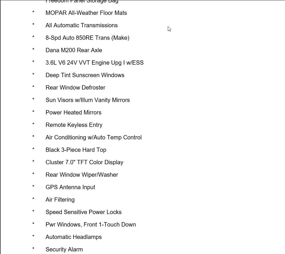

I'll preface this by saying it's probably just me, not the documents but I'm having some trouble figuring out which axle I have in the rear of my 2018 JLU. I've read through several other threads and I'm still a little lost. Attached will be the 3 documents I've read. When I use the vin decoder it says I have the M200 rear axle. The build sticker says a $2000 upgrade package with 8 speed auto, 3rd Gen Dana Solid Rear Axle, Hill Descent Control, and Tip Start. And my pre-owned sticker (just bought) says Brake Actuated Limited Slip Differential.
Is there an axle upgrade that's $2K or was that upgrade on the auto transmission with descent control and the tip start? Any help is appreciated as I'm trying to plan out my build. TIA!

@ElvisJL
You have M200 (D35)
Optioning in Anti-Spin Differential (which you did not) upgrades it to M220 (D44)
Having a manual transmission also gets you M220 (which you did not)
