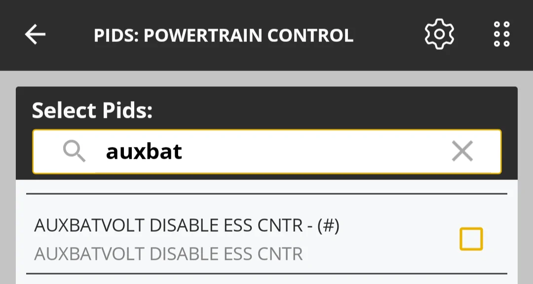

The 6 ESS event limit after bypassing the AUX (ESS) battery and PCR is a verified fact; it's been duplicated by a forum vendor specializing in JL electrical/battery accessories (who discussed the limit with a contact at Jeep).
It's also evident in JScan
Jeep Wrangler JL Auxiliary Battery Elimination 1000005397
