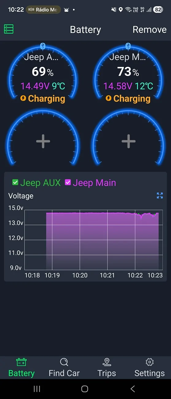

Ok to be precise. My battery monitor see two batteries, their temperature, voltage and status. Sometime only main battery is charging as I said till nearly full and then system start to charge also aux. But in most of the time they are charged simulatenously. The gap in the graf of main battery time/voltage showing Start/stop working.

Thanks for the reply. The only time the 2 batteries are not connected together during operations is a stop/start event. In that case, the engine is not running and the alternator is not charging. As far as I know, the charging system does not have a way to differentiate between the 2 batteries for testing. I believe the differences you are seeing on your test come from the differences in the batteries, or from your test set up, or both. I’ve been wrong plenty of times so I would be open to any documentation and discussion regarding your test.

After replacing both batteries 6 months ago, I monitor the charge level and charging of both batteries every time I drive and I can say that I can't say exactly how the system decides which battery to charge when. Sometimes it charges both simultaneously, sometimes the system prioritizes charging only the main battery up to almost 99% and only then starts charging the auxiliary battery.
Sometimes system charge only main battery.
JL's can't and don't individually control AUX (ESS) battery charging.
It's possible for the batteries to accept charge at different relative rates for a particular system voltage and alternator output (especially if there's an actual battery temperature difference as great as the ones suggested in your photos of the monitoring app). However, your monitoring system is almost certainly not tracking current or capacity, so most of the charging difference you're observing is likely a result of estimation error in the SoC percentage.
Out of curiosity, is the unit monitoring the AUX (ESS) battery mounted on the AUX (ESS) battery?
