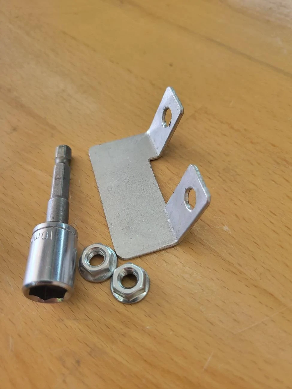

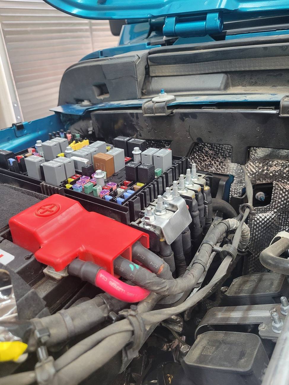

There are certainly several ways to successfully eliminate the aux battery, but when my warranty is up and I do that fix, I will use a jumper from N1 to N3, so the original factory setup of N1 having a 150a fuse back to the main battery remains.
Even though my warranty is good for another 2 1/2 years, I built a jumper to keep in the jeep for future use.
Jeep Wrangler JL Aux Battery Cables 20250701_145839
It is made of 14g aluminum, plenty of current carrying capacity, won't rust, and fits with the fuse box lid on. The two nuts allow me to put it in place on top of the originals.

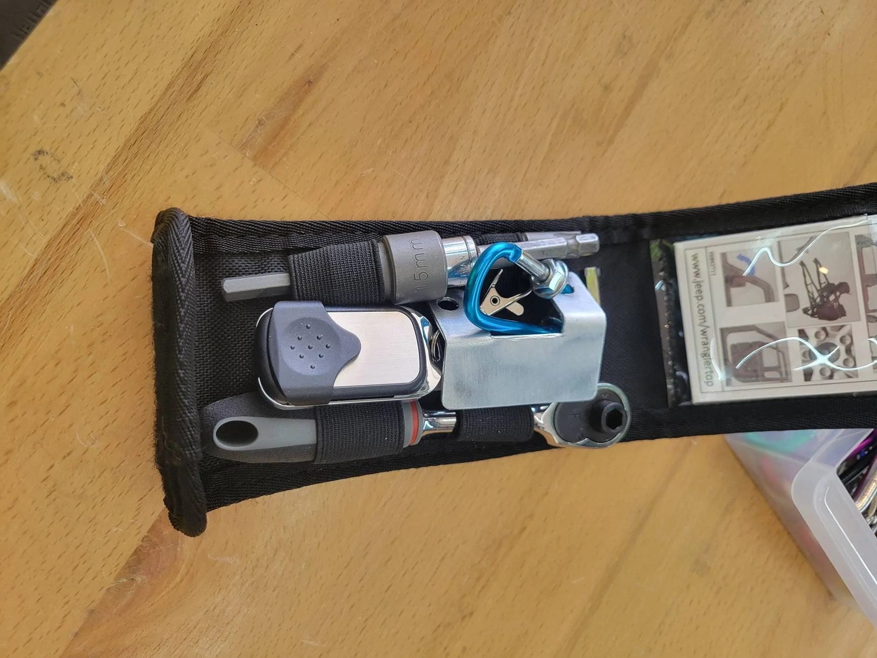

I threw in a 10mm socket and adapter to fit the factory ratchet, and it all fits in the factory tool kit.
Jeep Wrangler JL Aux Battery Cables 20250701_150139
I will use the jumper, remove all the aux battery cables, box, etc., and keep F42 in place so ESS can still work if I hit my head and think it is a good idea for some reason.
I already have an ESS module thingy that turns ESS off every time the Jeep starts (10 second removal if needed), so my aux battery is there just to avoid any warranty issues.
