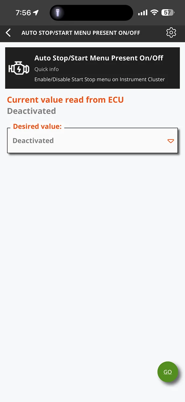

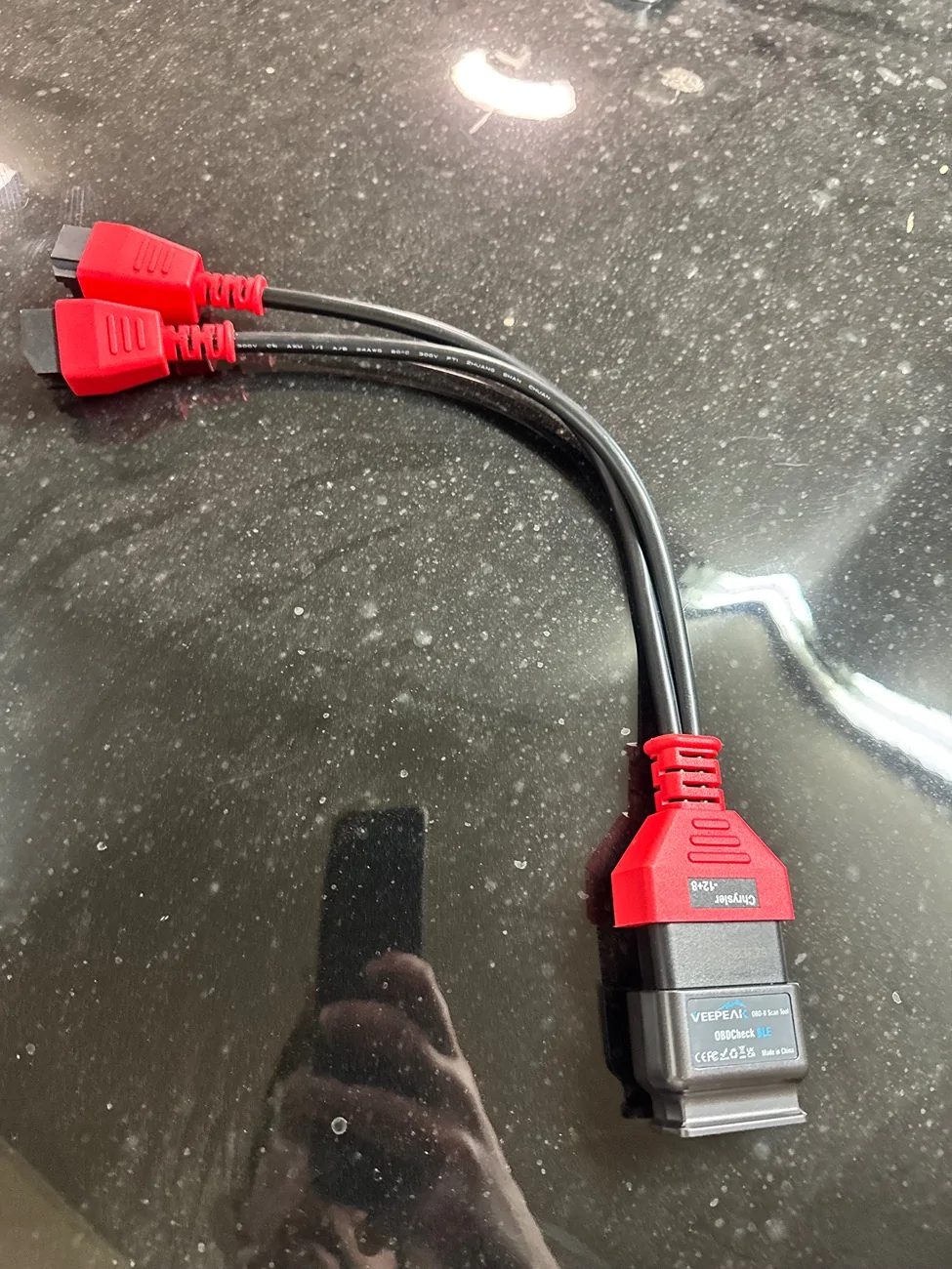

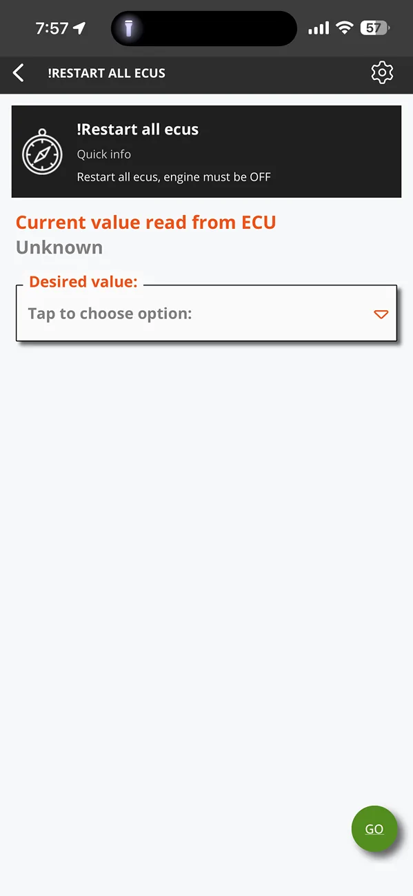

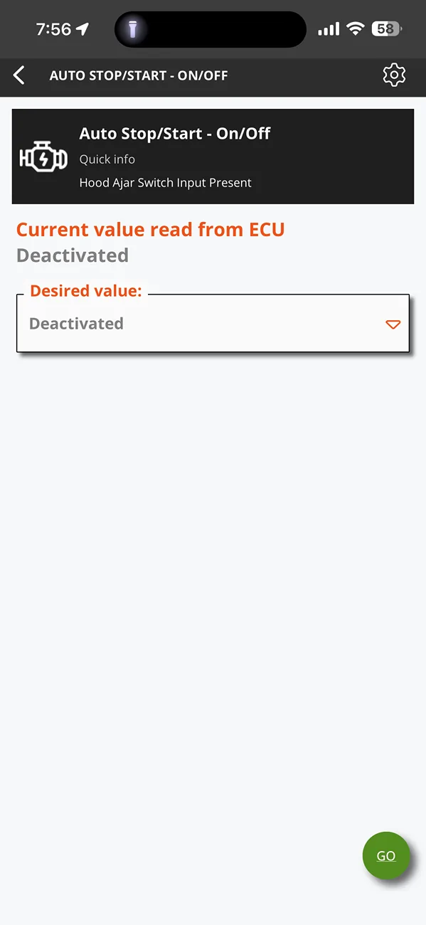

I’ve had some issues, previous owner removed the aux battery the F 42 fuse and still causing the jeep to come to a ESS stop when the button is not pressed. I went into J scans and deactivated all the settings. However it is still functioning. I ended up just doing the hood plunger/switch method for now.
