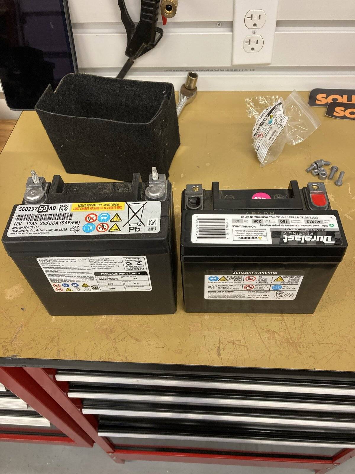

Oh and autozone didn’t know or didn’t want to be accountable for any misinformation regarding the battery, aux14 or aux12. I end up going with aux 12 since the factory battery is 12 volts also.
Notice the autozone is smaller and made in China hoping it last me 3 years

Just know that an Aux 12 and an Aux 14 are both 12v batteries.
The numbers after the word "Aux" have nothing to do with the voltage of the battery.
When buying an Aux battery for your JL/JLU/JT you want to buy an Aux 14 battery and not an Aux 12 battery.

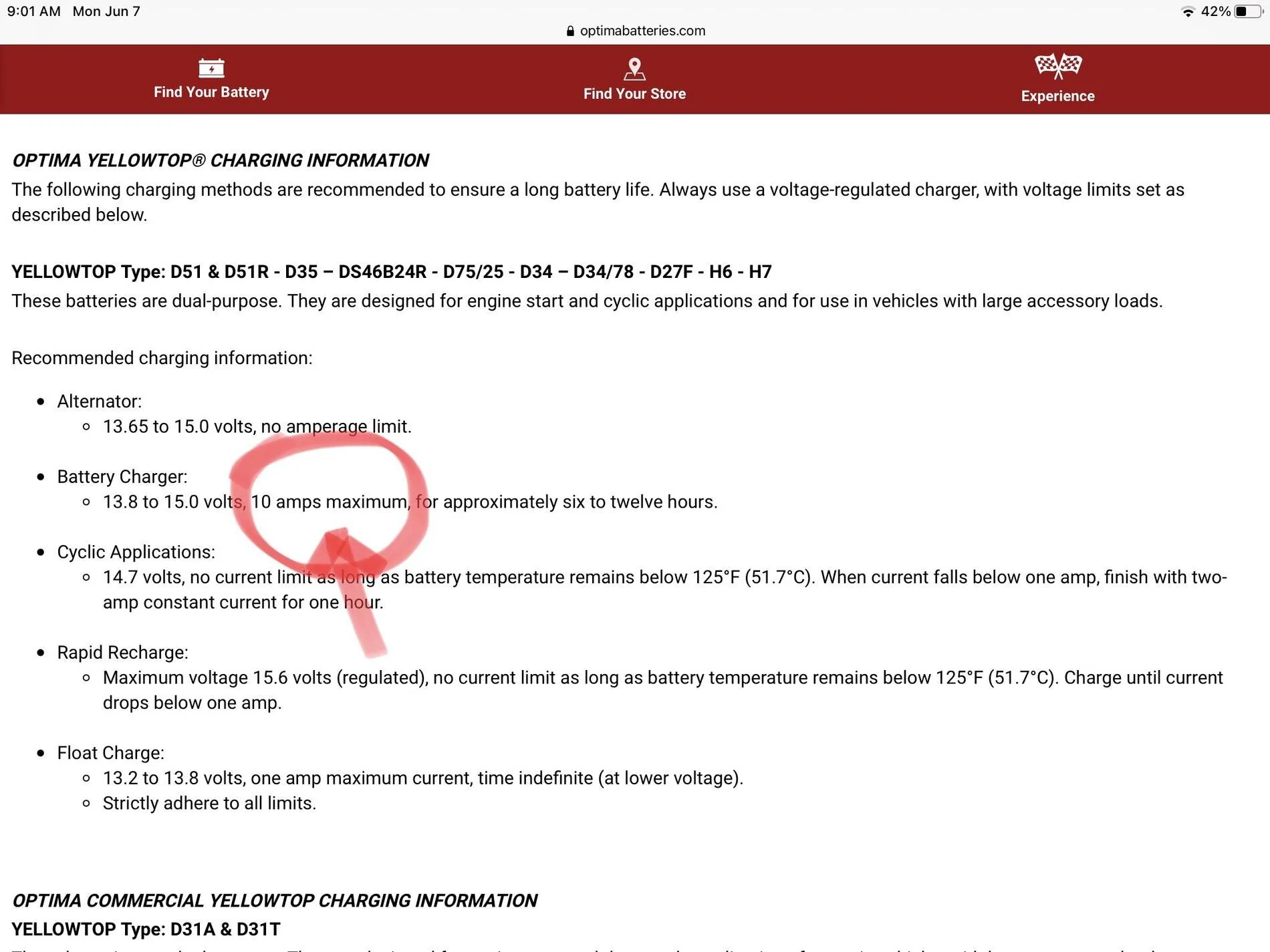

@MtCamper i just looked at Optima info and seems all their group 25 batteries are pretty much the same for charging but they seem to be firm on charging amps of a max of 10 amp so I would contact them to confirm and if they say yes I would use a NOCO 10 as its a great smart charger and falls within their guidlines.
When you talk with them confirm with them that you are using these batteries in a dual setup where the batteries are connected as one over 99% of the time and if say these are 70 Ah batteries that would be 140 total amps so you may be able to run a higher amp rating especially since these newer smart chargers like CTEK, Odyssey, NOCO all have built in programs that monitor key components of a battery to determine the best charge to apply but in the end I would go with what they suggest.

you are correct, I looked at other pictures online and it’s a 14 amp hour batteryAUX14 vs a 12 amp hour AUX12 I should have gotten the bigger battery.

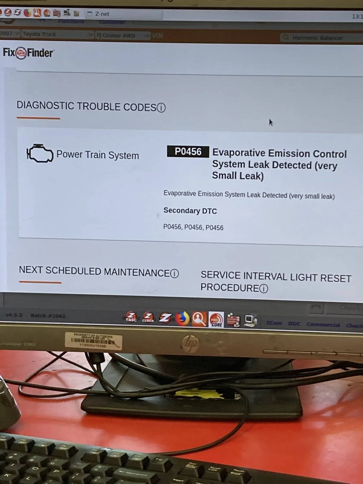

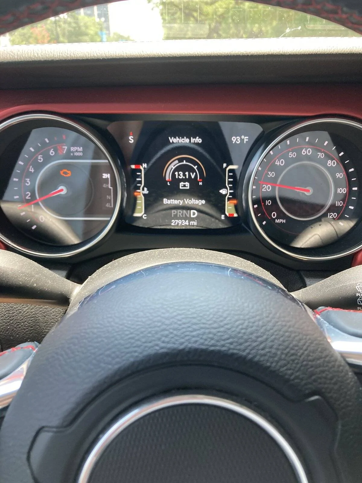

After two days the ESS worked normal again. Exactly one week after two new battery install, the voltage is 13-13.5 and sometimes it jumps to 14 for a second while driving and back to 13.2 ish. Then today the CHECK ENGINE alight popped up, went to auto zone and they told me to check my gas cap. Code was P0456
after the check engine light test I went back inside and asked them to check my alternator. It FAILED, so Monday morning I will have to take off work, deal with service department and see if they even will get me a rental Bc I need this Jeep 7 days a week

@Jeep1969 I’m not sure how they test the alternator but if it was tested on the vehicle it’s a hit or miss on it being bad, the alternator runs regardless but it’s the IBS that dictates what charge to throw at the battery so a good test would be disconnect the IBS sensor and then with a meter check the running voltage on the main crank battery, with the IBS disconnected it should be read 14+ volts and when you shut the Jeep off it would then read resting voltage.
These Jeeps use a smart charging system and the IBS monitors the voltage and then tells the alternator how much charge, this by design is supposed to give you increased HP, save gas and confuse us as owners looking at the EVIC voltage display show something different all the time ?
