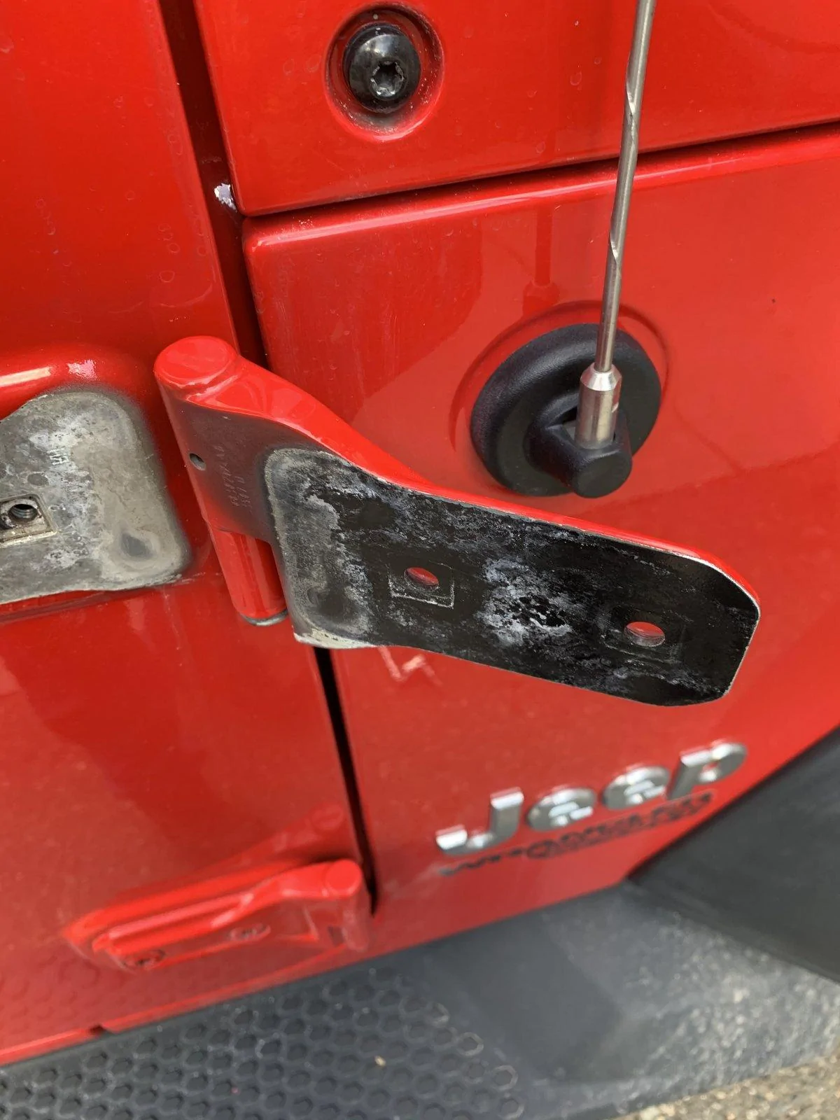

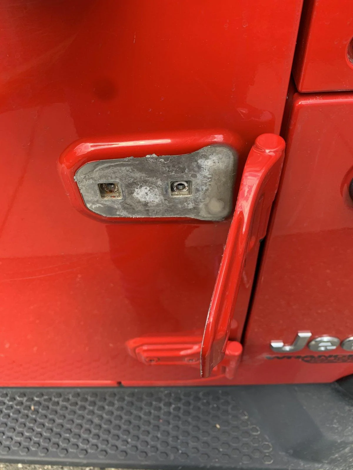

Has waste process engineering
I have a hard time believing it's already starting to corrode. Looks more like a defect in the paint.
It’s corrosion. Mine just had two doors repainted under warranty
Jeep Wrangler JL Are you concerned about galvanic corrosion? 61CFB540-3A6B-4B93-A4F3-FBECAE6C0A71
Jerolife
Jeremy
Oct 13, 2018
Delta
2018 Jeep jl sport
I should also clarify my post to say that if you're attempting a repair, I'd recommend unbolting the hinge so that the paint or lack thereof probably underneath the hinge could be sanded and repainted, instead of just sanding and painting the hinge as is.
If I had to hazard a guess on what happened: during assembly, the hinge is probably already attached to the door and then painted over, so its anyone's guess whats underneath or more likely that there are contaminates trapped underneath the hinge, such as solution/acid left over from the passivation bath process or something. Then because its a recessed area and the hinge is never removed prior to painting for alignment reasons, whatever's there is now stuck underneath the paint.
If one hinge is unbolted/repaired at a time, you can probably avoid having to realign the door afterwards, but whomever is doing warranty work will probably not care either way.
