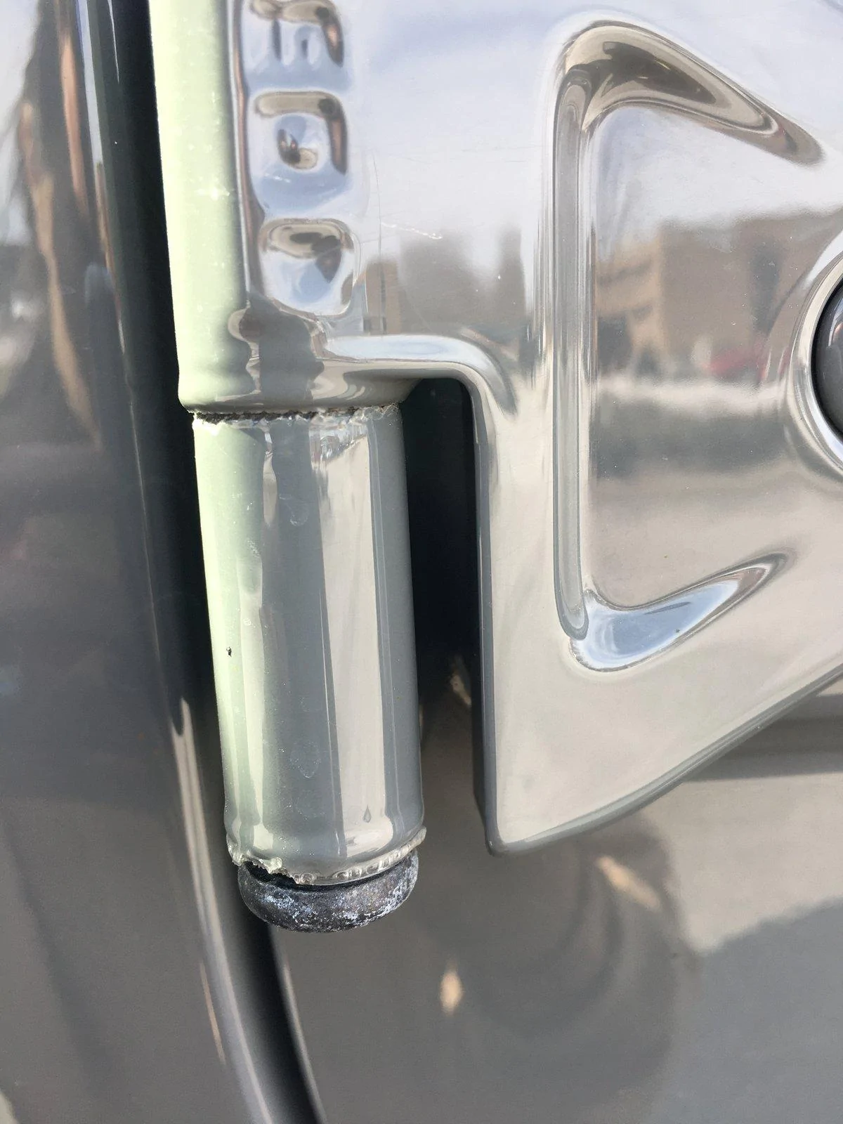

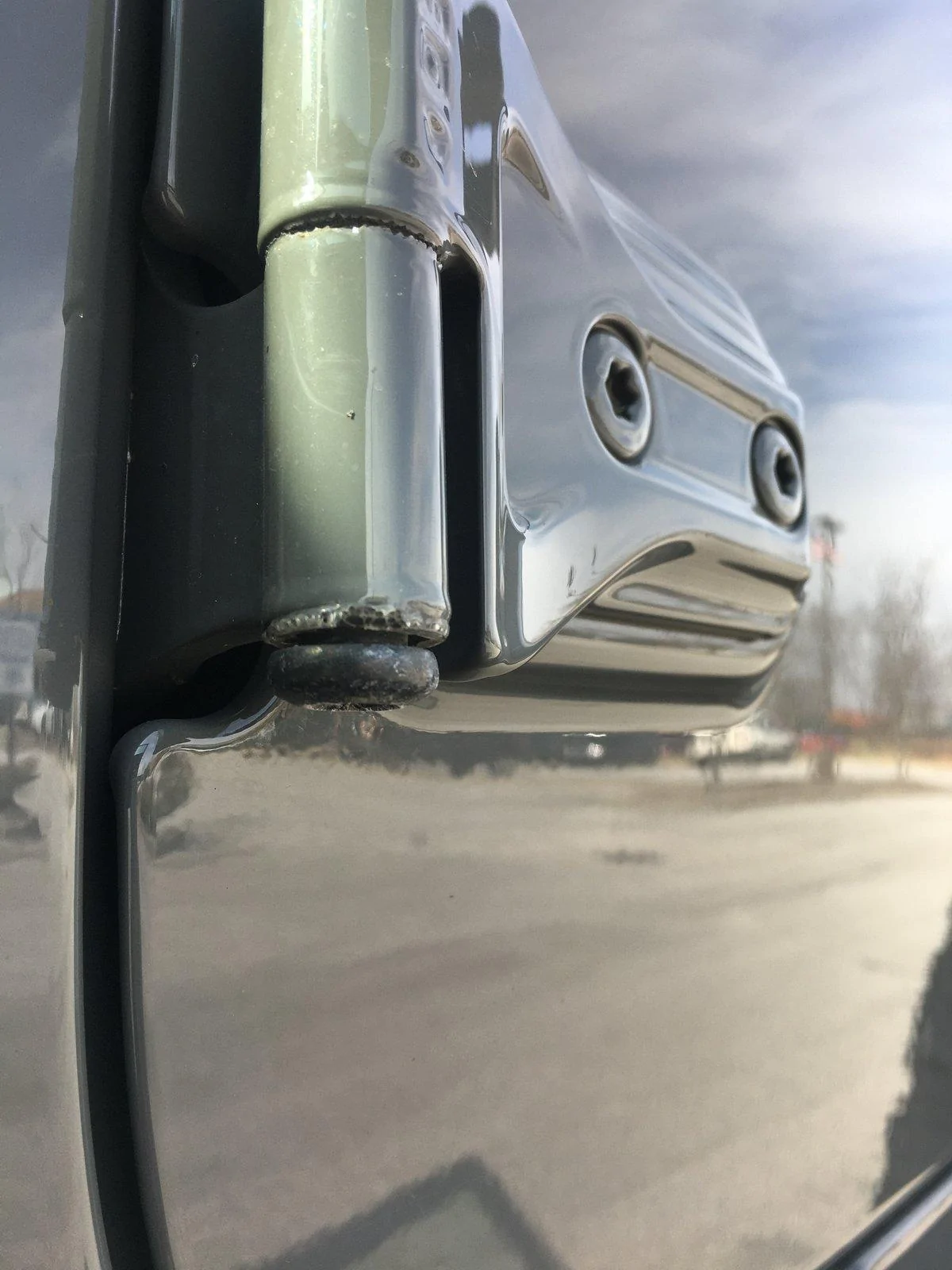

Mine are all corroding like the above photos. I have to talk to the dealer and see if they will even do anything. You’d think Jeep would figure this crap out. Absolute BS to have these issues on a $40K vehicle.
i know, I'd expect it on a $39K vehicle but not $40K.

I have it going on. I have a 2019 jlu moab edition. All four doors hinges are starting. Dealer started the process but never got back to me so now I have to take it back in. What a headache....
Jeep Wrangler JL Are you concerned about galvanic corrosion? 1A414AB8-D5EE-4EBF-9BCC-91BCF4620F80
Jeep Wrangler JL Are you concerned about galvanic corrosion? B97F6E68-B612-46AE-859C-778AA55A4E2F
