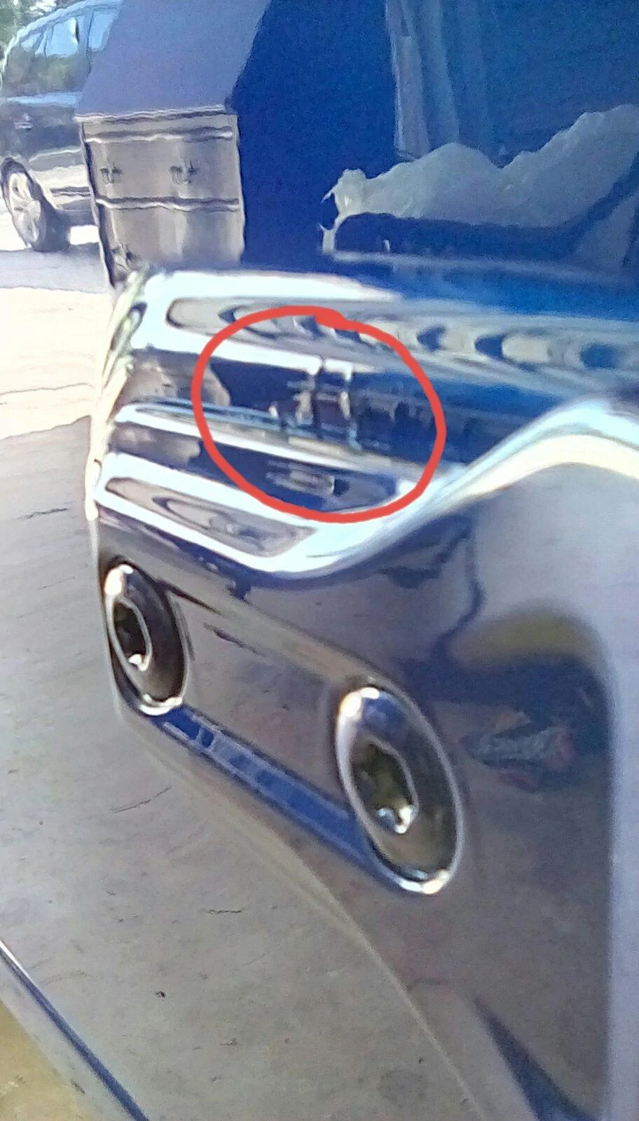

I'm more than concerned. this is happening on all of the hinge brackets
I have a hard time believing it's already starting to corrode. Looks more like a defect in the paint.
No this is just happening. I wash it weekly and it wasn't always there. that picture isn't even the worst one. I'm going to the dealership tomorrow. I don't really want them to repaint the doors because they are aluminum. I also had a ceramic coating done, so that's ruined too.

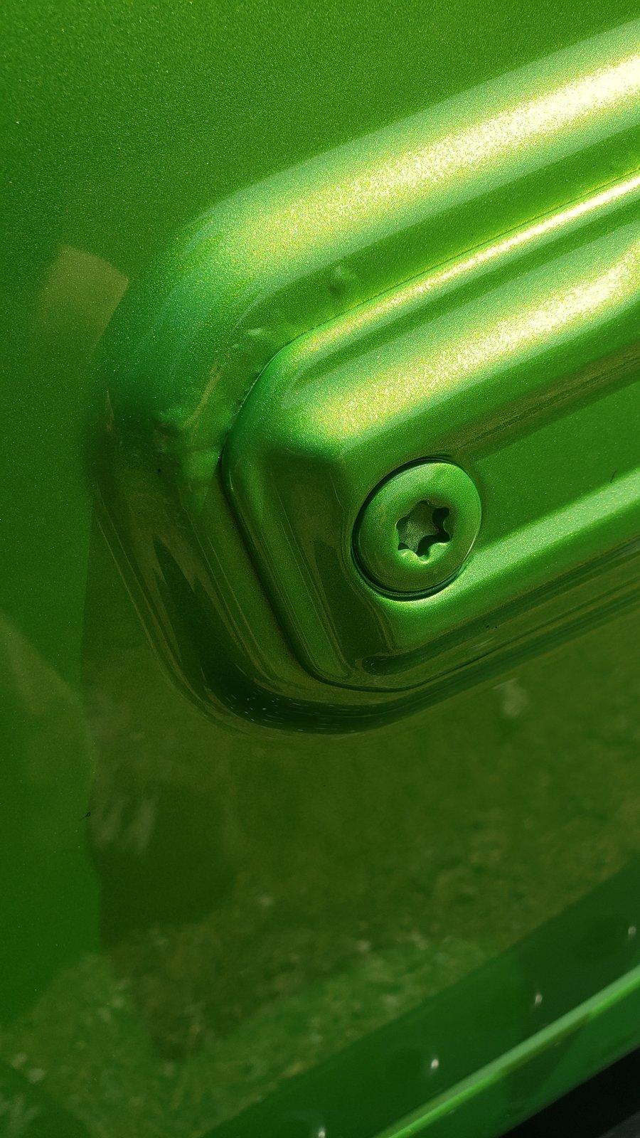

I also have the paint bubbling in my doors/hinges and will have it addressed at my next service.

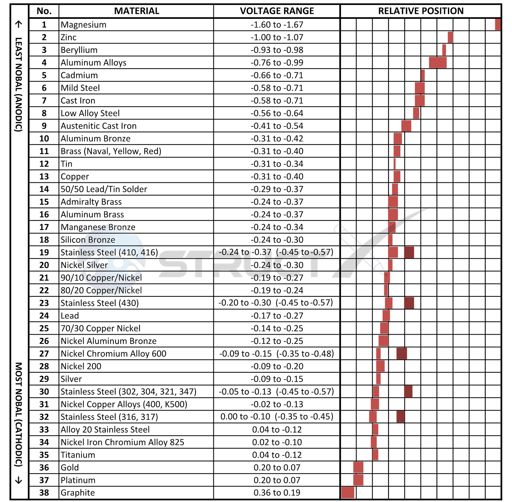

eries_of_Common_Metals_Scale_of_Nobility_Cathodic_Anodic_Reactance_of_Metals_Corrosion_of_Metals.png
I'm not sure that if stainless fasteners were used that it'll help the aluminum in this case... Automotive sheetmetal manufactured out of aluminum usually goes through some sort of alodine dip process, and this actually looks like a failure of the alodine dip process that is then causing some sort of reaction with the primer layer of paint. Aluminum doesn't really expand or become porous or produce an offgassing byproduct when its oxidizing when compared against steel where when oxidizing (rusting) it'll expand and become somewhat porous.
Dec 2, 2019
TX
JT
I should also clarify my post to say that if you're attempting a repair, I'd recommend unbolting the hinge so that the paint or lack thereof probably underneath the hinge could be sanded and repainted, instead of just sanding and painting the hinge as is.
If I had to hazard a guess on what happened: during assembly, the hinge is probably already attached to the door and then painted over, so its anyone's guess whats underneath or more likely that there are contaminates trapped underneath the hinge, such as solution/acid left over from the passivation bath process or something. Then because its a recessed area and the hinge is never removed prior to painting for alignment reasons, whatever's there is now stuck underneath the paint.
If one hinge is unbolted/repaired at a time, you can probably avoid having to realign the door afterwards, but whomever is doing warranty work will probably not care either way.
