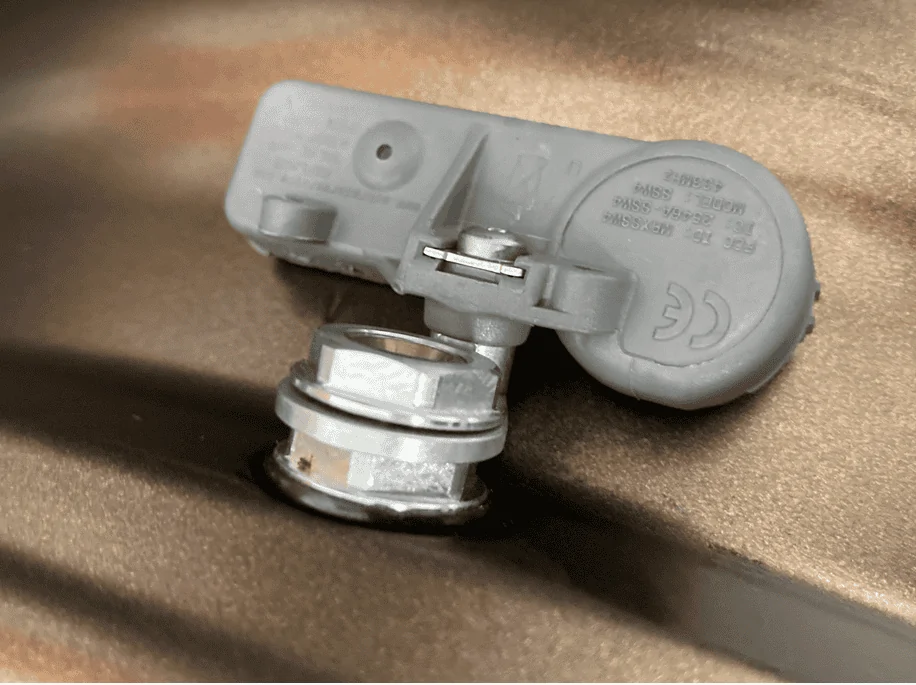

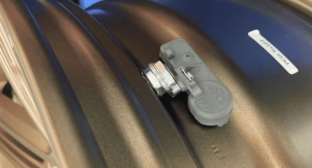

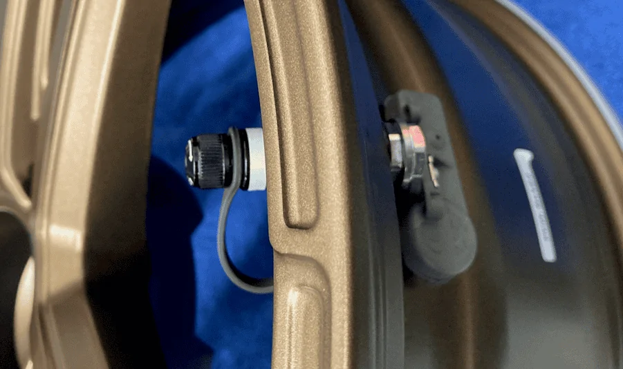

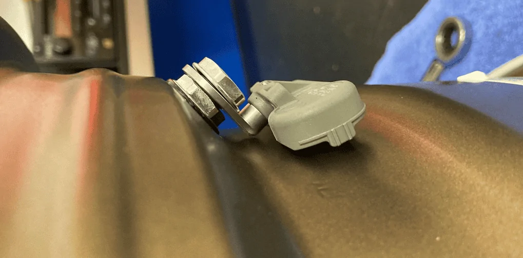

I have had them on since the Jeep was new in late April.
I had 1 of them that did not seal to the wheel well. I had to break to the bead and reseal it, but that may have been my fault the way I assembled.
First off these are awesome. I air down every weekend to 10lbs for dune running, often more than once in a weekend, often more than once.
Speed of air down is astonishing. Build quality is amazing. Really functional and unique.
They have functioned flawlessly since late April until now.
Here is the "negatives".
On the wheels I chose, the combination of the factory TPMS sensor, and the Apex bracket to hold it, didn't line up nicely. It puts a side load on the valve stem, which is probably why I had to redo one. That isn't a fault of Apex, with 1000s of wheel styles and sizes it would be impossible.
The second is that again, with my wheels, the tires just barely clear the sensors without hitting them upon install of the tire on the wheel.
