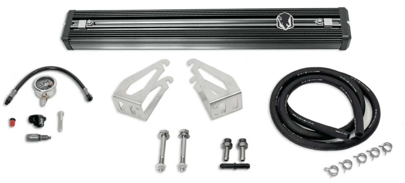

There's a thread about it here: https://www.jlwranglerforums.com/forum/threads/anybody-tried-the-apex-steering-boost-kit.69239/ I'm pretty close to pulling the trigger myself.
Thanks for the link!..
2019 LJUR made this comment ... " One of the reasons for doing the hydro assist is to take the load off of the steering box shaft so it doesnt start to leak at the bottom seal. This would not do that and so it will still be a problem with running large tires. " .... what is your take on that comment? .. Thanks!

I haven't heard of anyone having that problem with the JL steering box, but I think one of the several "sector sector braces" available would help mitigate that potential problem. I'm only going to 37's at this, I don't really want the expense and hassle of hydro unless I go to 40's in the future.

Yes, good point on the Sector braces.. I have seen the one from Synergy... it seems like a quality option... but.... $385 for the Apex kit + $250 for the Synergy kit... well... it gets you thinking... perhaps is better to get a full hydro assist kit (or at least buy in stages)...
There is also the alternative of porting your existing steering column like the Redneck Ram... also an affordable option...
