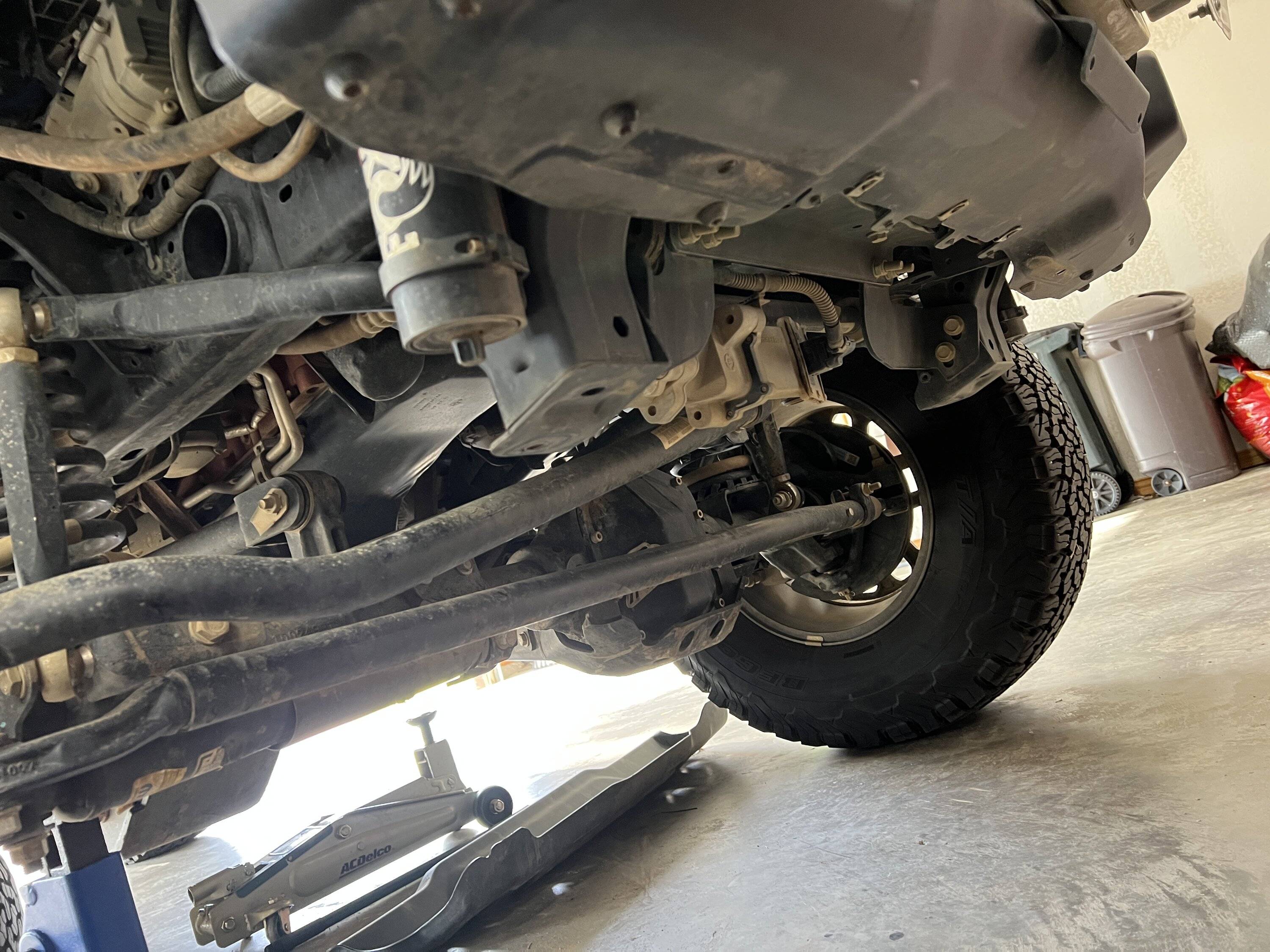

  • Support the passenger front axle and remove the front passenger tire
  • Remove the lower skid plate from the front bumper if you have one. This step can be done pretty much anytime, but you'll want it off eventually for the oil cooler install.

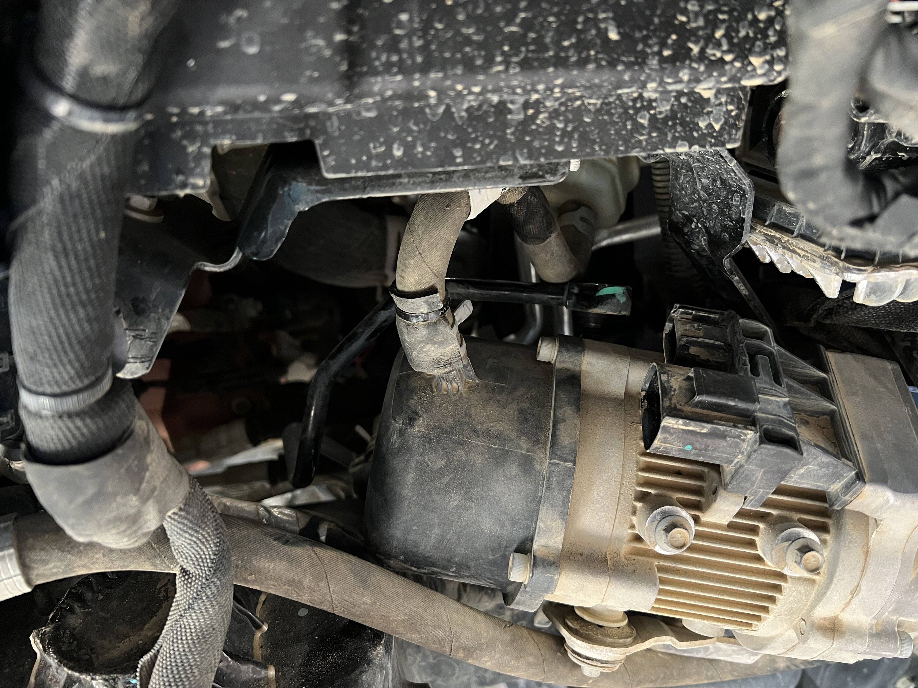

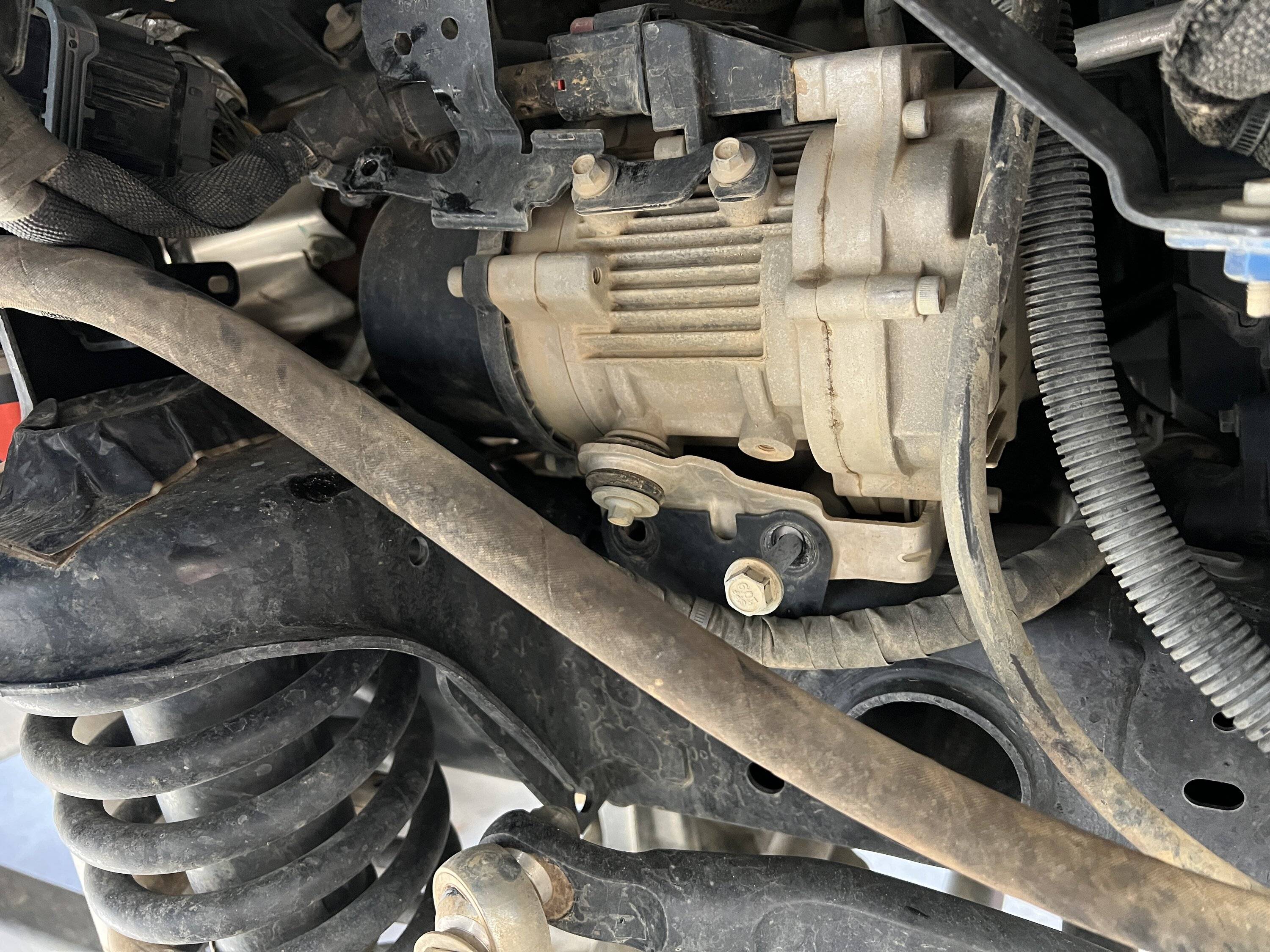

    • You can see the power steering pump mounted to the frame rail just in front of the coil spring bucket

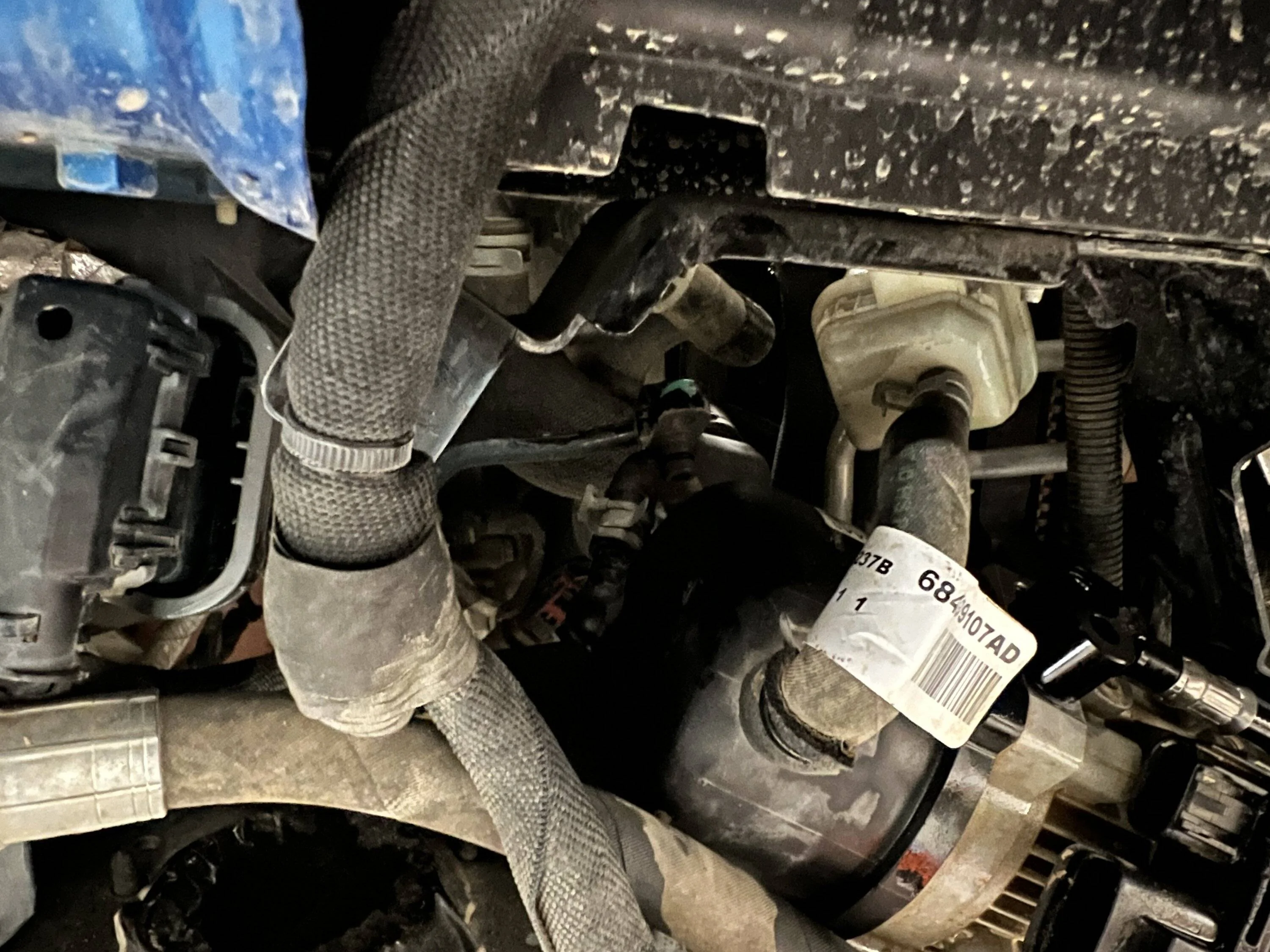

  • Unhook the power steering fluid reservoir.

  • Remove the two bolts holding the pump to the frame. One bolt is already out, and the second is halfway out below. The harness bracket mentioned in the bullet above is also visible here.

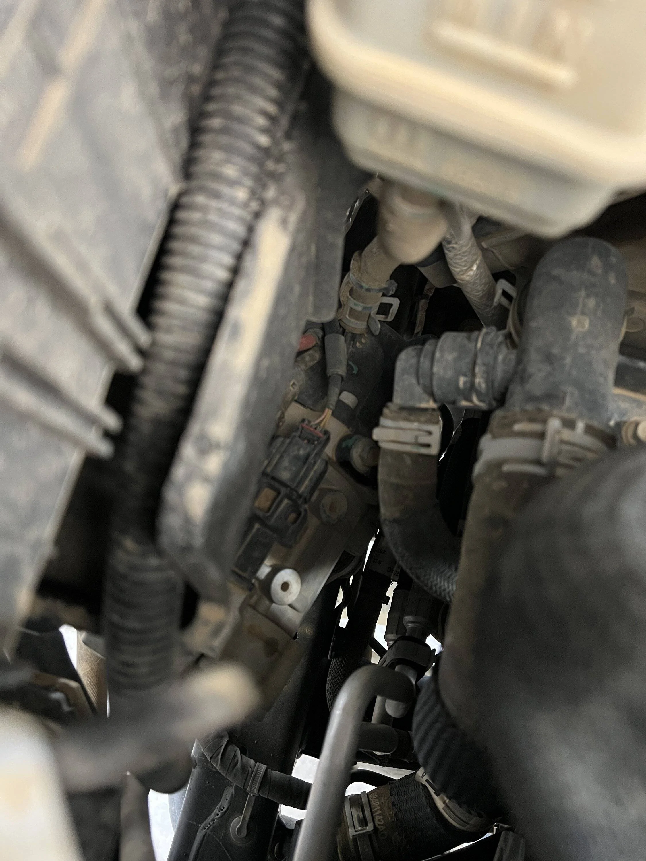

  • Push the power steering fluid reservoir down near the pump and rotate the pump out of its bracket and onto the frame rail. This position will give you access to the wiring connectors. Use a flat-bladed screwdriver to release the red locks and pry the connectors apart. Apex has a short video on this step that is worth the watch. Apex tips on wiring connectors

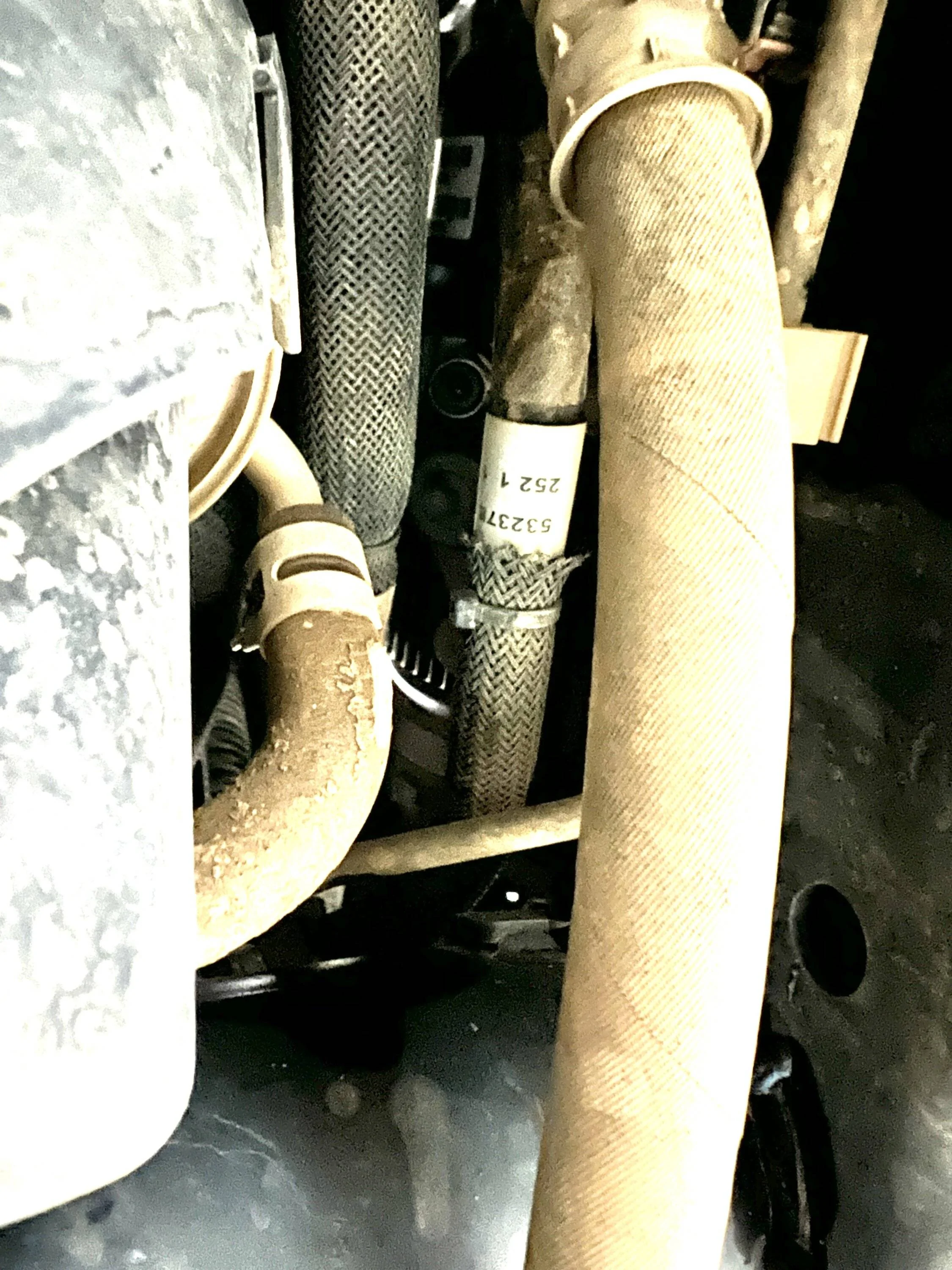

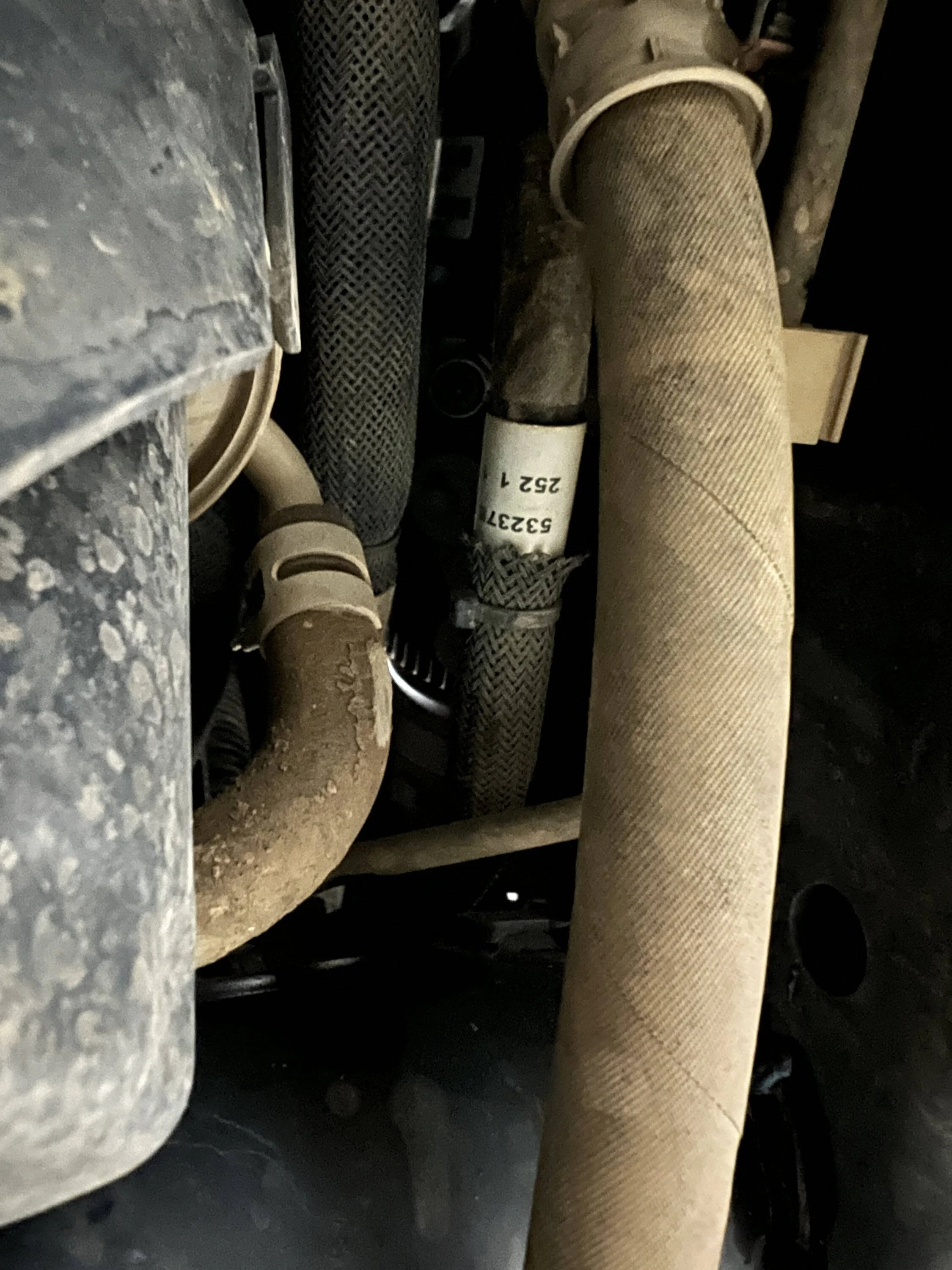

  • Remove the low-pressure hose from the back of the pump. Move the hose clamp away from the barb, and a flat-bladed screwdriver can help get the hose started up the barb. I used the supplied red cap to cover the low-pressure barb after the hose had been removed.

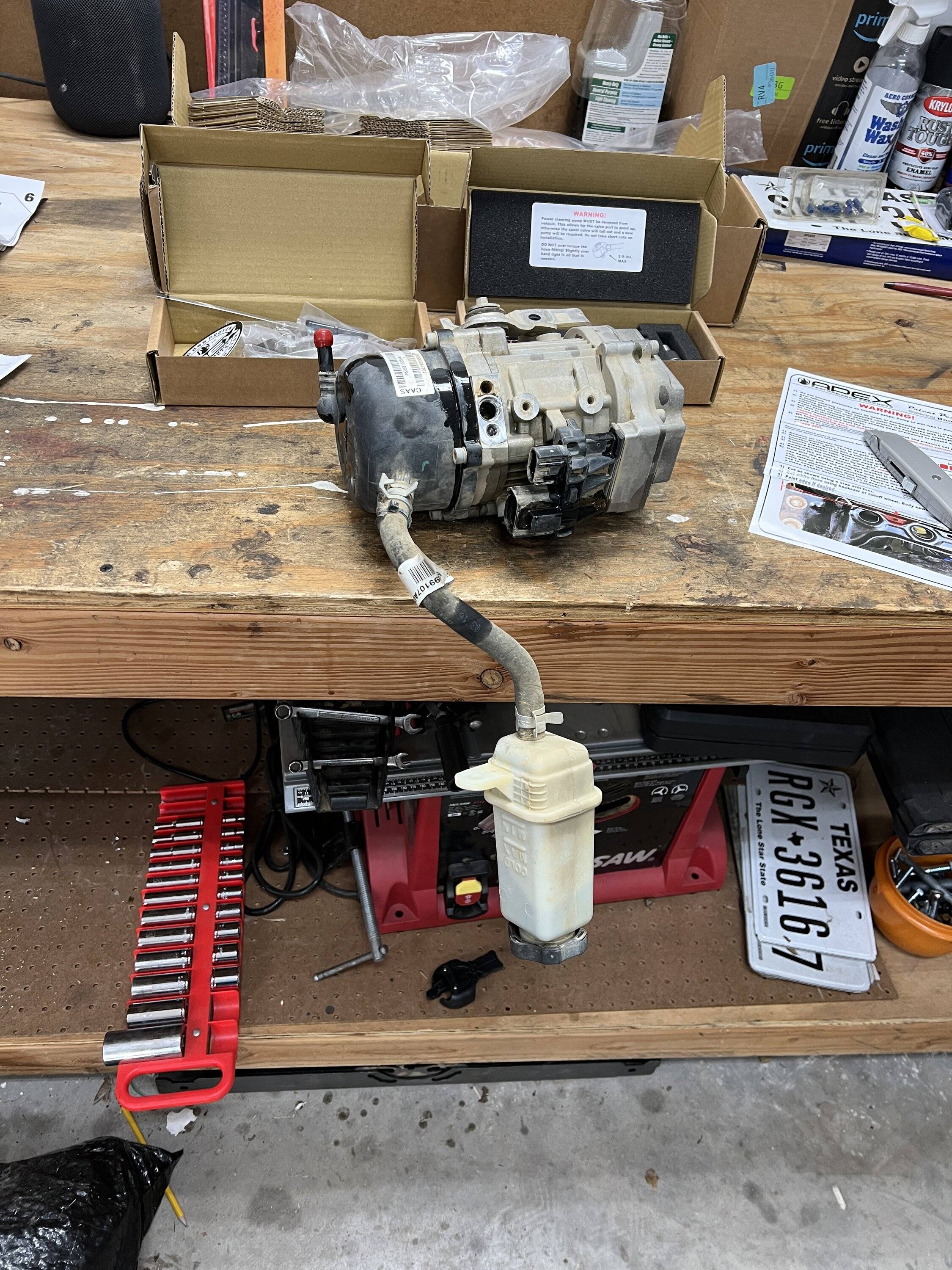

  • Remove the pump and clean it up a bit. Orient the pump so that the pressure spring is vertical and up. At this point is normal to have mixed feelings about ripping a perfectly fine power steering pump out of your $80,000 commuter vehicle. But don't worry; you're fully committed now anyway; just keep going.

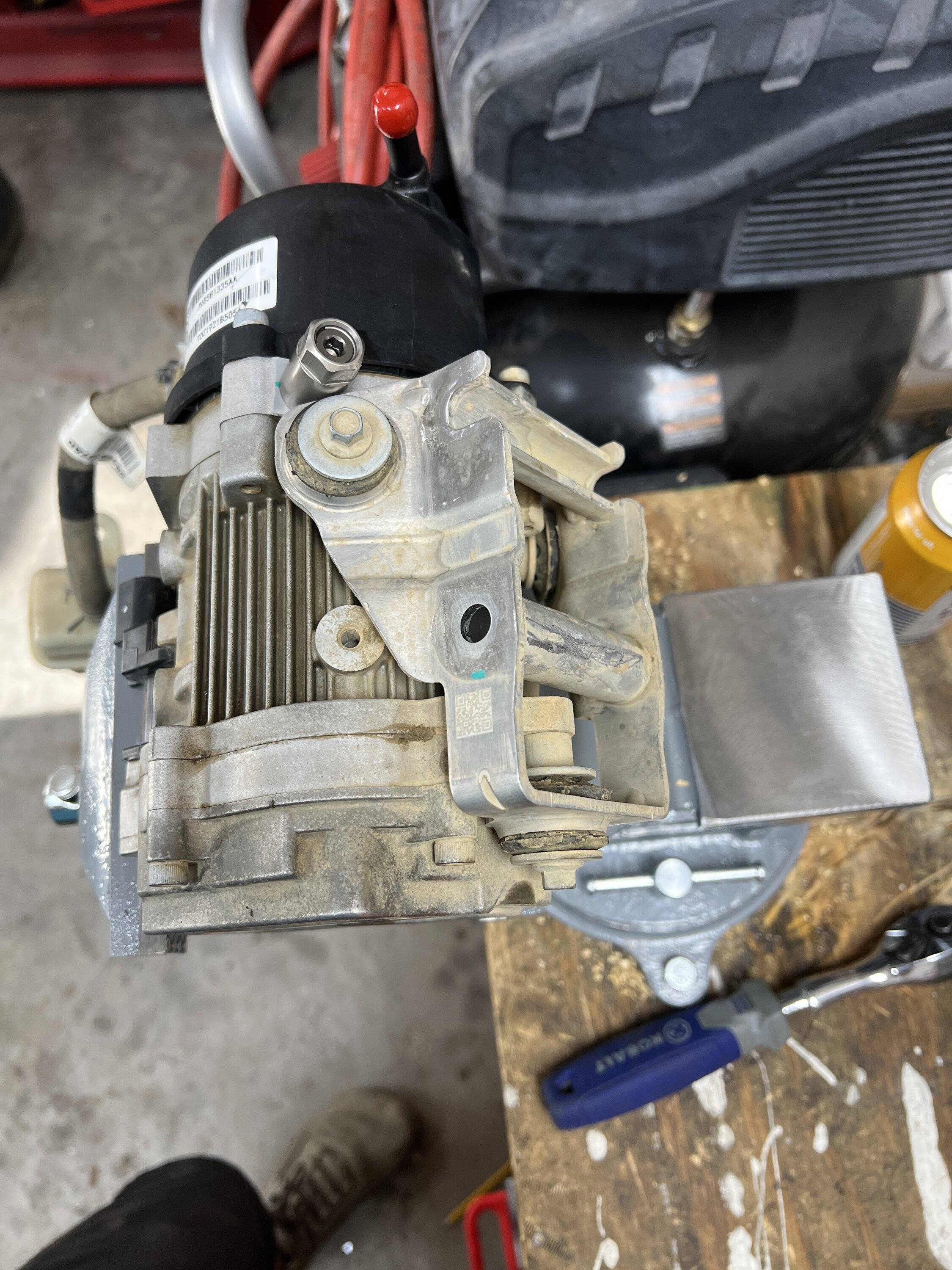

  • Install the Apex adjustable valve per their instructions. No need for me to rehash what they have put together. The valve has been installed below
