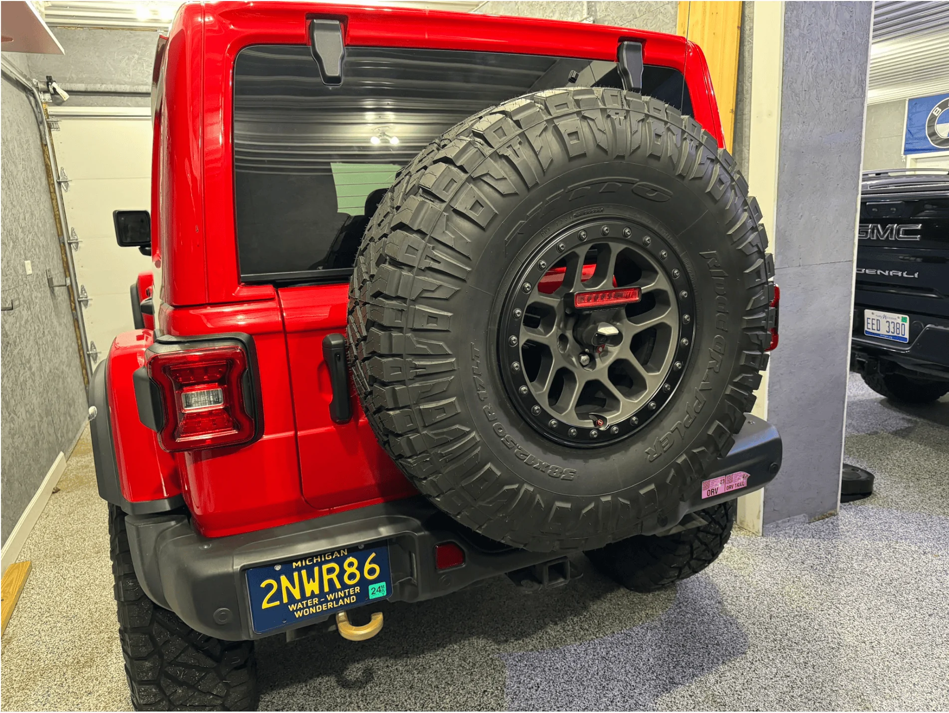

Buddy runs a 38” spare on his 392XR with the Mopar tailgate reinforcement.

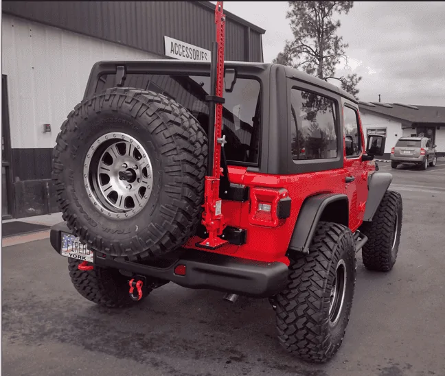

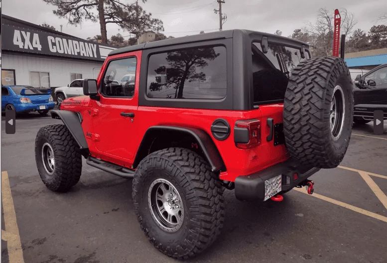

I just purchased my lift and headlocks along with 38 inch nitto’s. I don’t usually run a spare but I kind of want too however I’m not sure I can with out big this tire is .. I know I can do it with a Rusty’s Offroad tire carrier but I think it might get in the way or look stupid. Anyone have a spare they run that is that big?
Here is the Rusty's we have with 38's.

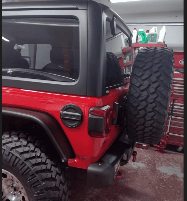

I ran a 38" spare for years with a Mopar tailgate reinforcement and Teraflex Alpha HD tire carrier. It fit perfectly with the Rubicon steel bumper. It's heavy and pretty much blocks all rear view but doable. I prefer a heavy spare on a bumper/frame mounted tire carrier but the matching rear Poison Spyder bumper has an integrated hitch but does not have a tow rating.
I changed my setup because I want to tow and the spare gets in my way.
