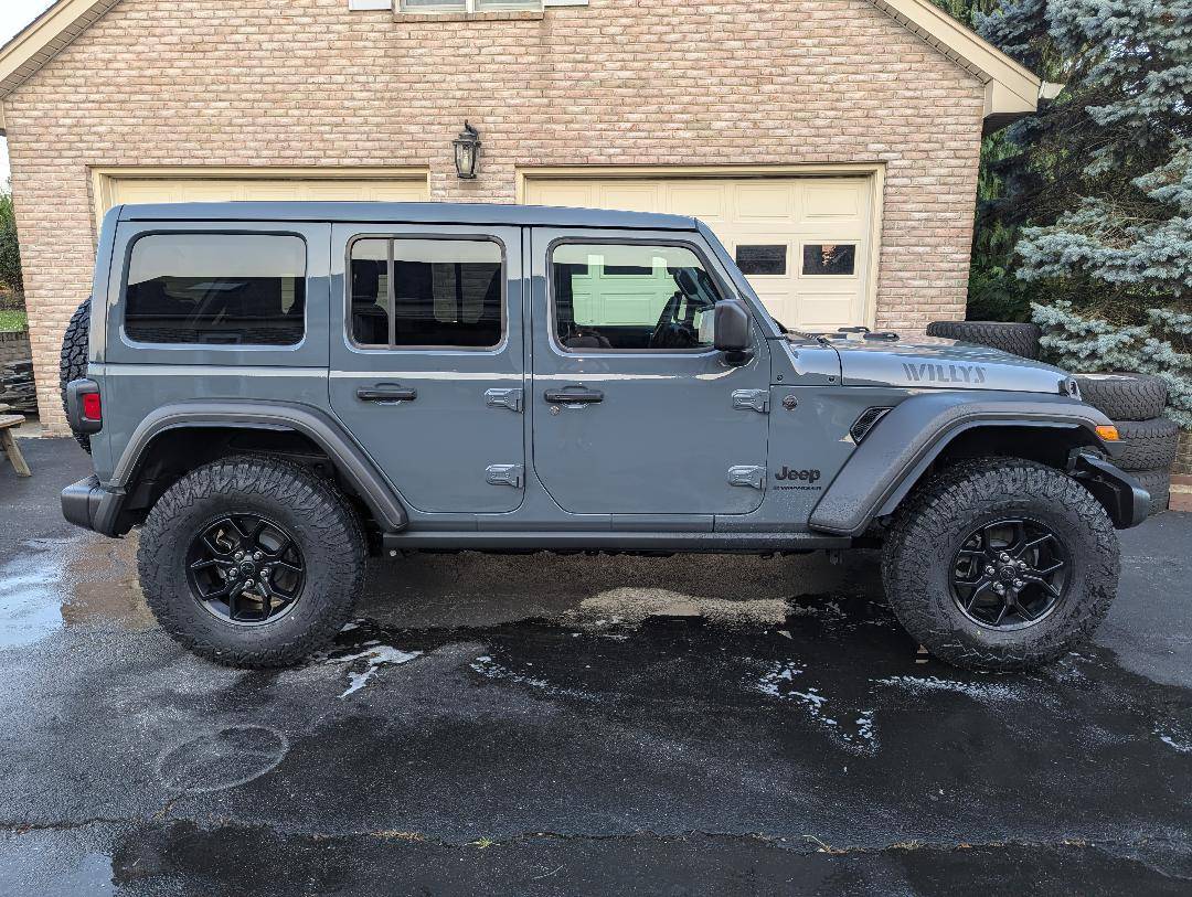

Thanks everyone,
Tires mounted and installed. It was pretty physical, but not difficult. Each one was faster and easier as it went along and I figured things out. I broke the tube for the bead breaker almost right away, so I used a floor jack to break the beads. I won't be paying for tire install anymore, at least until my body can't do the work, but at 54 it just felt like a good workout.
Jeep Wrangler JL Anyone mounting/balancing their own tires? tire off
Jeep Wrangler JL Anyone mounting/balancing their own tires? tires on
