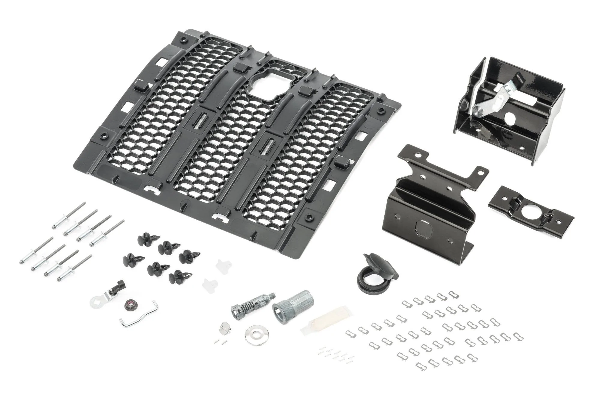

Just took delivery of my Sport S today. I ordered the Mopar hood lock (and gas cap lock) from allmoparparts.com a couple days ago. I knew it went where the front camera usually goes, and I knew my Jeep doesn't have that camera, so I thought it was going to be an easy install. However when I got my Jeep I realized I didn't have the cutout, so I took a look at the installation instructions online and now realize that I'm going to have to take the grill off to replace the middle insert of that mesh for the lock.
Has anyone done this? How hard/bad is the job? I've wrenched on my previous cars doing things like oil changes and spark plugs so I'm not new to this. Just having a bit of a double take with the thought of taking big parts off a Jeep that'll be at 200 miles max when the parts come in.

I haven’t installed the mopar hood lock but I installed the bolt one, and bolt makes the mopar one. Removing the grill is easy—just ask the Florida headlight thieves. Seriously though, if it’s like the bolt install, it’s like 30 min or less. If you can change oil, you should be able to do this.

It's almost completely disassembled. You have to put together the lock and put rivets in the housing. It took several hours, however, I had experience doing it on JKs before. For some reason MOPAR seems to have stopped offering an assembled, self-keying version.
When you pull off the grill, don't pull on the outer part of the grill itself, pull on the inner black plastic part. There's also a couple of tabs about half-way down the grill on the left and right that I remember being annoying.

Taking the grill off is not a problem. Raise the hood. Little plastic fasteners have to be taken out maybe 6. Then pull the grill out with a little force. Inserts are not hard to change

I installed it in July, maybe took an hour or less. I will say I re keyed locks for my half doors and the locking fuel cap so keying this was no big deal. There is a you tube video if I can find it I’ll post it but I found it in this forum. It’s super easy to install this hood lock.
