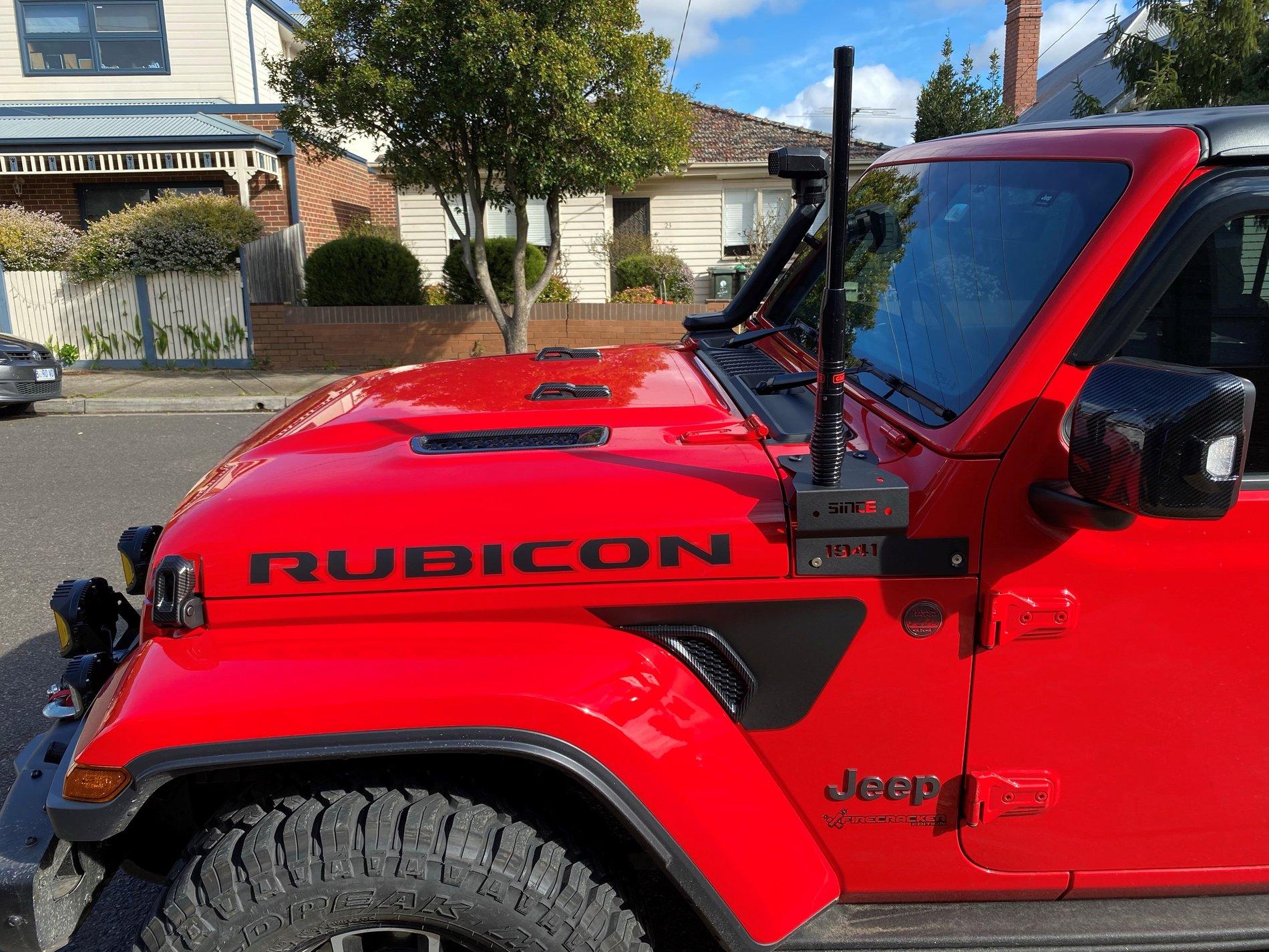

I installed my antenna on the passenger side crawl mount. the 2.2 dbi antenna also sticks out few CM as the tallest point of my Jeep, perfect for measuring those pesky carpark entrances! And for the head-unit, i installed it under the steering wheel column, i was surprised to find a "Perfect Match" space there to hide it.
The head unit also got a speaker, which is very handy to distribute the sound around the cabin.

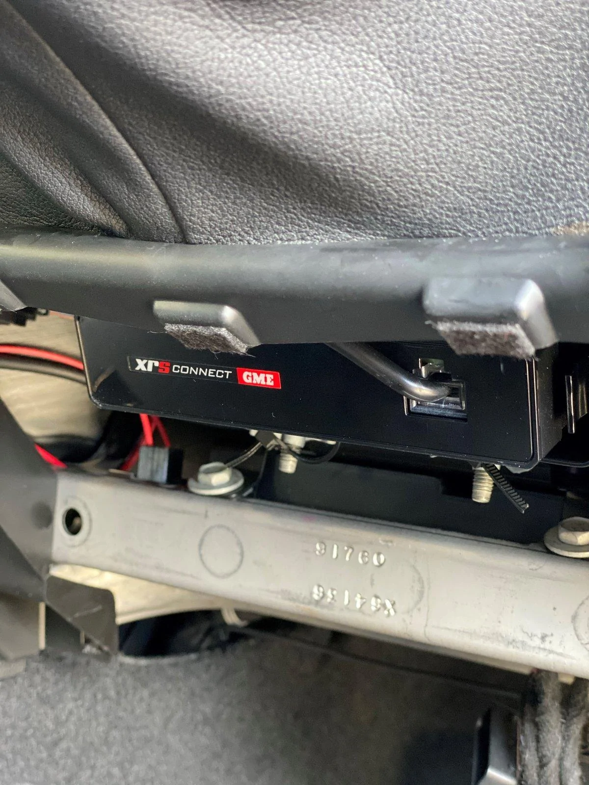

I mounted the actual CB unit under the passenger seat and the hand held radio part as posted above.

Thanks for the visuals guys. I'm liking the idea of mounting it under the seat for sound distribution
the gme xrs units have speakers in the main unit and the hand held device so you can get sound from both at the same time.
got a link to that mount? I'm not getting the best range mounted on the bar so want to move the antenna.
Have you tried adding an earth wire between bonnet and firewall? The bonnet is not earthed well through the hinges.
