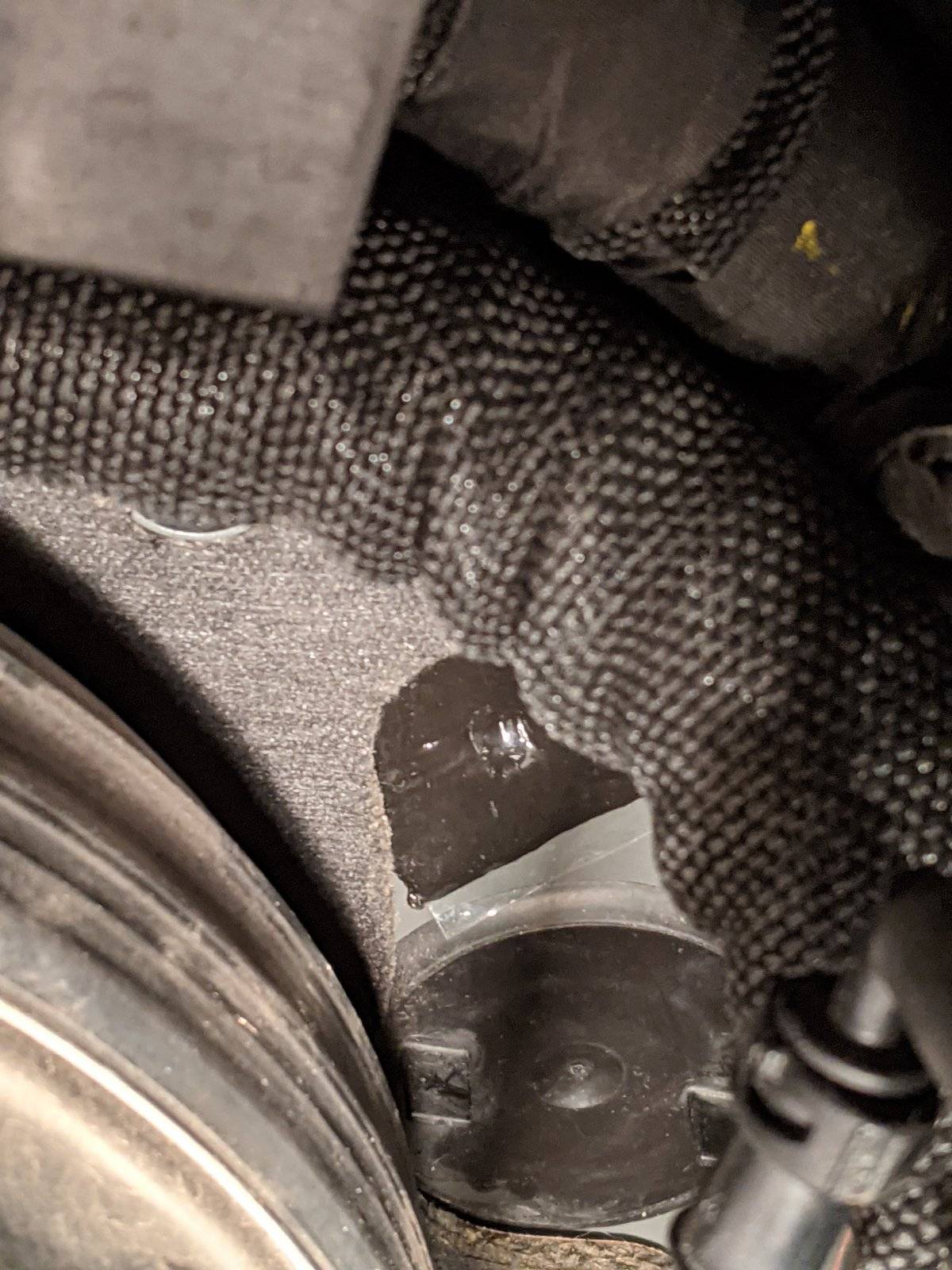

We're RHD in Australia so things are located differently. I think that plug is still there but not fun to get to.Of you have an automatic this picture shows a plastic area that can come out or drill through. It is on driver side. I drilled and used some caulk after pulling GMRS antenna wire to close gaps.
