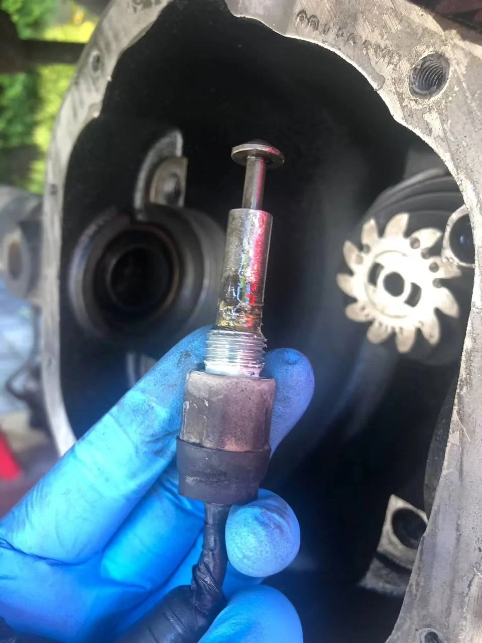

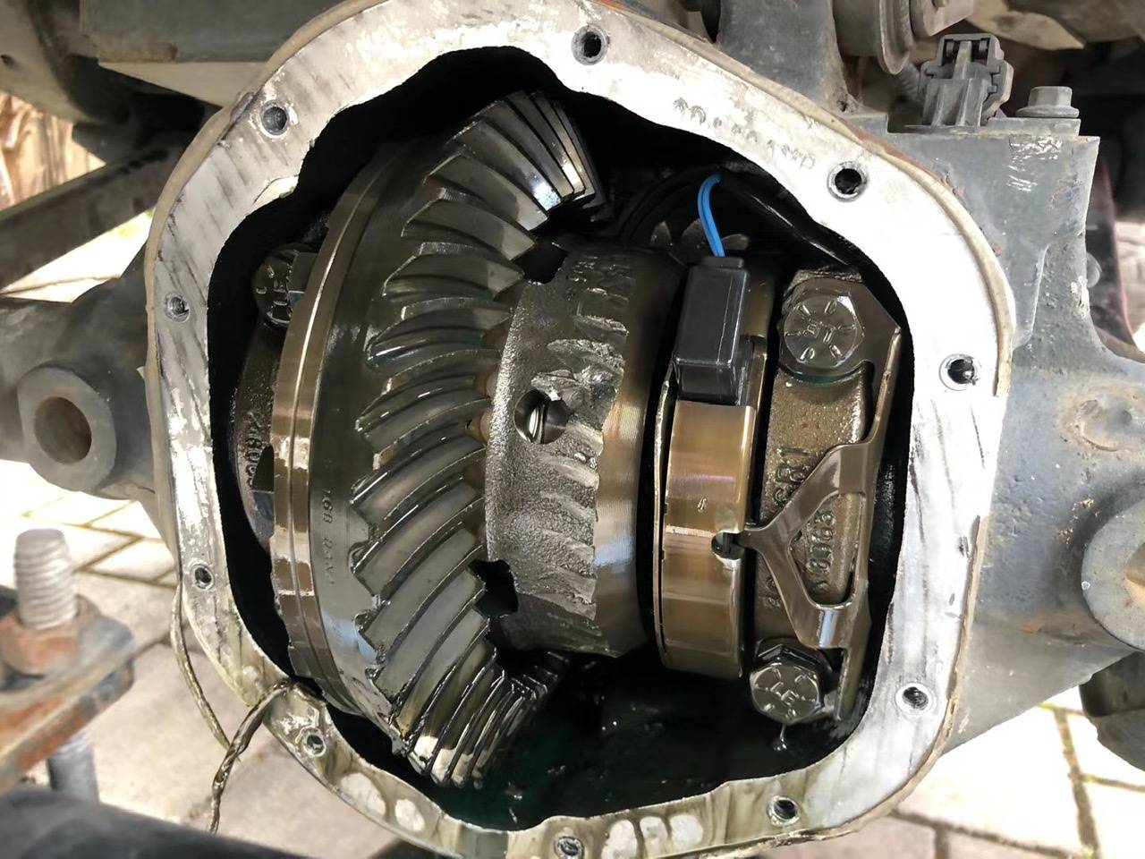

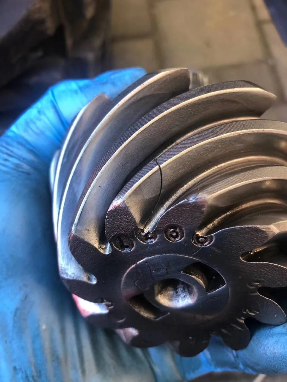

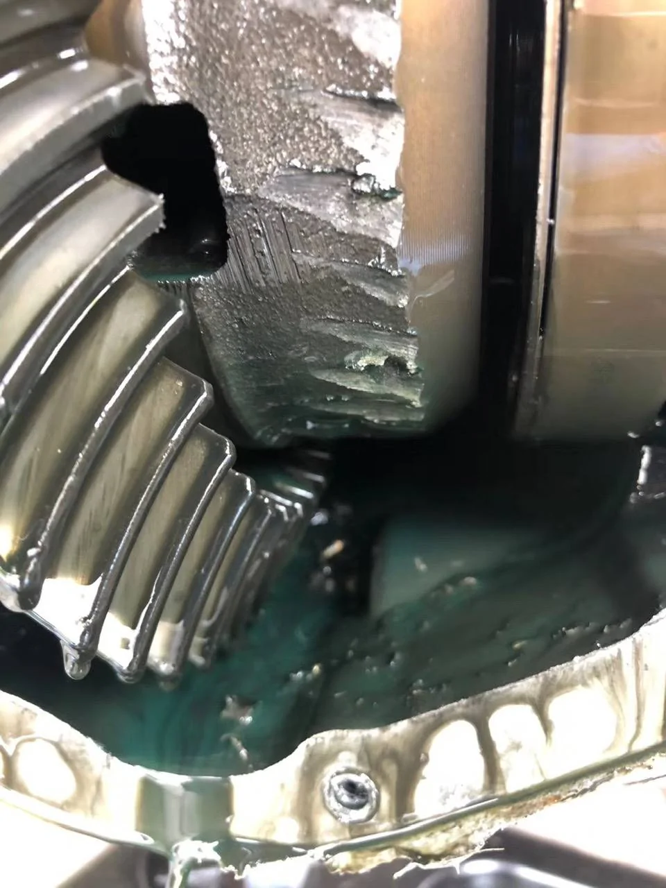

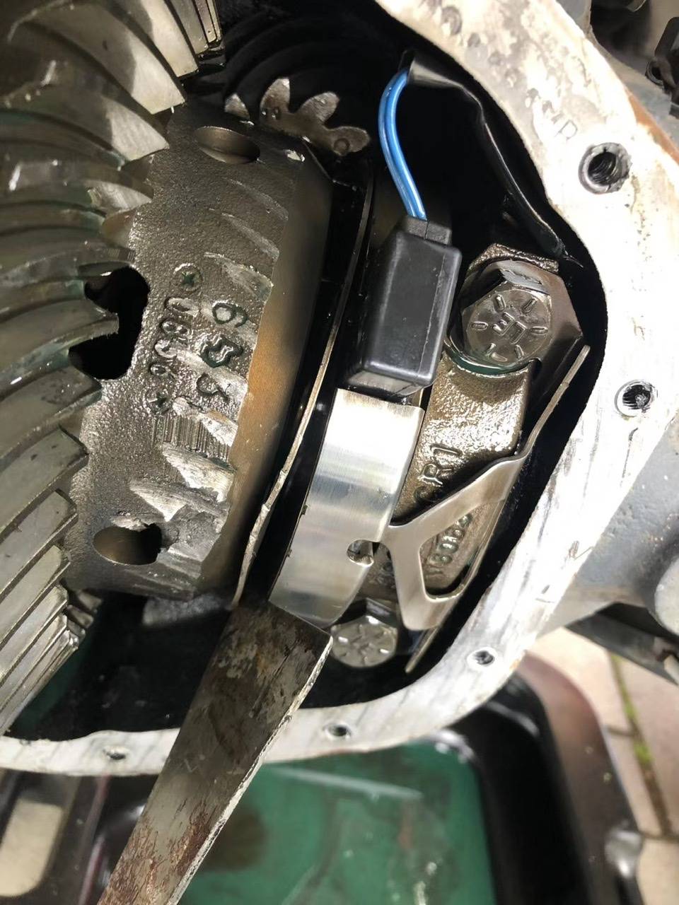

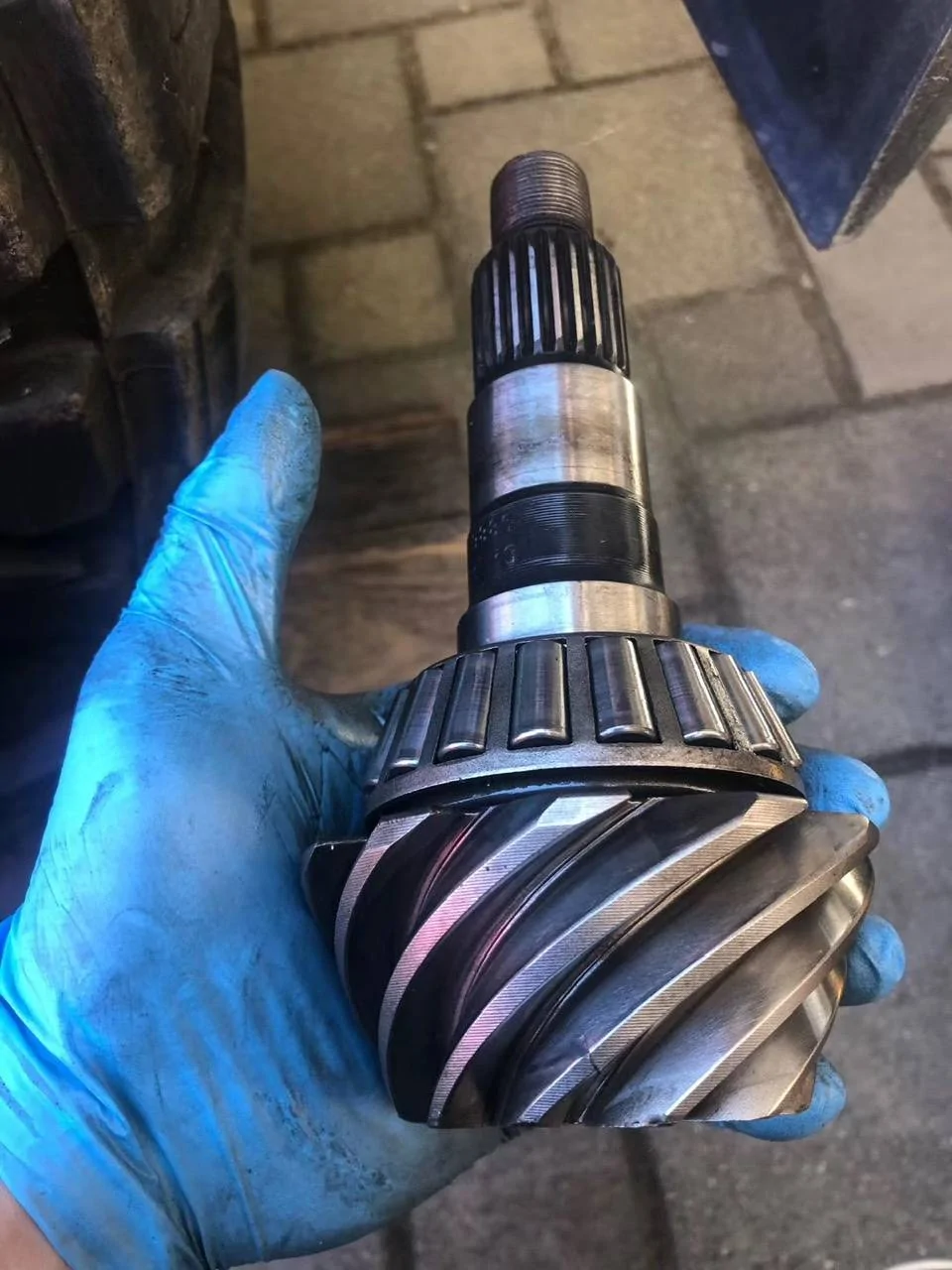

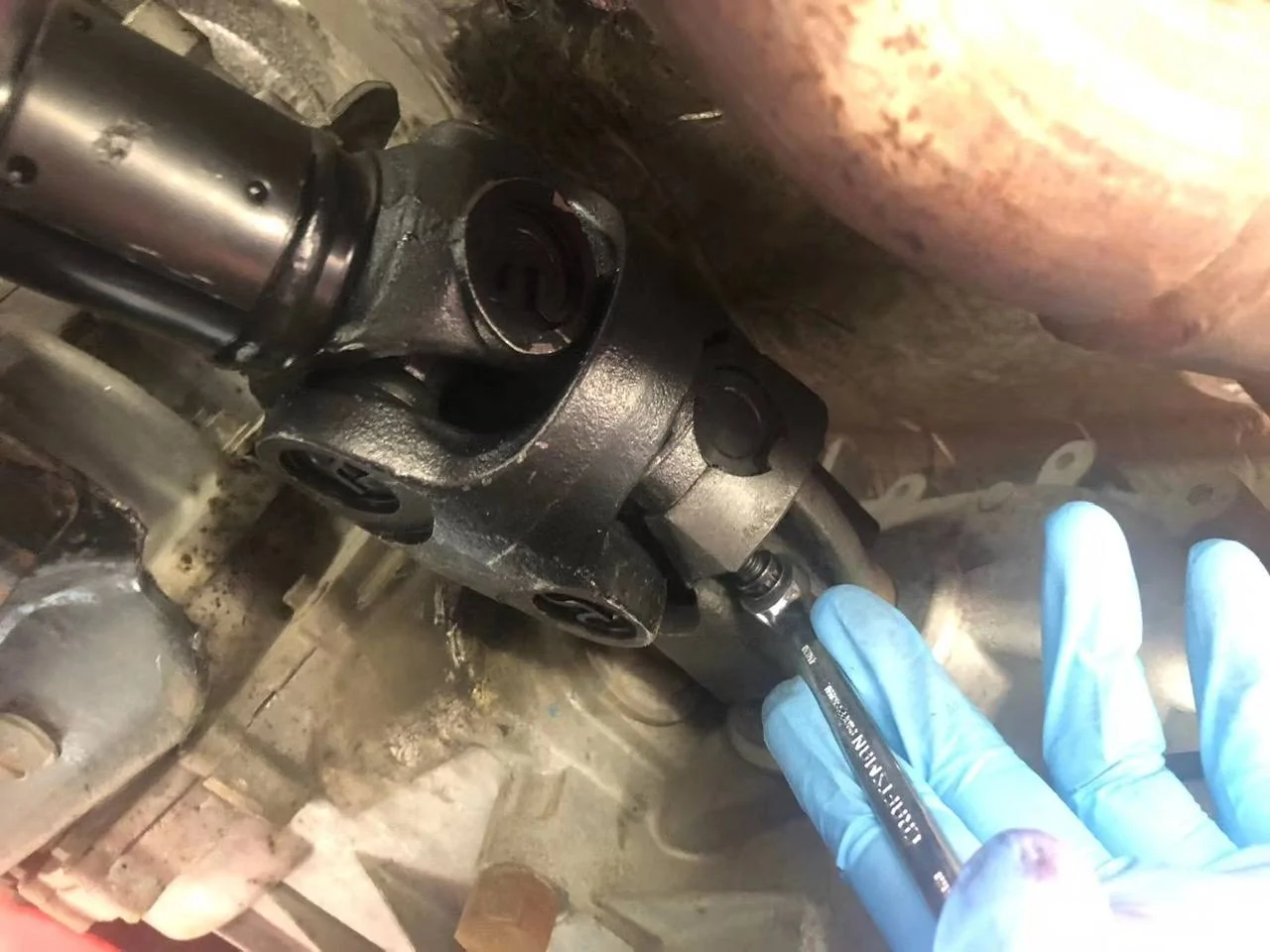

Before you say that this sort of damage could never happen. This is from someone I know that unknowingly drove their Jeep in 4wd and/or lockers engaged on dry pavement for quite sometime.
The pinion rubbing on the carrier caused by the pinion nut being loose, not caused by 4wd or lockers. The pinion won't move in the carrier because of any kind of binding if the pinion nut is tight. The only way for the pinion to move is loose fastners, the same as the drag link adjuster.
