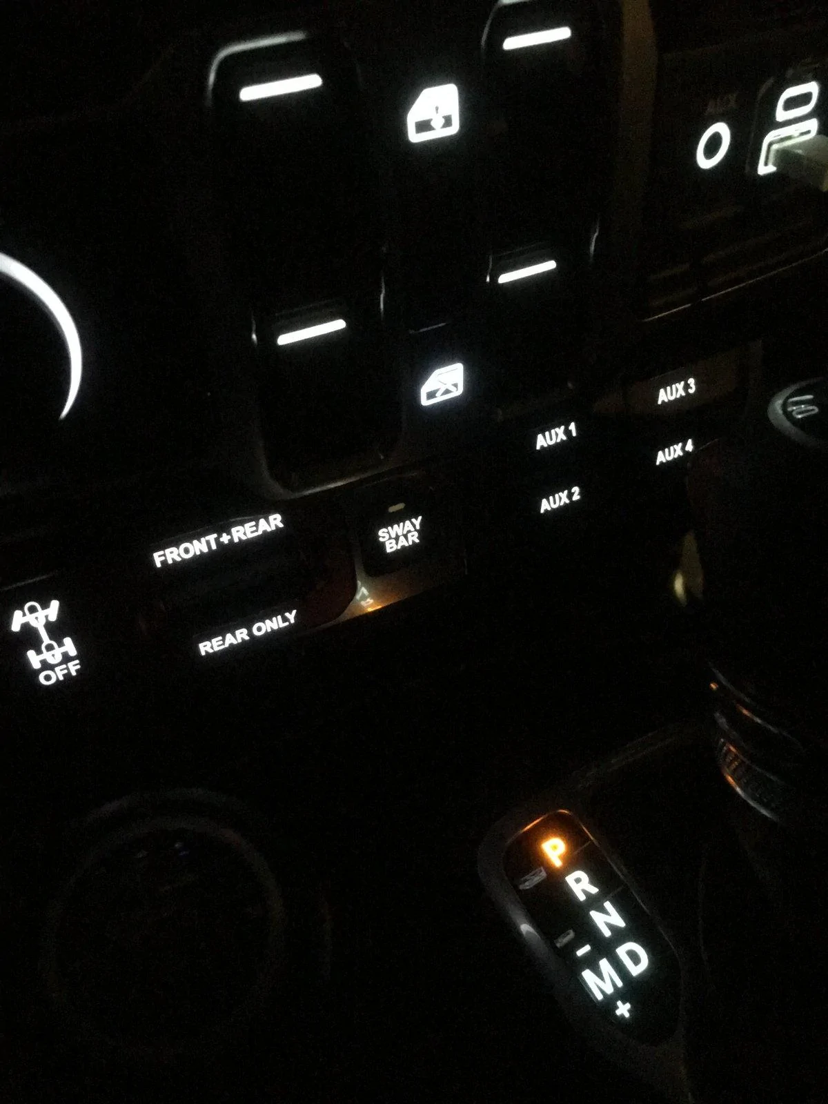

So today I received the tazer mini
I configured and played around with the options my aux switches work now and cubes are working of course ! Thank you to everyone. Question I do not see the lighting switch program in the setting. For example latching and etc. is this option only for the Jeep that originally came with aux options already installed ? Not a big deal. But I just want to make sure I didn’t miss anything. Thanks again Cram!!!!

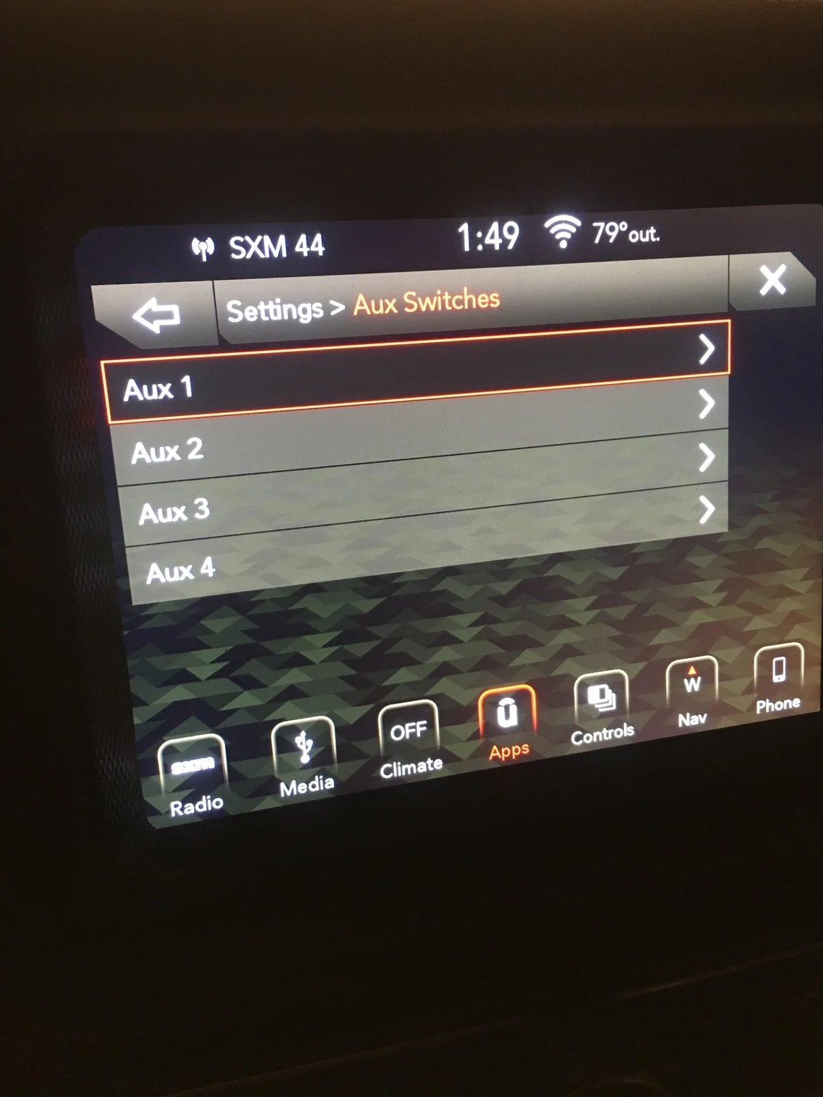

You should still be able to configure each switch in the Uconnect settings latching, momentary, etc.

Thanks for the quick reply. I need to navigate through the options. On one of the options/settings it has a “Aux”. And next to it states No and I couldn’t pick yes to no. Not sure if this is for aux for example. CD player. Video or something like that …
