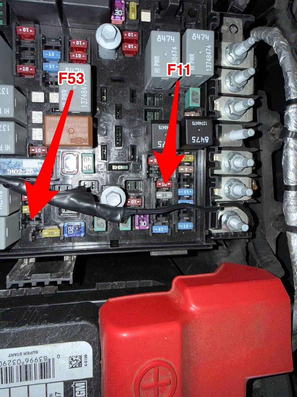

I’m looking at my fuse box on my 2021 Jeep JL and this is what I’m seeing.
Jeep Wrangler JL Android Auto Disconnect Issue from Center Console IMG_0766
F53 is just a holding slot I believe. I can’t push the jumper down into it.
Am I missing something?

Is your issue that the center console won’t disconnect from the phone?
If so I just did this fuse tap mod and it solved my issue of center console staying on and connecting to my phone.

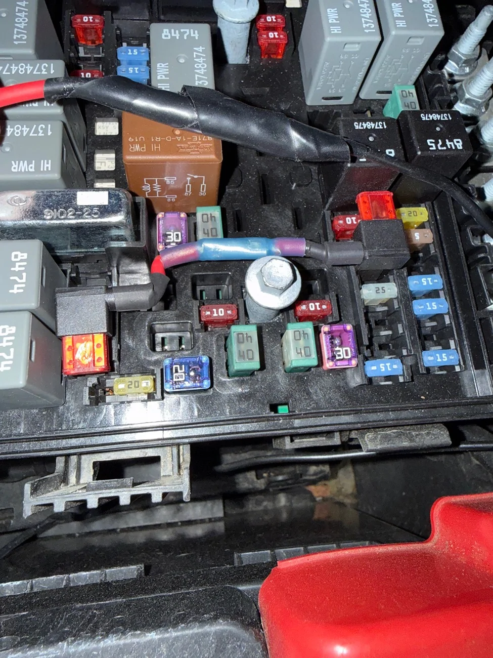

I ran it from F51 with two fuses to F11 with only one fuse in the top.
Fuse F51 is for:
Digital TV (DSRC)/USB/InSide RearView Mirror (ISRVM)/ Compass Module (CSGM).
Jeep Wrangler JL Android Auto Disconnect Issue from Center Console IMG_0769
Will this work and is it ok to turn the Jeep on now to try it out?
Any possibility messing anything up?

@Grayhound
It works!!!!
Man that’s been bugging me forever about my phone staying connected when I leave the Jeep.
Now I turn the Jeep off, open the door, and the center console usb port shuts off disconnecting my phone.
Thank you so much!!!!!!!
