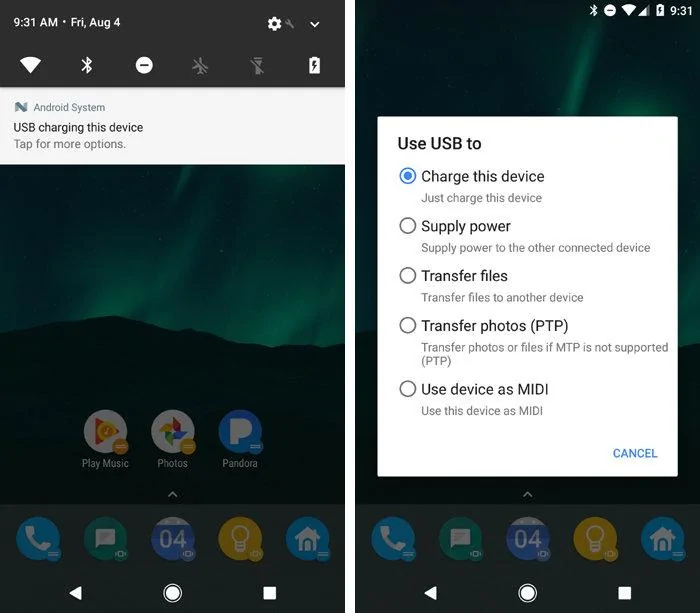

When connected,do you have a notification saying "charging" or something like that? Try tapping it and seeing if other options come up. What you're looking for is "transfer data".
It does start charging when plugged in, but I don't think I get any type of notification. I will check again on my way home from work tonight.
