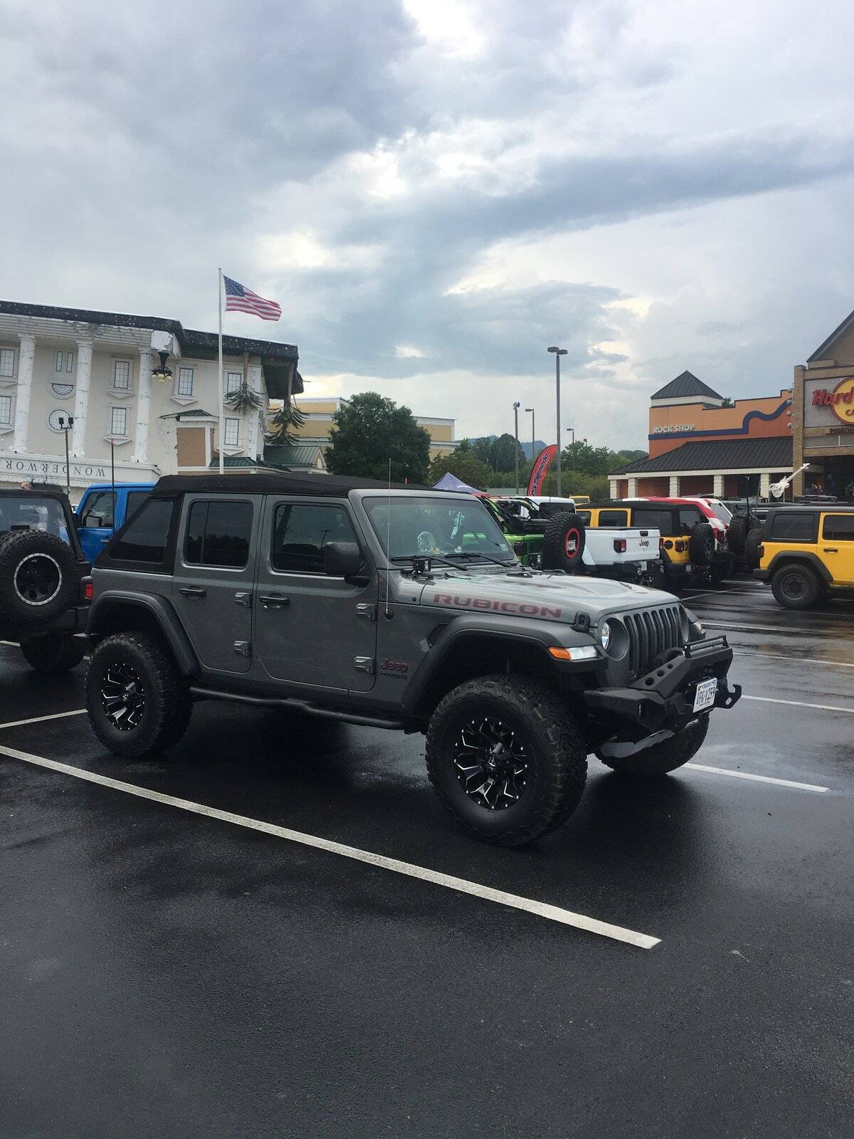

I have Rival front and rear on my JL very pleased with them.

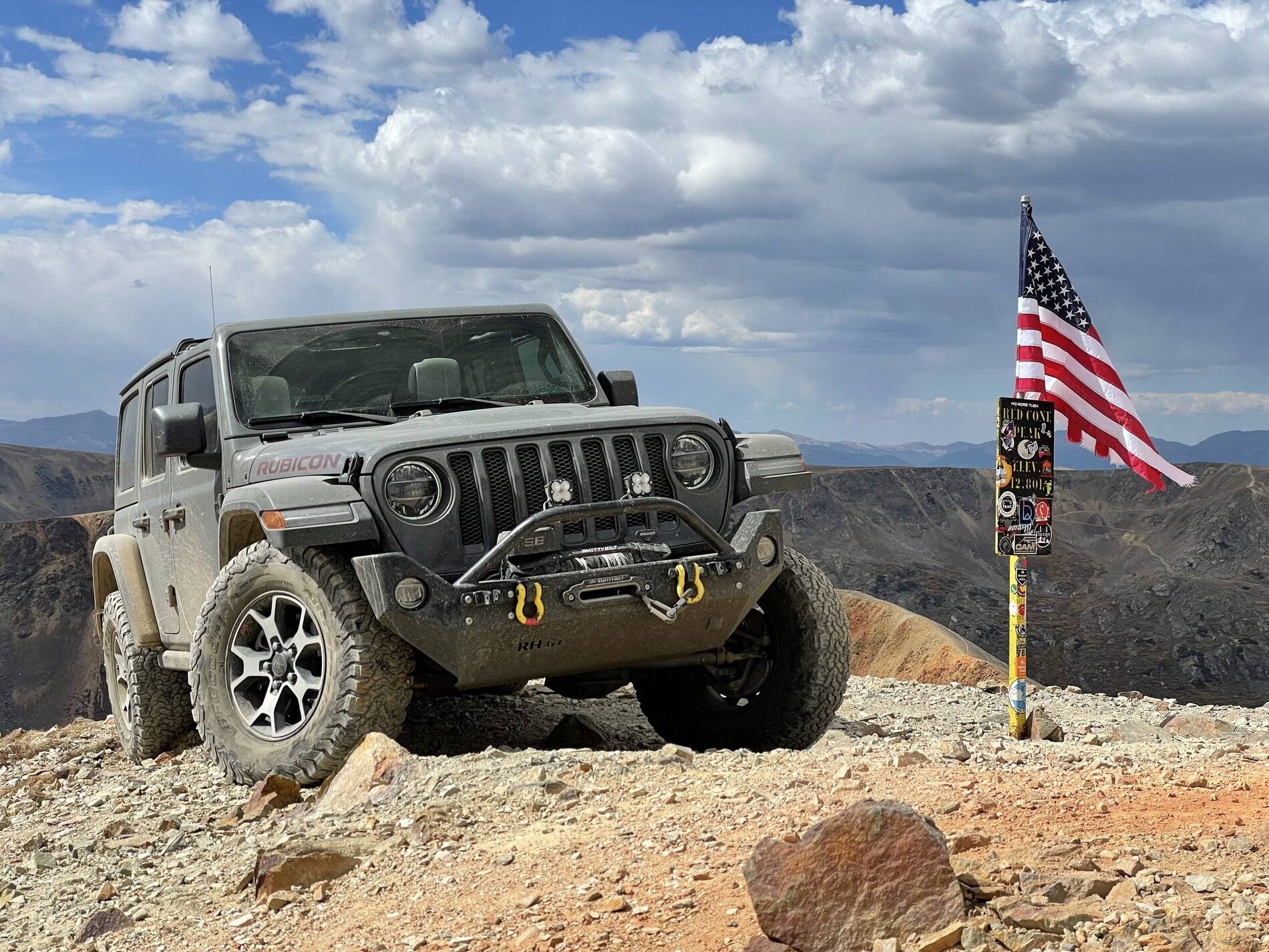

I have the Rival full-width aluminum front & rear, had them 6 months. So far they're fantastic. Highly recommend them. Lightweight, easy install, steel only where it's required (winch plate, frame connections, recovery points, nuts/bolts), can't rust, sturdy. I use the full width rear bumper as a step to get to the roof very often. Even though the part I step on is as far from a mounting point as possible it's still a rock solid step, and I'm not a lightweight guy. I'm not going to intentionally bash them into rocks but I'm confident that it won't easily crumple if it does. Might scratch easier than steel but we'll see.
