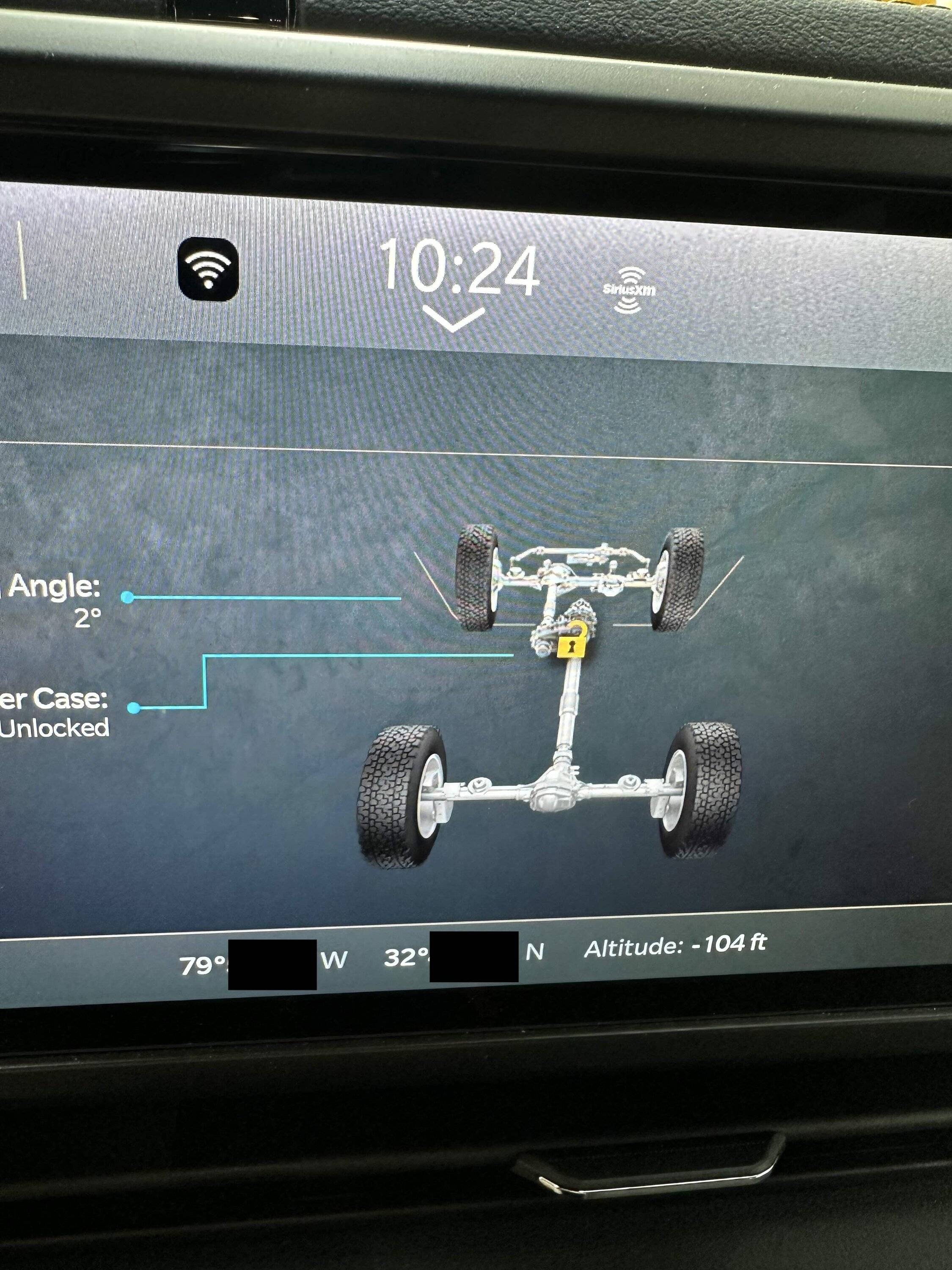

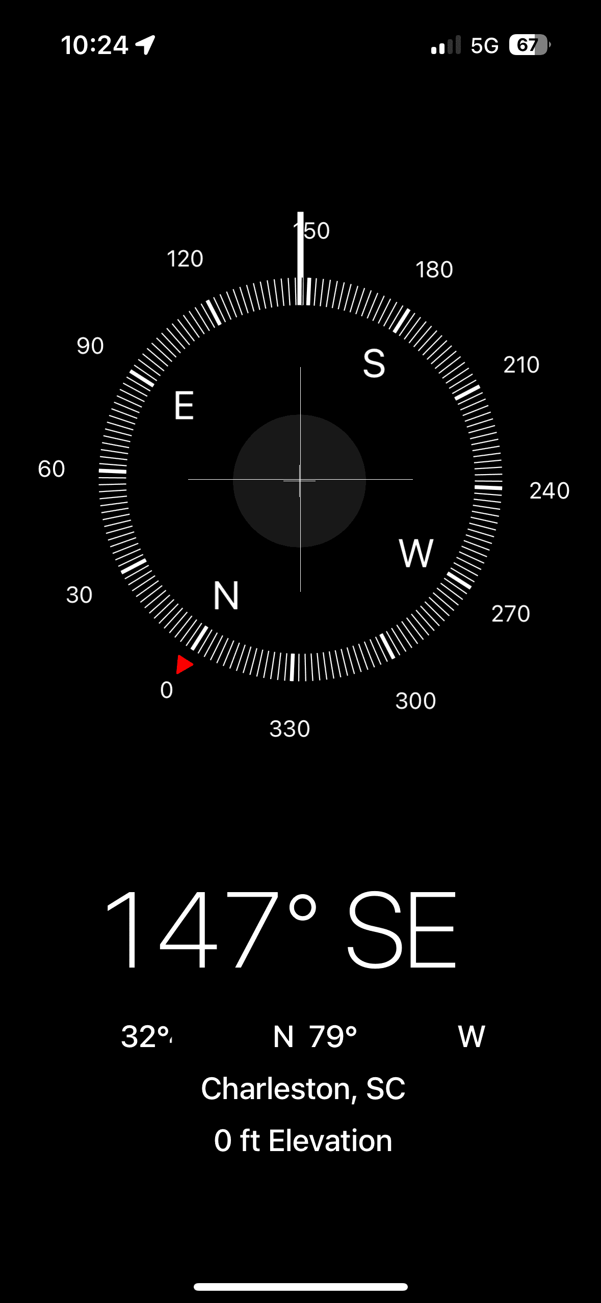

I know I can use other devices to get the same info. I just want the instruments on my 2024 Jeep to be reasonably accurate. @JeepCares is this a known issue?
My iPhone says I am at 0 ft elevation (correct):
My Jeep says I am at -104 ft (obviously incorrect):
Jeep Wrangler JL Altimeter calibration IMG_0533

I just checked my iPhone altitude with the compass app along with offroad pages on my 2024 Rubicon. My phones was 10-15 feet too high and my Jeep was 100-115 feet too high which is very similar to yours. This is absolutely atrocious, now i want mine corrected also!

My 2024 is also constantly about 100 feet off when compared to other devices, Garmin, phones, etc
GPS is always calculated on the device. The device receives signals from satellites and then calculates the data/position locally on the device. This means they have somehow messed up the calculations in the software. I would hope they could fix this with an over the air software update.

Elevation accuracy of GPS is generally 1.5x horizonal, or about 75 feet, under near perfect conditions at and alpha of 0.05. Buildings, bridges, trees, the vehicle make for not perfect conditions. You're phone is not perfect.
It's easy to convince ourselves our GPS is more accurate that it is thanks to maps and algorithms that determine we are on the road even if the raw signal is 100+ feet off the road. You'd be happy is the software just told you your elevation was the elevation of the point on the map it guesses you're at in the moment.

Mine says I’m -70’ below sea-level at home. Florida panhandle.

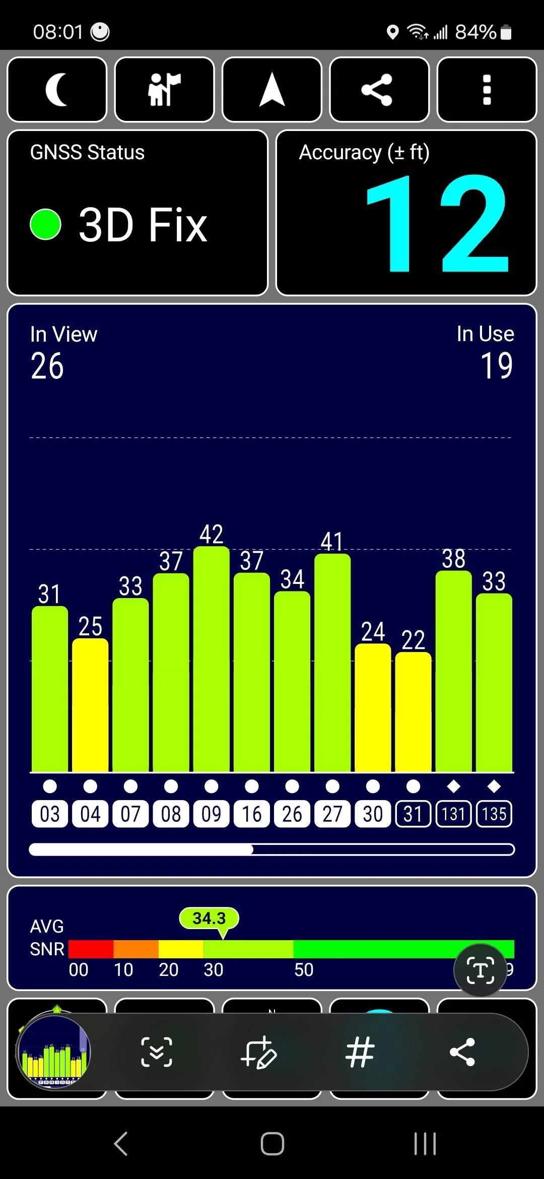

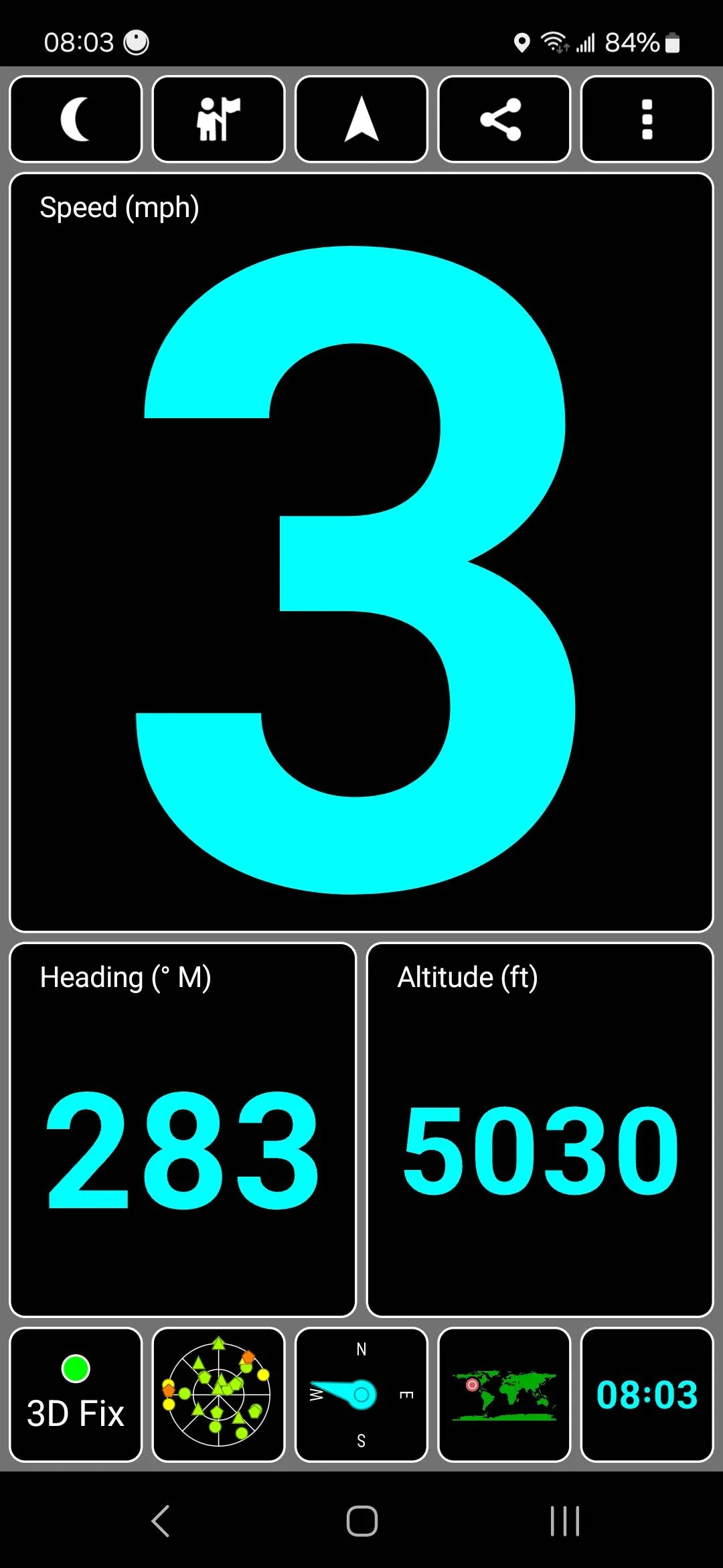

As I mentioned earlier, "GPS Test" is a cool program. The attached screenshots are very telltale. 12 foot accuracy?!? Even if very opportunistic, Wow! 3 MPH screenshot is me walking quickly. Pretty sensitive. Some phones are better than others, this one is a S21 FE 5G. The earlier posts at 29K ft were in Airplane mode, on an airplane! Elevation readings on land are within 15 feet of posted landmarks.

The GPS satellites constellation is in orbit relative to a mathematical representation of the earth surface. The satellites broadcast time across multiple frequencies and the Jeep is likely a single frequency receiver which must be receiving quality (unobstructed) readings from a minimum of 5 satellites to adequately calculate an elevation on the surface of that mathematical model. This is known as the ellipsoid height. If you want a more accurate elevation to actual ground, you would need to be able to upload an orthometric correction which varies from the model depending on where you are located on the earth. This is known as the orthometric height. In my area, the difference between ellipsoid and orthometric height is about 3 feet but it can vary much more than that.
face your Jeep generally to the south sky which is predominantly where the GPS satellites are located with as clear views to the sky at least 15 degrees above the horizon for the best coverage. The more satellites you’re reading, the more accurate it will be. But still not perfect in terms of ground elevation. If you are within 20-30 feet, you are doing good.

Always thought GPS-based altitude was not as accurate as lat/long. Da Google says it can be within +/- 75 feet. Garmin says theirs is only accurate to +/- 400 feet! I think what you get out of the Jeep system is as good as it's going to get.

Why can my iPhone be dead on but my Jeep in the same location can be off by 100+ feet? Can't really have a much better unobstructed view of the sky than when sitting on Folly beach at essentially sea level.
