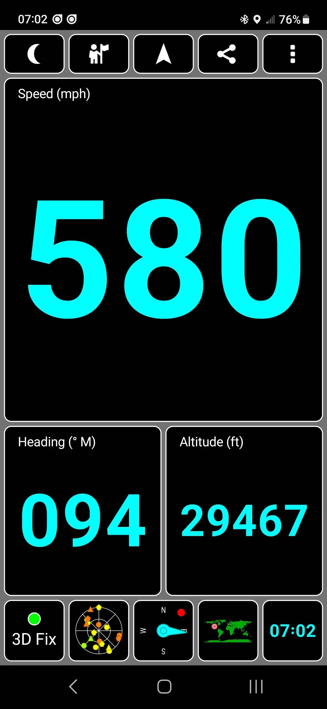

I don't know about calibration. However, true altitude may obtained via cell phone, Android App, "GPS Test". It does not require cell/internet service to function. It uses satellite. I drove pretty hard last Christmas....

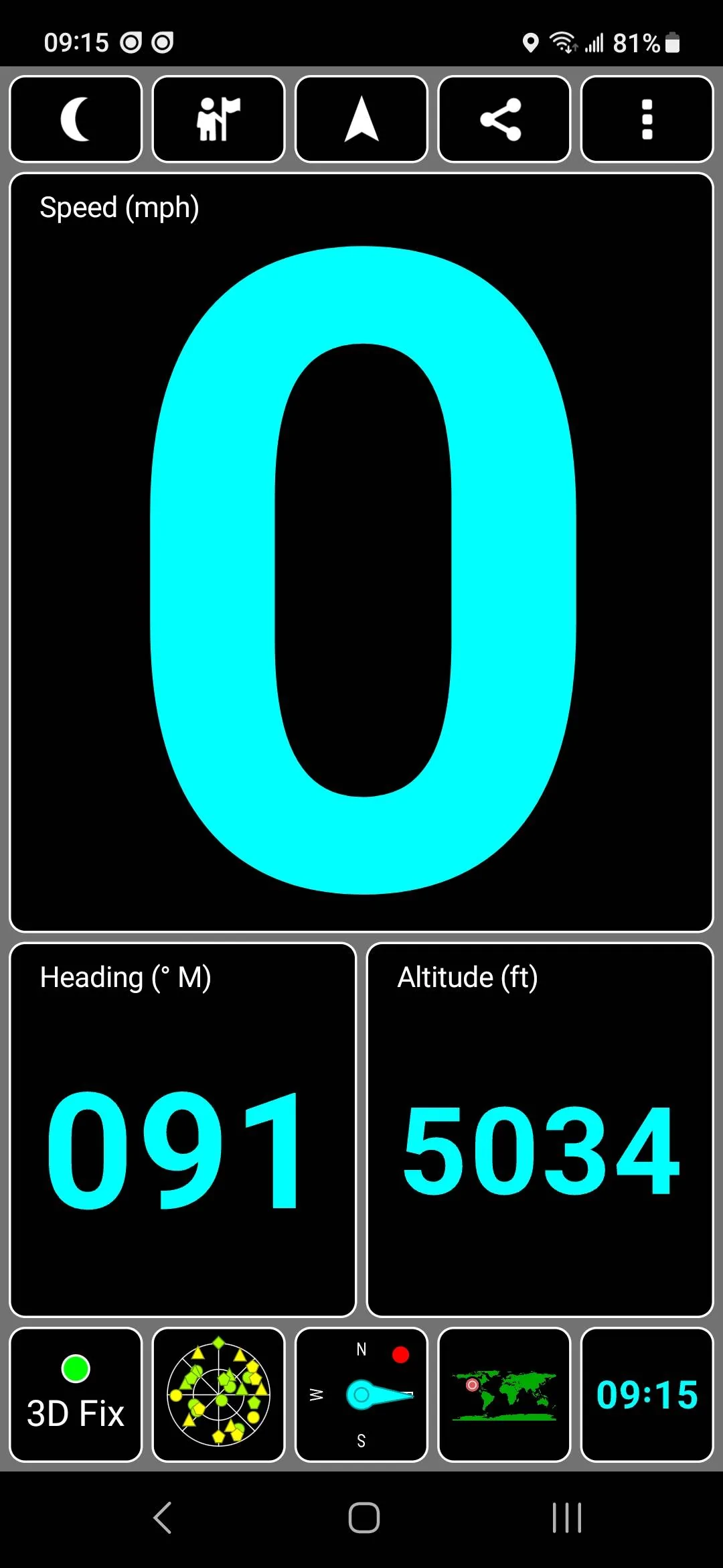

Just deduct the true reading from displayed. Not available on Apple that I know. Below, my home reading.

Cool app. I was using a different one. In this case I'm really just hoping to get the jeep in the ball park.
