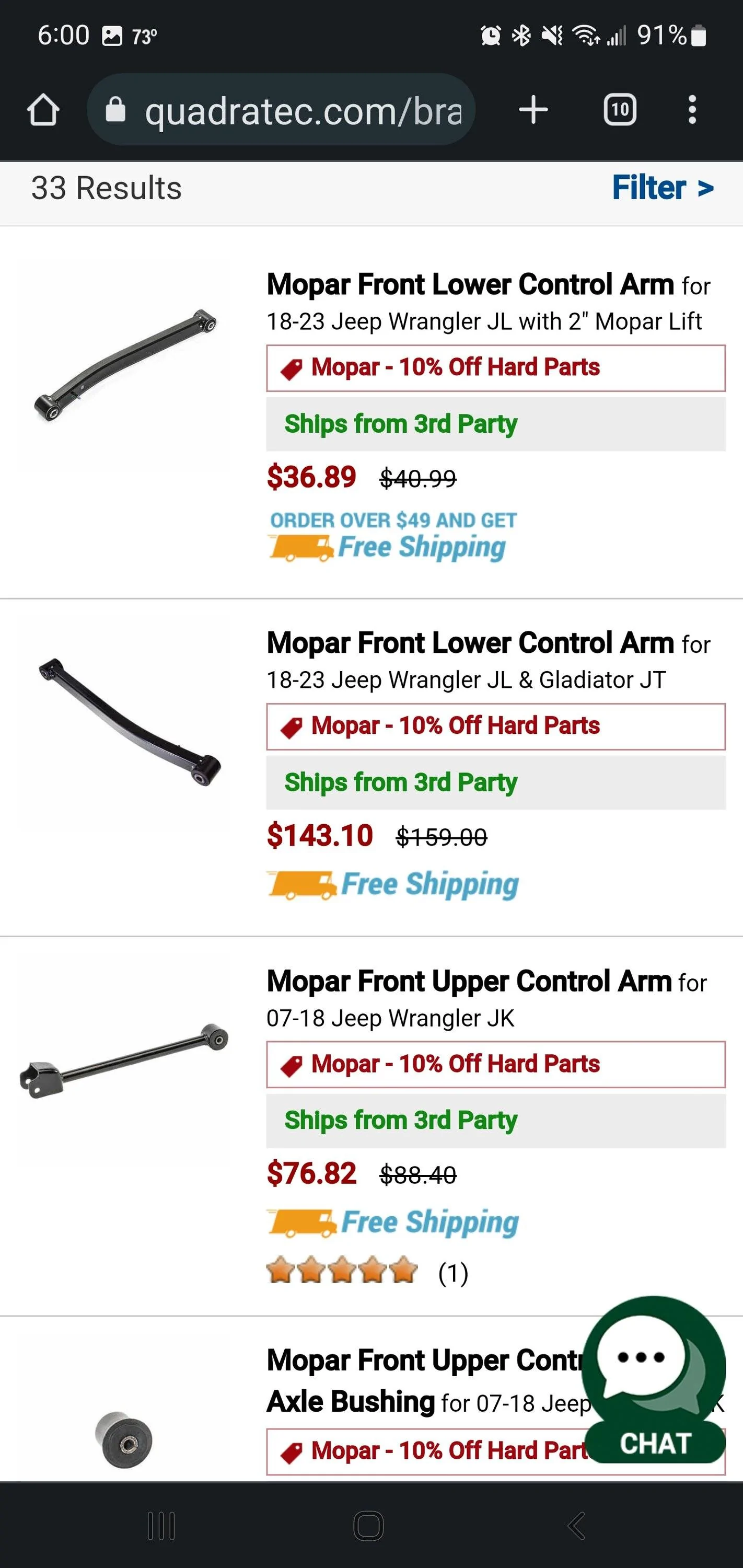

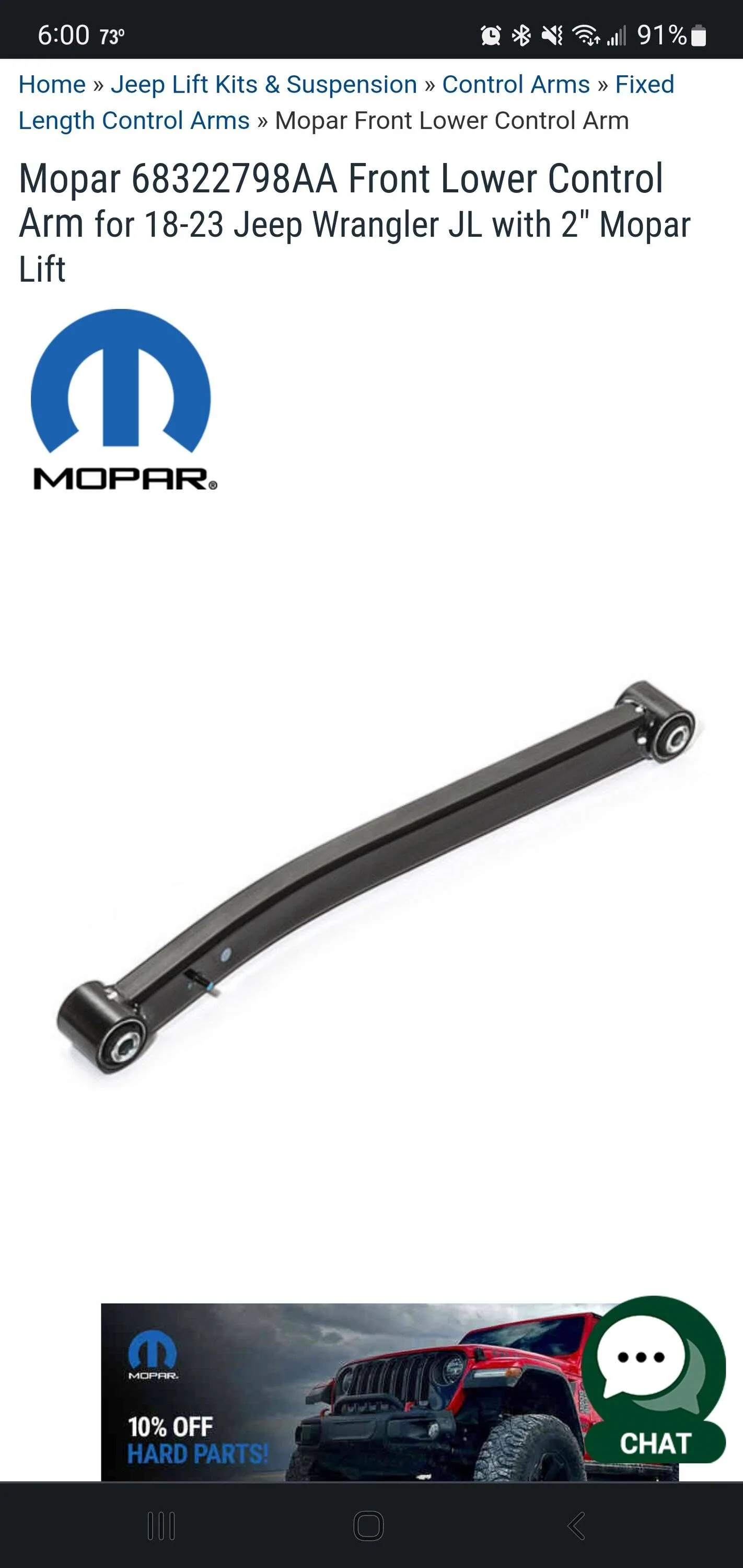

I wonder why the lifted Mopar LCA is so.much cheaper than the regular.. stock issue I guess?
