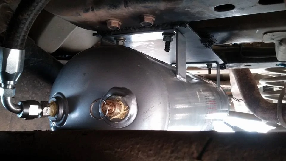

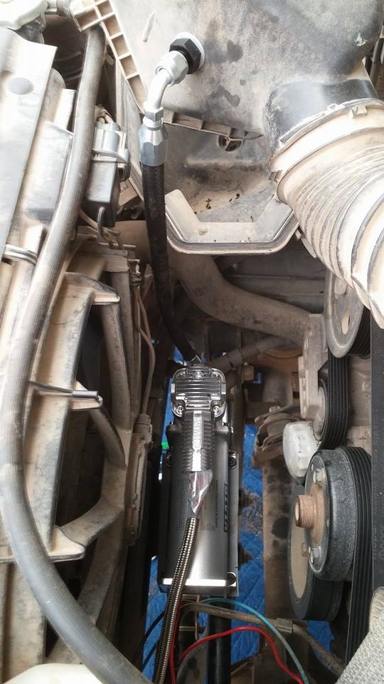

this is the set up in the 07 JK. viair 450 constant duty with the 2.5 gallon tank. air chuck in the front bumper, does 35's 12lbs to 35lbs in about 5 minutes a tire. does not stop for overheating and runs air tools fairly well when the tanks full, it'll break loose the front hub bearing axle nut. i hand break wheel lug nuts, then use the air impact, takes too much air to break em loose with just the impact.

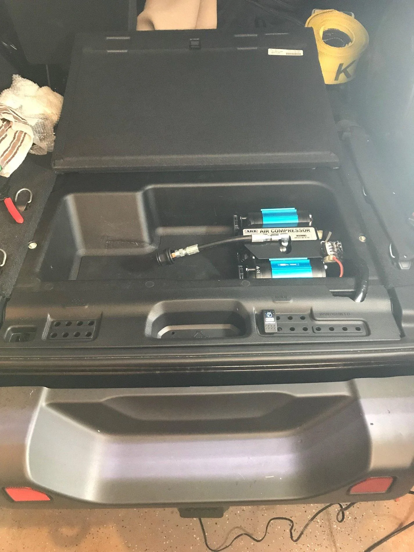

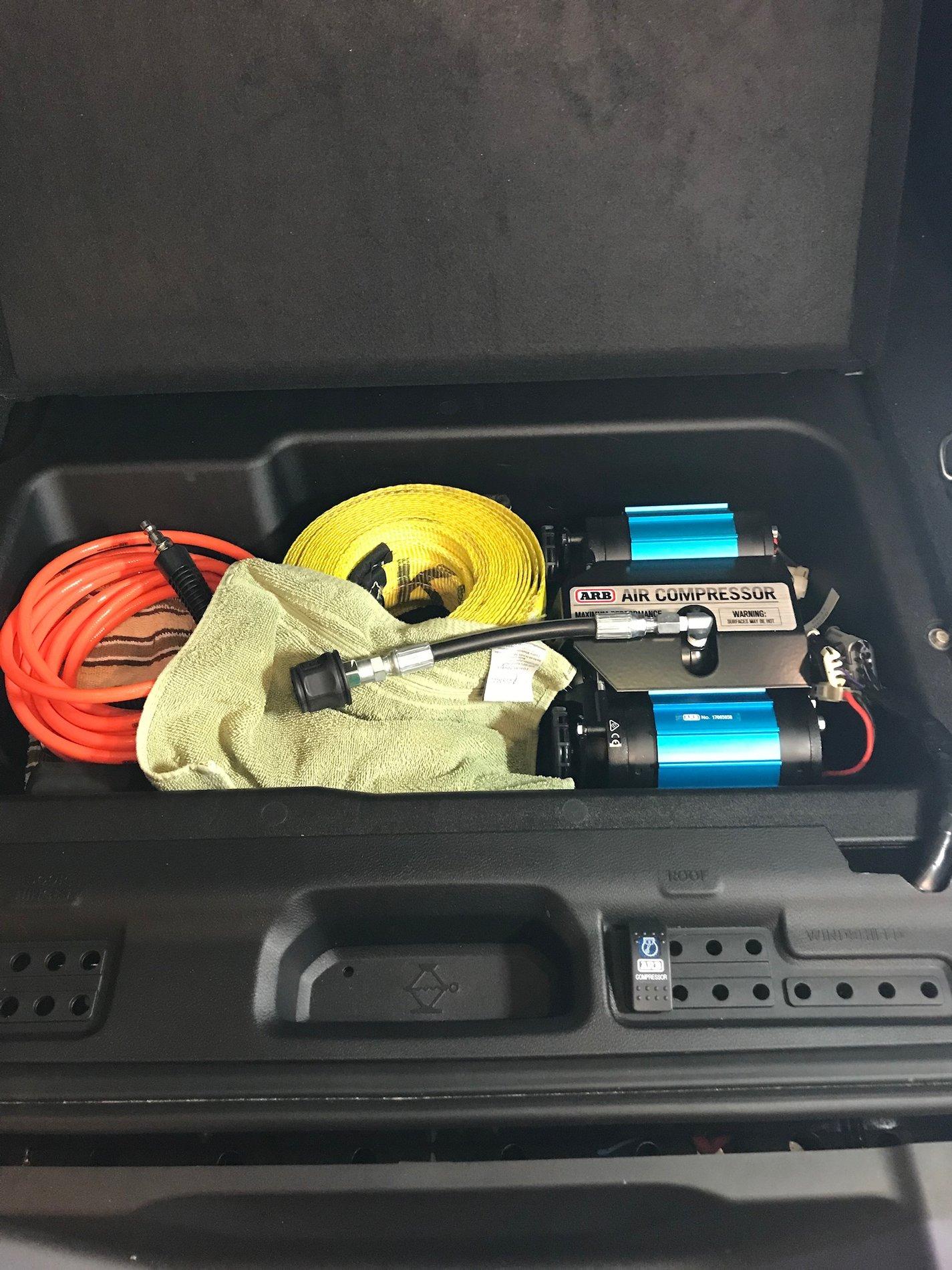

I went this route. Kinda pain to run the power wire but for me it’s the best place. I got it really hot the other day and it’s just fine. No issues with heat and gets fresh air. Obviously, I keep the cover open while in use. I aired up my neighbors Super Duty tires from 40 psi to 80. Took like maybe 8-10 minute for all 4. These things are super fast , but the downside is the expense.
Much better than under the hood. I had it under the hood of my JK and talk about heat soaking before even using it.

unfortunately in the 2 door ill have a speaker there. very clever, amazing what that space can hold. with only 4 doors at the lot, i was somehow convinced that i was going to lose the space in the side mount whether i got the alpine or not. so i ordered it having never seen that they put it in the cargo in a JK too on the 2 doors. sad that i lost that space.......secretly jazzed ill have bumping tunes!
