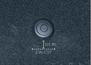

you cut a 2 inch slit in your carpet
Put the strap below the plastic nut that holds the carpet in place
Pull it through the hole
Put the carpet back and install your jack base. Does not work with the Mopar jack base.
I attached the instructions from AEV.
