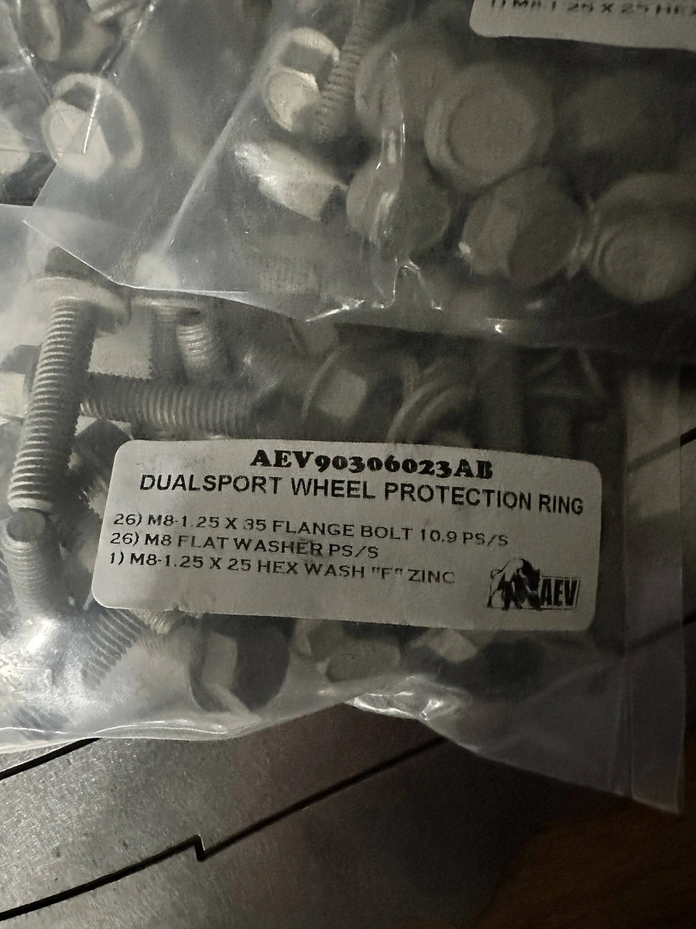

I received my JL borah wheels today. 1 of the 5 has a problem with the center cap. It won’t fully seat. And if I swap center caps around doesn’t change. So definitely a wheel problem. Which they are replacing only once I send the other back. I also received a damaged protection ring that they don’t think is damaged “enough” for a return. Lol. I understand it’s a sacrificial part but I wanted to be the one to scratch them up. And to top it off the bolts are all 8.8 bolts. They claim that’s what they use with protection rings even though package says 10.9. So far hasn’t been a great first impression with aev. Had I known I would have looked elsewhere for wheels.

the protective ring bolts are 8.8.
I saw on an earlier post they changed them to 10.9. I could be wrong. But they should probably fix the label then for the protection ring bolts
Dang! I got the same bolts, but I didn't pay attention to the label. Either way I am getting new bolts. I will be trying the black bolts that come with the mopar protective ring.

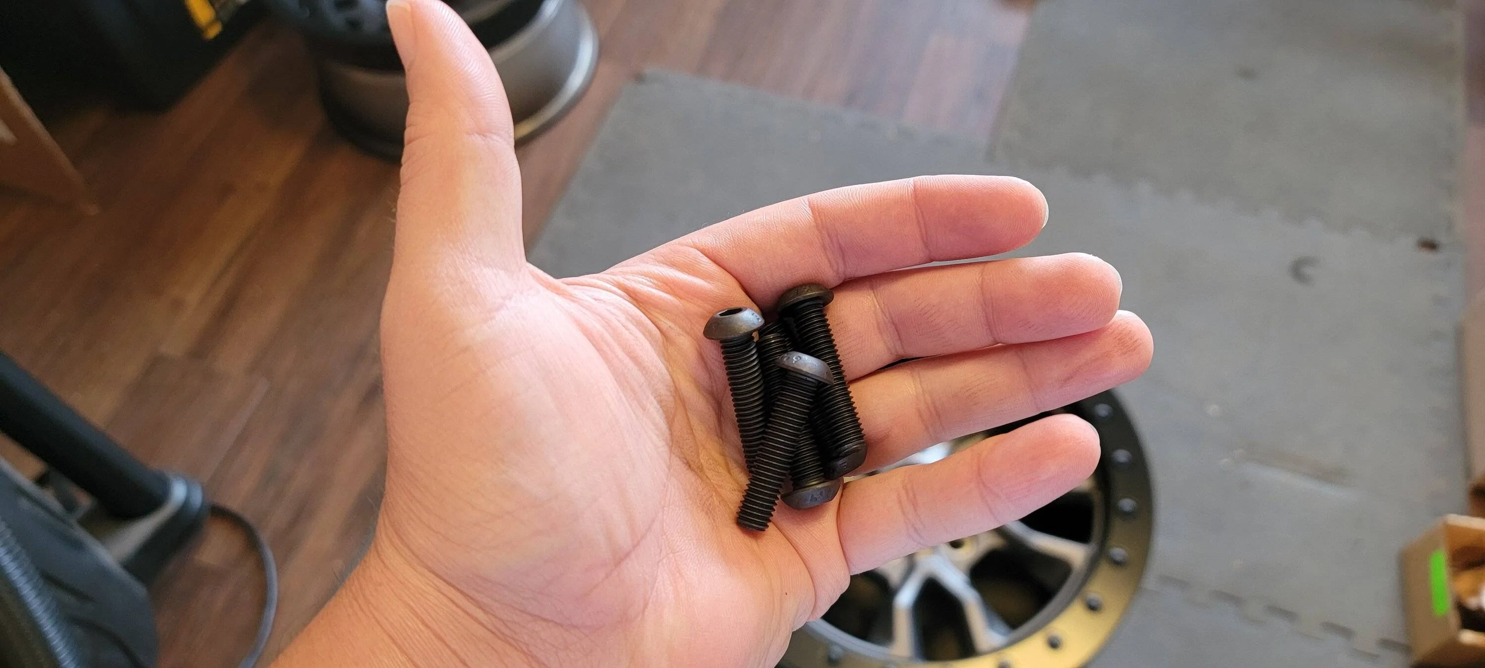

ha...with matching washers and ready to ship? No rust issues?
Yes with matching washers. Any bolt that you get that doesn't have some form of "automotive" finish on it will rust. My bolts in time will either rust or turn green if exposed to the sun. I always just drill some holes in cardboard and spray them down with self etching primer and paint over it before install. Then they stay nice for a long time. But even then you're going to scratch the coating during install. It's a vicious cycle. ? ?
However, I do have these in stock and can ship within the hour.
Do the Mopar oem bolts need to be painted? I would think not.
DOOKEY, how much for a set of yours shipped? And will they rust on day one without primer and paint?
Thanks.
Most bolts have some form of rust inhibiter to keep them from rusting until you purchase them. The OEM bolts are no different. When you purchase them you'll see the coating has taken a beating so they'll start to rust where the coating is missing. Then you hammer on the coating with a socket and more coating comes off. So it rusts there.
My bolts have a black oxide finish but that isn't some magical process to stop the rust indefinitely. It's steel. Steel rusts. If you care about your bolts staying nice you need to install the socket cap style bolts that use an allen key. Then paint the inside of the socket cap where you damaged the paint.
Or... go scrape it up on rocks and forget about it. ?
I'll send you a PM for the bolts.
I hear you, but I’m also pretty sure that the oem bolts from Mopar don’t need to be painted to stay rust free. Maybe I’m incorrect in thinking the oem XR wheels come with black bolts; is that correct? And are those like $2.50 a piece (so close to $300 for a set of them?).
Black oxide will rust overnight if not painted. I’m just wondering what the oem finish is that keeps them from rusting. I’m guessing they’re finished with an oem type paint, which makes sense buying wheels and bolts directly from Mopar.
Last question: are the oem bolts socket cap?
