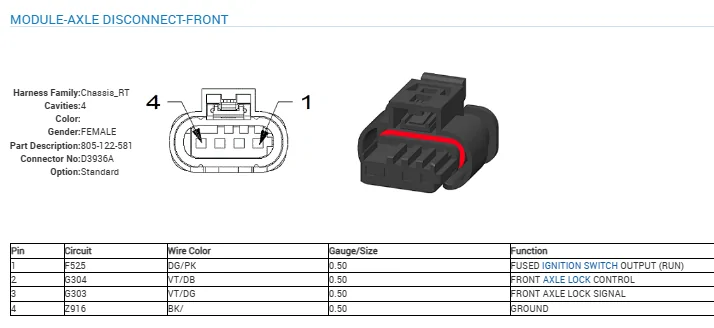

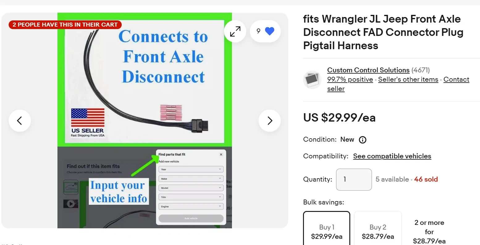

Instructions for adding a FAD
Thank you for sending the info!
Right now I think I'm going to leave the FAD as my last resort. I like the idea and the benefits of a FAD; more flexibility with a higher lift, not the supposed fuel savings. And they've ended up being a lot more durable and reliable than a lot of people worried about when the JL first came out. But I want to try to avoid something electronic that the Jeep didn't already come with. I don't want to have to fight error codes.

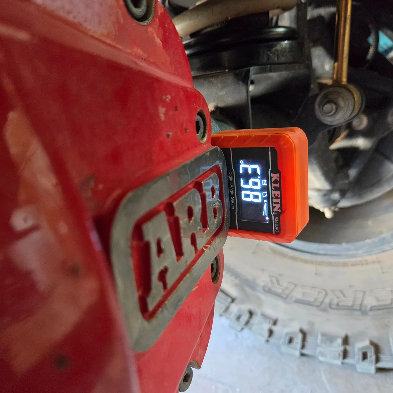

First, I figured out a good way to deal with my funky garage floor. I measured the slabs and they are 12'x10', with the long dimenstion running front to back, so I was able to park the jeep all on the same slab. I know it sounds dumb but when you when you're trying to get to a tollerance of a couple thenths of a degree, you need the entire vehicle on a flat plain.

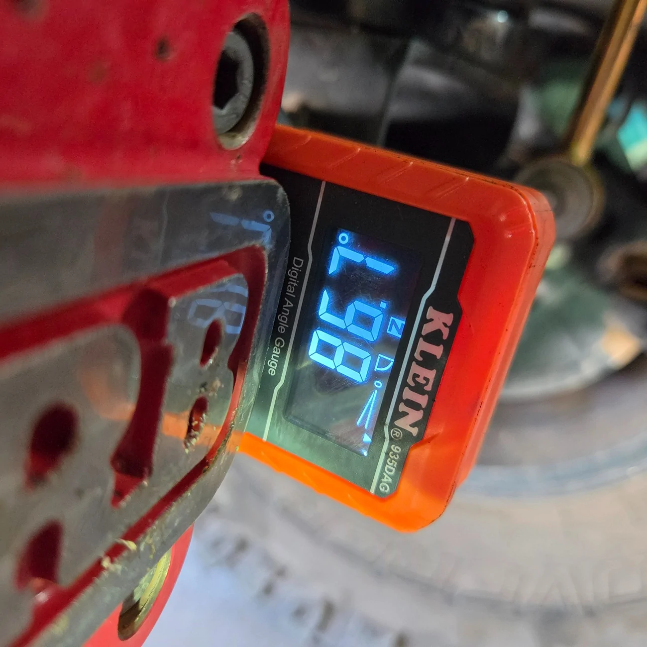

Here's a prime example of how my garage floor is messing with my measurements. After yesterday I measured my caster and it was 3.4 degrees, unfortunately I didn't get a picture, but that measurement was taken from the middle of my garage. When I started today, I first checked my caster again, from the normal spot where I park; fricking 2.3 degrees!!!
Jeep Wrangler JL Adjusting Pinion Angle 20260405_142213
This is when I measured the size of the slabs that make up my garage floor. Measured the caster from there. 3.7 degrees, and I was finally comfortable with that measurement becuase it was from all one slab. But of course, I forgot to get a picture. My goal was to get to 2.5-2.8 degrees caster to point the pinion up as much as possible. I ended up adding 3 full turns to both UCAs, which got me to 2.7degrees.

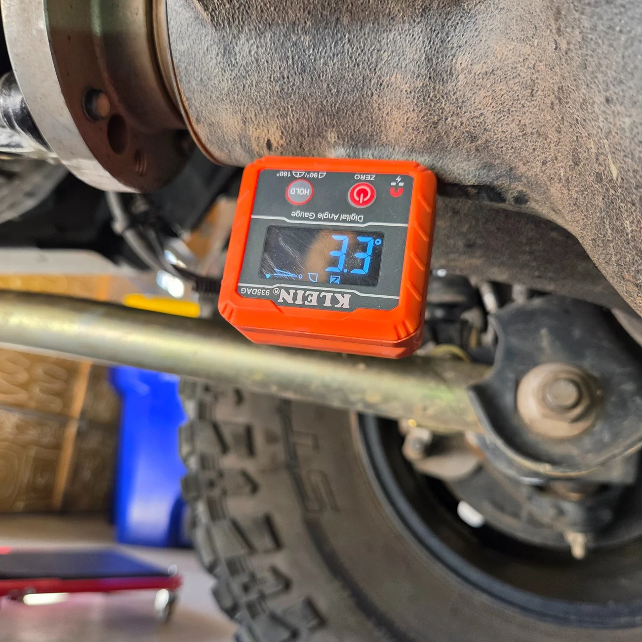

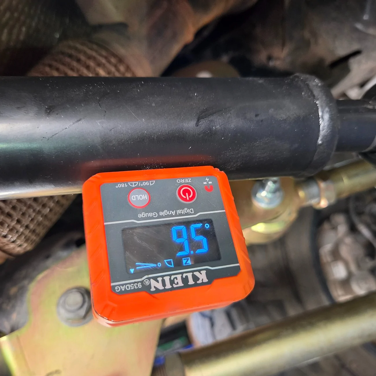

Back at home, parked on the same slab again. I measured the pinion and the slope of the driveshaft. Pinion was 3.3 as expected. Driveshaft was 9.5 degrees. So with all the changes, drop brackets, 2.5" springs, caster adjustments, I got the pinion and DS to within 6.2 degrees of one another; I was trying to get as close to 6 degrees as possible. I know 6.2 degrees isn't great, but considering it was off by 8.9 degrees when I started I'd say it was worth it. At some point I'm guessing I'll need a new front driveshaft, time will tell. Or maybe when the time comes I'll get an ultimate 44 and put the 3.5 springs back on. 🤔
Front Pinion:
Jeep Wrangler JL Adjusting Pinion Angle 20260405_152828
Front DS Slope:
Jeep Wrangler JL Adjusting Pinion Angle 20260405_152924
