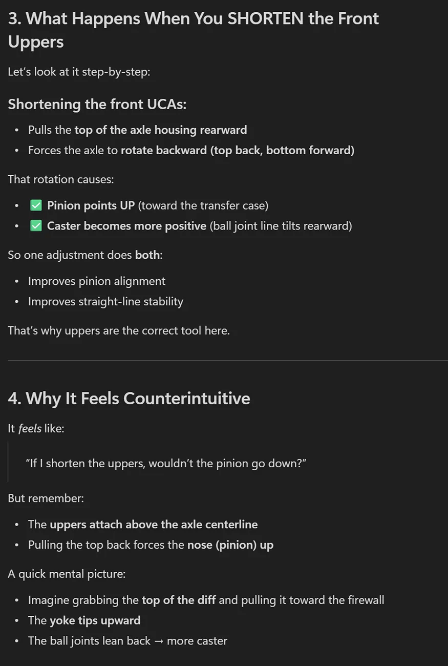

On a trip back from Moab to CO Springs I noticed some noise coming from my driveline at about 68+ mph while under load, hill climbs. Was fine on the flats. Yesterday I measured my front pinion angle and driveshaft angle. They are well outside of the recommended 2 degree variance. I also checked my caster, which is at 3.4 degrees. I know 3.4 sounds low, but my Jeep drives great. The current low caster is absolutely not an issue, but I don't want to go too much lower.
This weekend I'll be making adjustments to improve the pinion angle. My assumption was to lengthen the UCAs to roll the axle forward. My belief is this will improve the pinion angle, but will also reduce caster further.
I decided to ask MS Copilot for recommendations and was surprised by one of it's responses. It says that shortening the UCAs will increase caster (obviously) but would also improve the pinion angle (i.e. point it up towards the driveshaft). That second part about the pinion through me for a loop. I specifically questioned that recommendation and here is the response from Copilot.
Bottom Line
You were right to question it — but the original recommendation is correct:
âś… Shortening front upper control arms rotates the pinion up and increases caster
✅ This is the cleanest way to improve driveline behavior on a no‑FAD JL
Is this correct? Or just AI being a little too overconfident?
In case your wondering I have a 2025 JLUR (no FAD), full 3.5" MC GC lift (netted 5.25 actual lift) with MC Driveshaft, OEM rear DS. Aluminum (Rock Hard) bumpers, winch, Teraflex Alpha HD hinged spare tire carrer, 37" STT Pros. The net lift is high becuase I don't really have anything weighting it down. I know I could run larger tires or reduce the lift, and I may do that at some point.
But all I'm really wondering is if Copilot is right that shortening the UCAs will actually increase the pinion angle. It seems very counterintuitive since that will roll the axle backwards.

I don’t know what AI is saying, I try not to use any of that shit….. with that much height, I’d consider using your control arm drop brackets

AI is incorrect, shortening the upper control arms will rotate the pinion down, as it would pull the top of the axle reward. Lengthening the uppers would rotate the pinion up.
Thank you both for confirming what I thought was total bullshit.
I've just been dabbling with AI a little lately. In can be good at speeding up research. It crawls all these forums and other websites and then gives you an organized easy to read and understand answer to your question. The problem is, there's a lot of bad info on the interwebs and it isn't smart enough to know what is right and what is wrong. Everything else in a few pages of it's explanations and recommendations was accurate and made perfect sense.
But looking at more of the response in detail I think I figured out how it's getting it wrong. It probably saw people talking about adjusting the rear pinion. Where if you rotate the rear axle back (by lengthening the rear UCAs) it does point the pinion up. It's just not smart enough to realize it has the opposite affect in the front.
