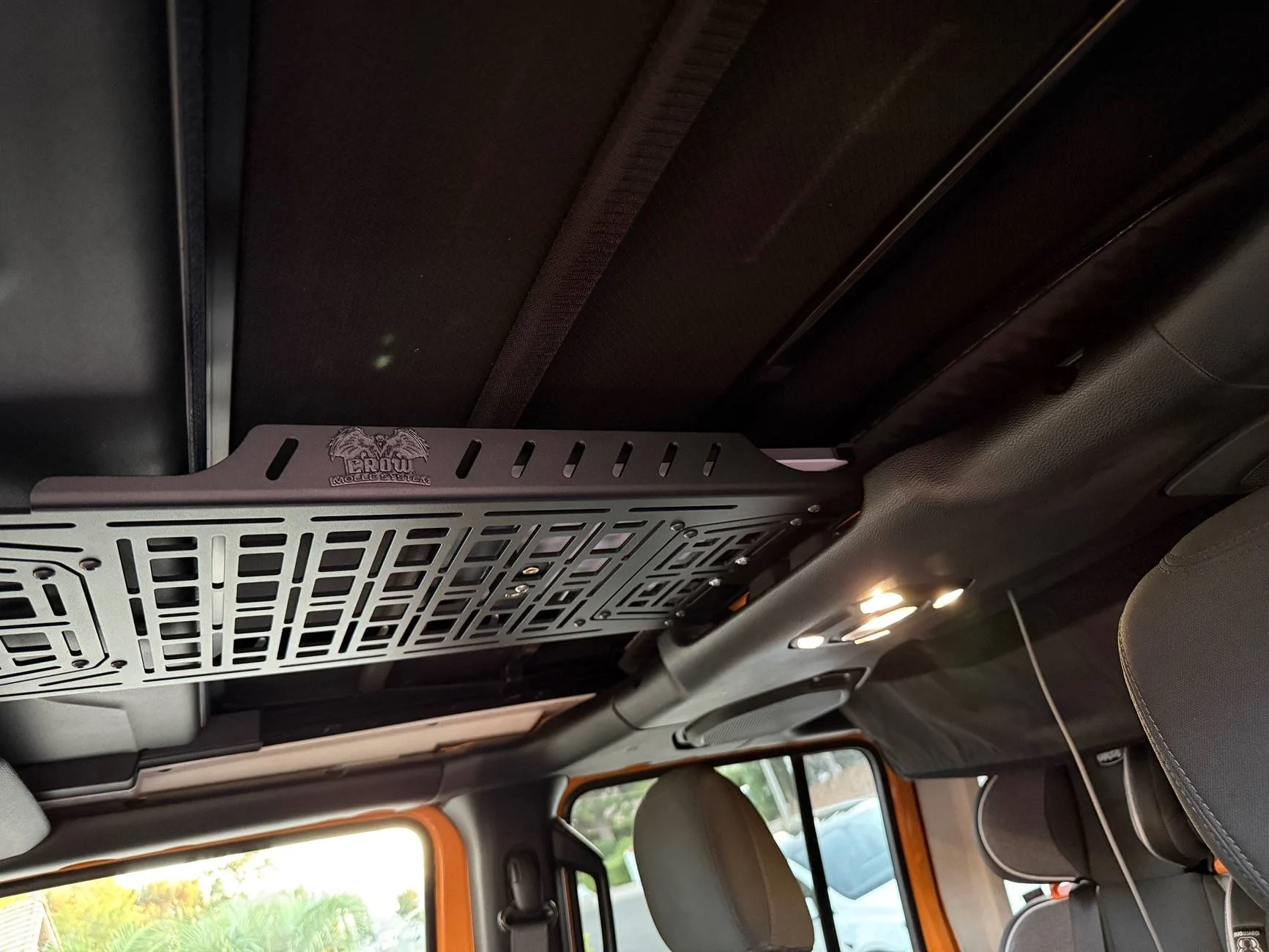

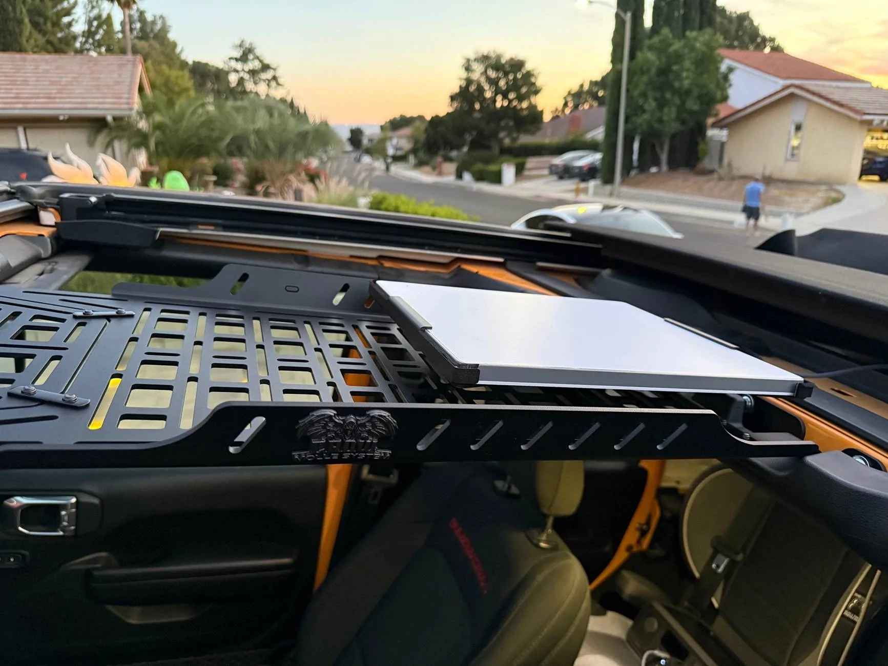

Hi All,
After a few weeks of pondering, I finally reached a point where I could share my progress on installing Starlink mini satellite dish.

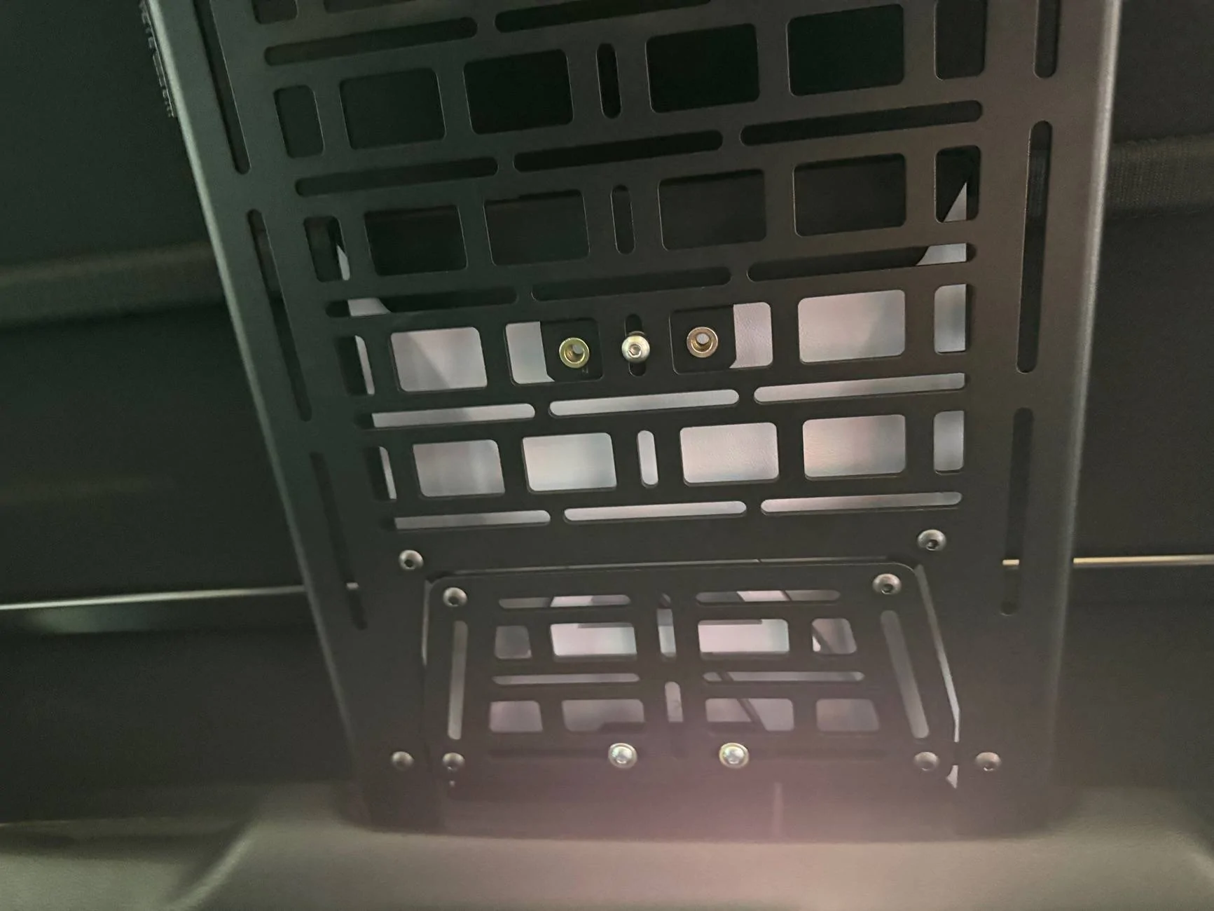

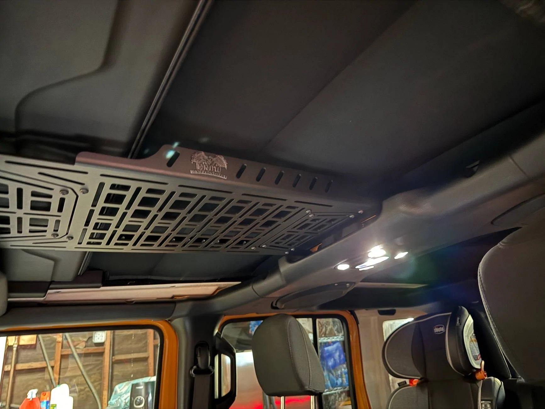

I started with the @EPIC Adventure Outfitters C.R.O.W. molle system. Then, I found a set of brackets from American Adventure Lab and made some minor modifications to securely mount the dish while maintaining enough clearance from @Hothead Headliners skyliner. Everything looked good, and it worked while the SOT top was open. But once I closed the top, it completely killed the signal. Hmm, it’s a soft top, and at least I should get some signal. After another week of research and rethinking, I finally figured out that the Hothead Headliner has aluminum foil material and it was blocking the signal. I pulled back the front half of the headliner, and voila! It worked exactly as I had hoped. There are steel bars crossing the dish, but it’s not causing any major issues. I was even able to drive around while maintaining a solid internet connection.
I just sent a message to @Hothead Headliners, hoping they can lend a hand with this.

I totally understand flat mounting is convenient but with no disrespect intended, I’m not a fan.
StarLink needs an unobstructed view of the sky which means no parking in the shade or near the canyon wall if you hate buffering, disruption of signal and packet loss.
Further, the StarLink antenna really likes being pointed in the right direction and at an angle for maximum receptivity. Hard-mounting flat means ya gotta be out in the open for functionality and even then, you’re giving up throughput due to signal loss.
A option might be to mount it if driving while streaming is your thing but have it detachable so you can portably put the antenna in the open and not your entire rig.
Cheers

The Starlink instructions say mounting it flat is fine. They only mention tilting it to prevent snow and rain buildup on the dish. Since my application is mostly covered, I don’t think it’s a big deal. Plus, if I really need an unobstructed view, I can just open the top and get it.
With this setup, I can get some connection while I’m on the road.
