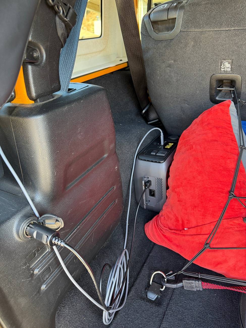

Thanks!
The EcoFlow setup is working as expected. However, the only downside is that the USB C port lacks an on/off switch in the EcoFlow app. I’ll reach out to them to see if they can add this feature as a future update.

Thanks!
I'm using the DJI 500 & 1000 and they don't have that issue.

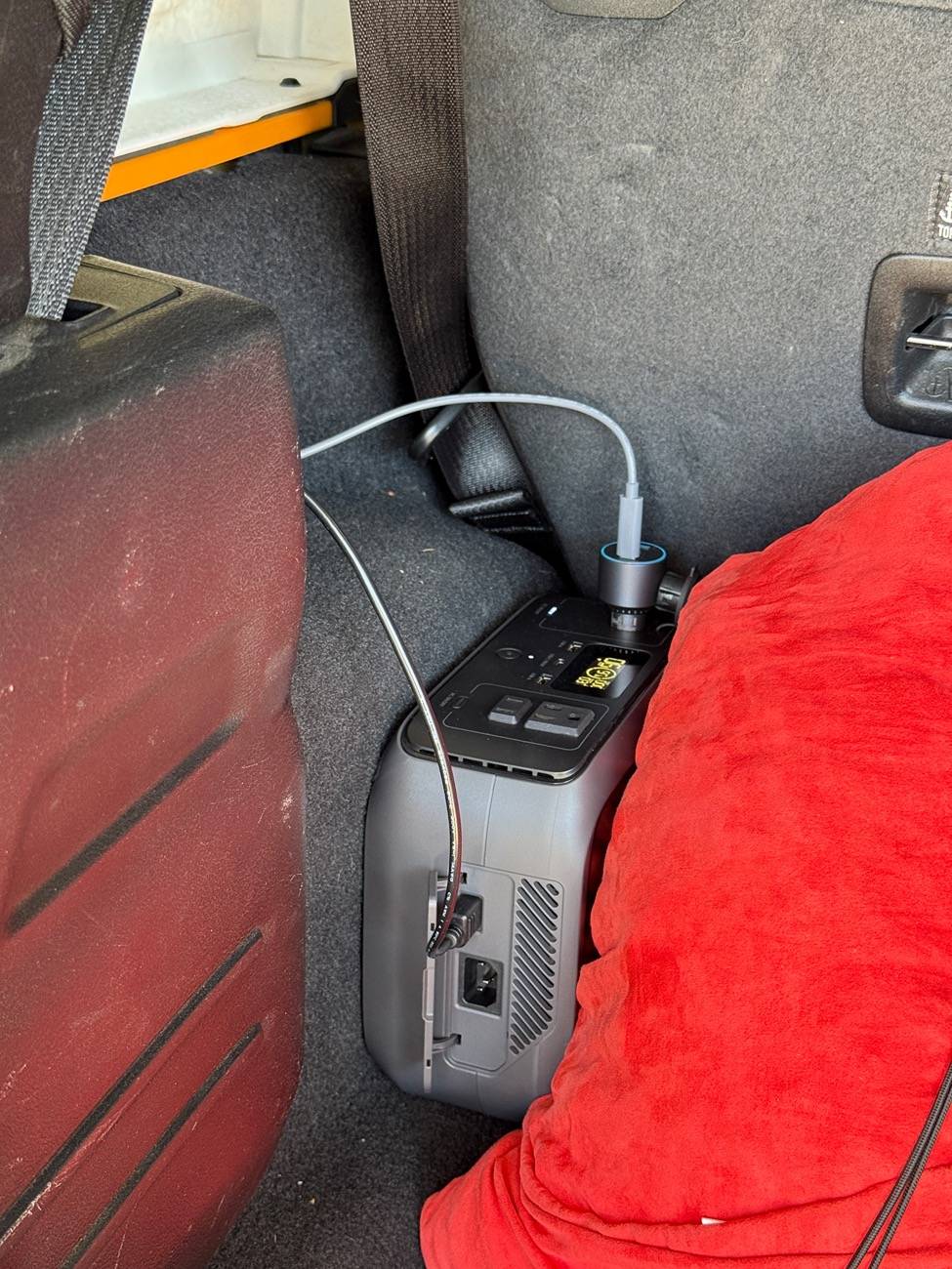

It’s interesting!
I sent a request to EcoFlow to see if they could add a USB-C port control in future updates. However, it seems that the hardware lacks the capability. So, I opted for a more affordable solution)) I added a car charger, and now I can control the 12V socket from the EcoFlow app.
