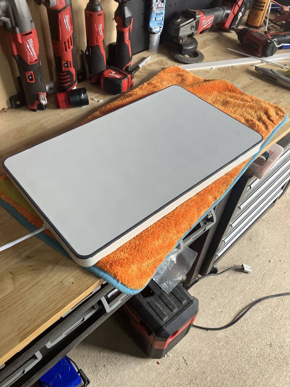

I do a fair bit of very remote traveling and have been looking for something better than a sat phone. Have been playing with starlink and I think it’s a brilliant solution.

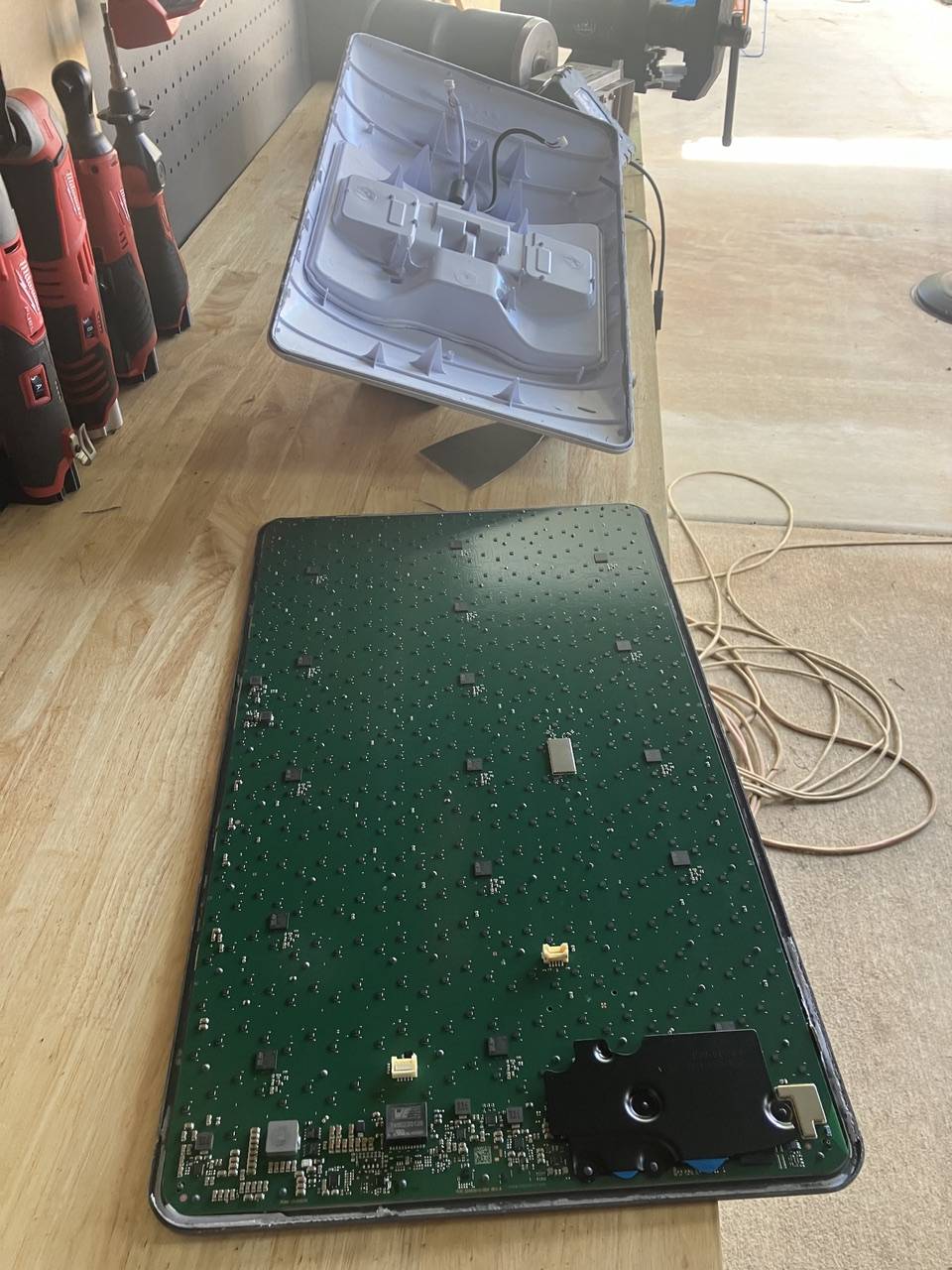

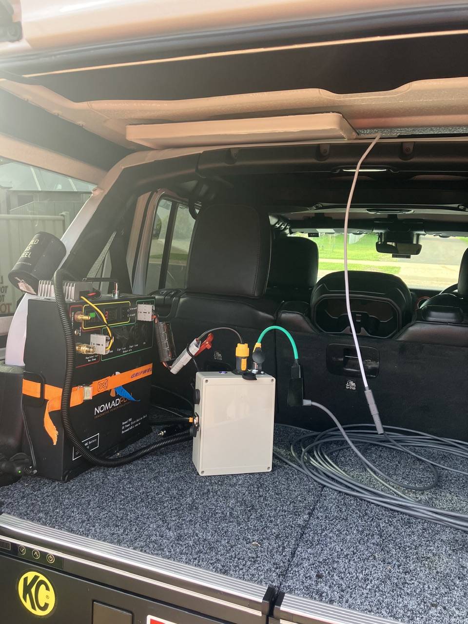

I cut the dish down to make it as small as possible and made a rough case a converted it to 12volt.
dish works fine when sitting ontop of the roll bar and punches through to roof pretty well.
now using wifi calling I have Comms anywhere.
just need to make a permanent mount for the dish.
really happy with how it’s turned out.

Which plan did you choose? Do you use it while you drive?
I am in Australia so plans are probably different.
my plan is mobile regional. To use it while driving I am supposed to turn on mobile priority which charges by MB used.

I have one for my RV, but I always thought the dish had to have a clear direct view of the sky. It can pick up the sats through the jeep top? Does it pickup through metal or just fiberglass?
shep
shep
Aug 29, 2018
71
151
Emerald, QLD, AU
2021 JLUR, 1976 LJ80
I don’t think it would work through metal.
