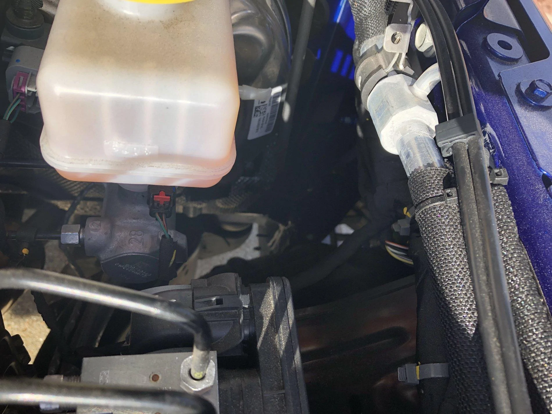

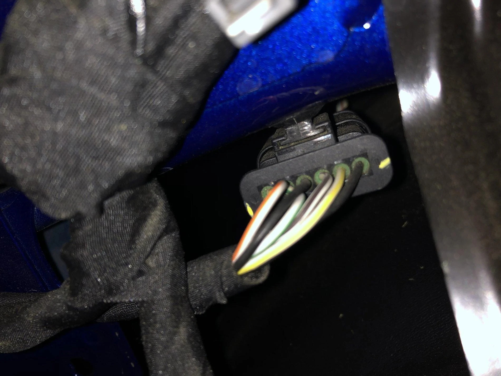

Because that's your parking lights. Check under your hood on the left side for a connector going into the fender that looks like this
freddiegs
Nov 5, 2018
166
81
DFW
2018 JLU
I tried to take a picture of it but i have the 2.0 and there is a relay box in the way on the driver side.
