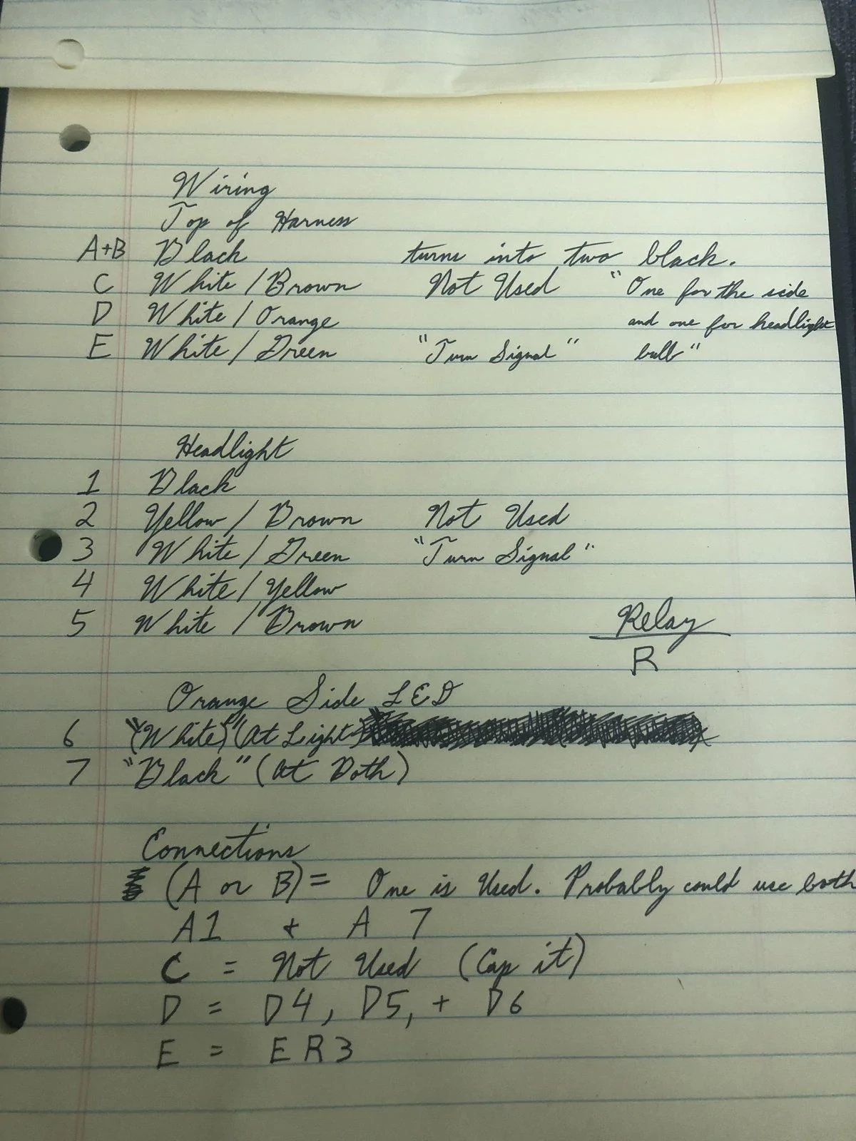

Hey John, I actually just purchased some 2nd hand Rubicon Fenders with the LED lights and I just wired everything up to work perfectly. You definitely have a little wiring to do and you have to buy a couple resistors but this is 100% doable. Still no standard daytime running lights but that was not my intention with this. I just wanted the White LED lights to work just like the "light on, marker light" anf the yellow light to function as the turn signal.I installed the led fenders on sport and the signal light error comes on atleast once a day and the turn signals stop working. Do I have to take it to the dealer to have them program it?
But with the Tazer, no wiring and everything works as it should, including DRL’s. Just saying...Hey John, I actually just purchased some 2nd hand Rubicon Fenders with the LED lights and I just wired everything up to work perfectly. You definitely have a little wiring to do and you have to buy a couple resistors but this is 100% doable. Still no standard daytime running lights but that was not my intention with this. I just wanted the White LED lights to work just like the "light on, marker light" anf the yellow light to function as the turn signal.
I will try and do a write up in the next couple days.
Oh and I did this without buying the Tazer programmer.
Very true, but only if you have the led wiring harness and then you still have to pay about $300 for the tazer. Don’t get me wrong, sounds like the tazer is really sweet but I feel like my fix is a little more old school hot rod compared to new school programming.But with the Tazer, no wiring and everything works as it should, including DRL’s. Just saying...
I’d just be worried about your warranty if they see you had wired things up. Now, with the Tazer if they”knew” you were using one they could say the same thing, i guess. What ever works for you is all that matters!Very true, but only if you have the led wiring harness and then you still have to pay about $300 for the tazer. Don’t get me wrong, sounds like the tazer is really sweet but I feel like my fix is a little more old school hot rod compared to new school programming.
I bought a set of Rubicon fenders without front harnesses because the previous owner needed it for his aftermarket fenders. I bet quite a few people will buy them this way.
And I only have $350 total in the LEDs and the fenders. Plus $15 for a set of LED relays in stock at Autozone. Another $15 for other odds and ends makes this a fix that is pretty inexpensive.
did you connect the DRL wire ( pin 5 connector) to side mark driver ( pin 1)? i did that and now the DRL works when i turn the park lights on.Hey John, I actually just purchased some 2nd hand Rubicon Fenders with the LED lights and I just wired everything up to work perfectly. You definitely have a little wiring to do and you have to buy a couple resistors but this is 100% doable. Still no standard daytime running lights but that was not my intention with this. I just wanted the White LED lights to work just like the "light on, marker light" anf the yellow light to function as the turn signal.
I can't remember what pin it was. I did everything off the colored wires. But I did. I actually hooked both white strips and the side orange LEDs up to that side Orange LED. I had the Diode Dynamics in my sport housings and loved how bright they were so I wanted to have extra light.did you connect the DRL wire ( pin 5 connector) to side mark driver ( pin 1)? i did that and now the DRL works when i turn the park lights on.
That’s what I did as welI can't remember what pin it was. I did everything off the colored wires. But I did. I actually hooked both white strips and the side orange LEDs up to that side Orange LED. I had the Diode Dynamics in my sport housings and loved how bright they were so I wanted to have extra light.
And I have my turn signal where it jumps back and forth from the white to the main orange strip when the headlights are on and just the orange flashes when the headlights are off.
