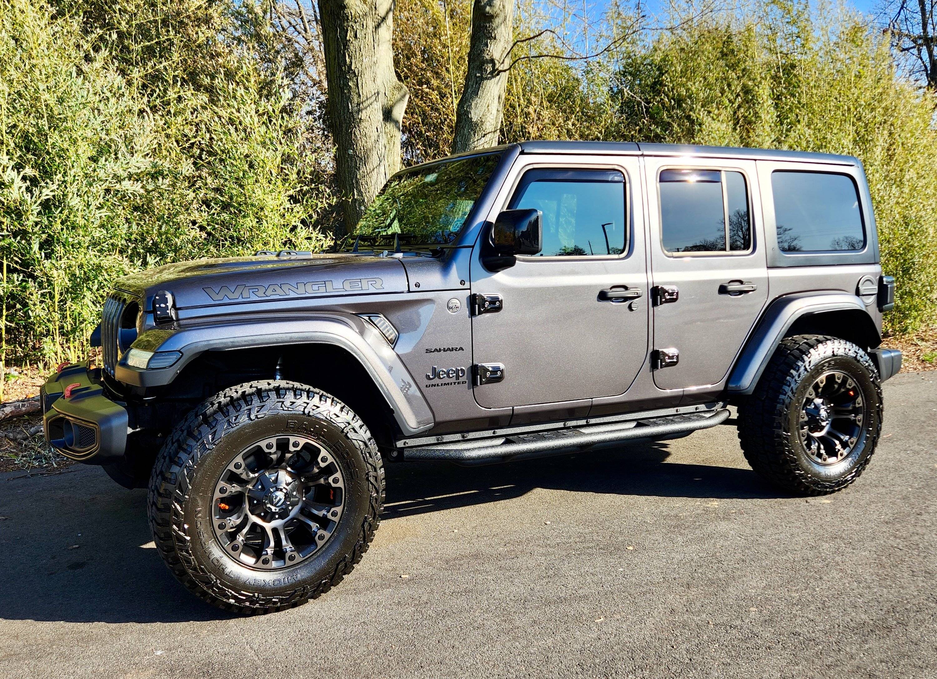

Hey everyone! New member with my first question.
I own an ‘18 Wrangler Sahara and will be adding pre-runner lights. I’d like the to come on with the headlights so I figure a simple fuse box tap will do the trick. However, the PDC is not clear on which fuse it is.
Before I unplug fuses to see what doesn’t turn on, figured I would poll the group here.
Thanks in advance for the help. ??
Jeep Wrangler JL Adding Pre-Runner Lights 7E50F07C-F224-4844-82F4-97D09F1446BF
