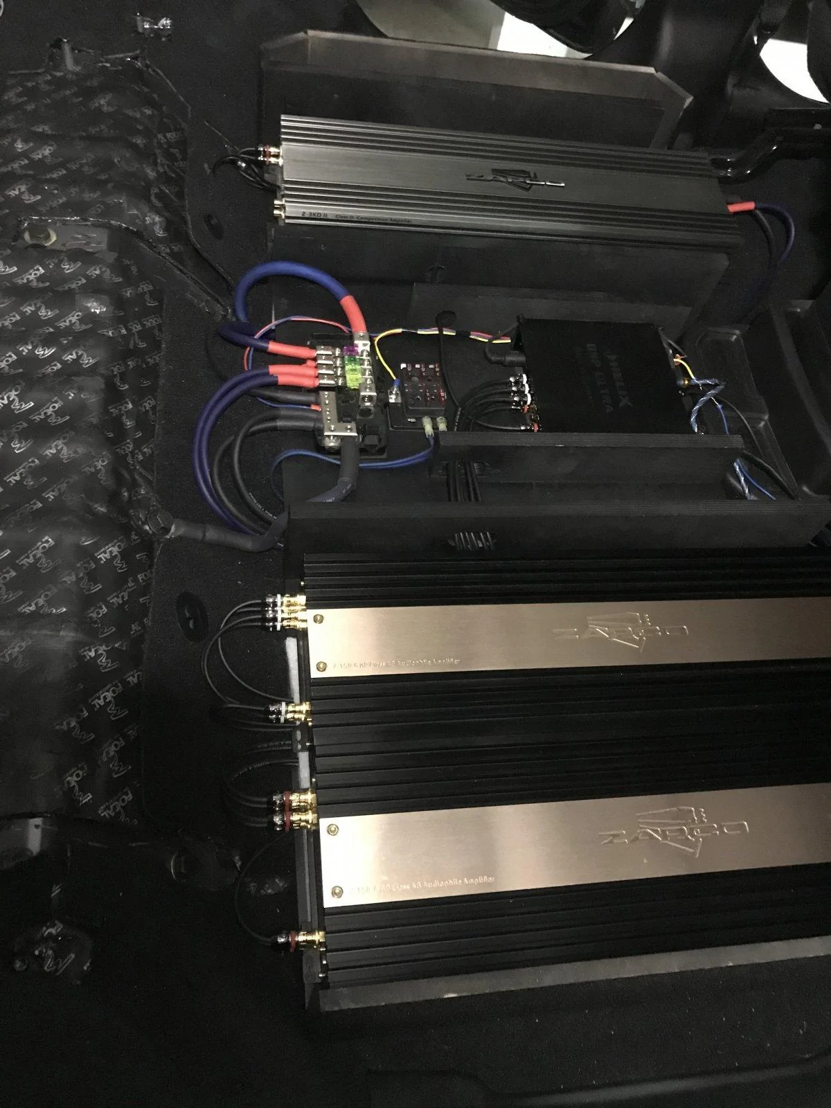

yup i use the toslink from pac to my helix ultra. as well digital coax for my fiio m11
