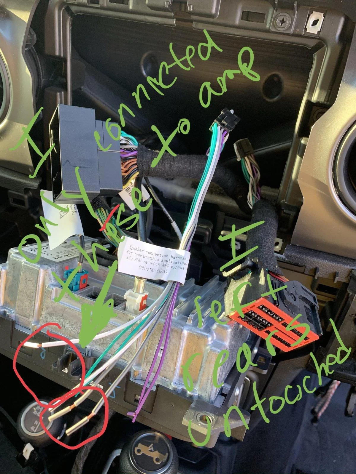

Guys, I installed everything and my Kicker IQ1000.5 has the “Under Voltage” Light on and I get no sound. I’m using the PAC R2 adapter for non amplified systems. I only did RCA’s for the Front and Sub. Would that be it?
With the Pac did you flip the 4th dip switch? You have to do two sleep cycles. Roll up the windows and lock the car. Leave it for 5 minutes. Turn it on and then repeat.
Dip switches are correct.I have manual windows. I turned everything off. Came inside and went back to turn on and did again. I wonder if it’s because I didn't connect the rears speaker wires on that harness with 4 sets of speaker wires.
Since it is a 5 channel amp I would probably run the rear speakers and rear RCAs even if you are using the stick speakers.
could also be a bad ground. Not exactly sure. Haven’t done a whole lot of installs.
Got it. You know what it was? Rookie electrical mistake. The screw holding fuse was not all the way down so it was t make good contact.
