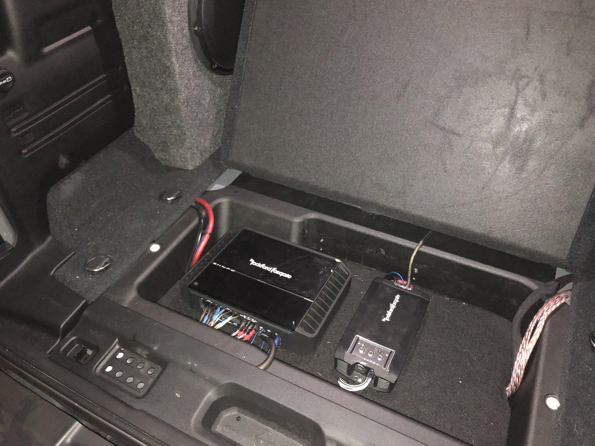

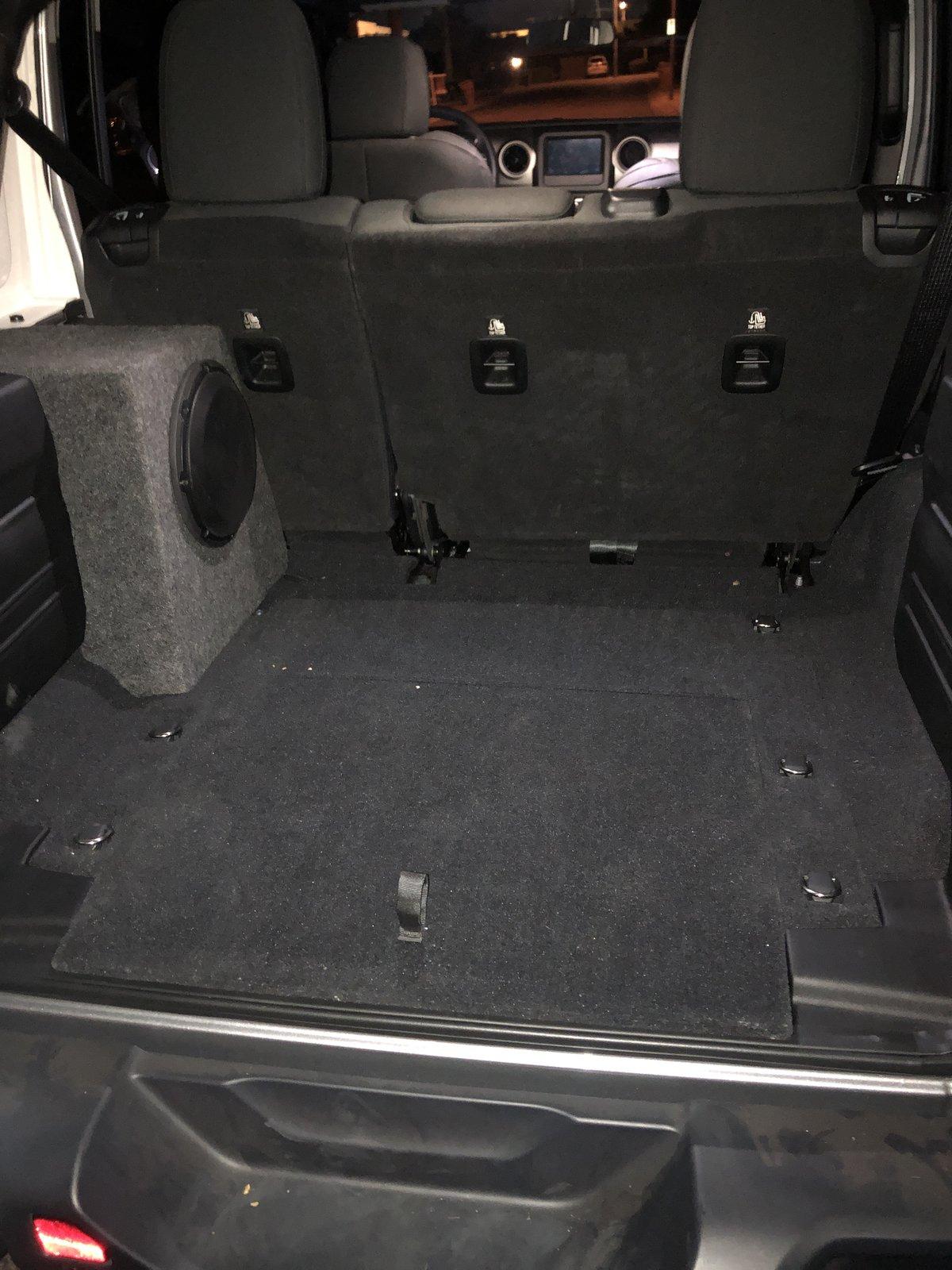

Got my install complete.
PAC Amppro R2
JL 10w3 in custom box
Rockford Punch P400x
Rockford t750x1bd
Focal ISN100 4” component set
Still waiting for the rear speakers
Audison 4” AP4
JL 3.5 C2

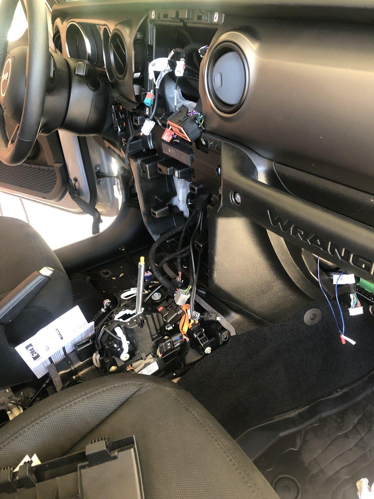

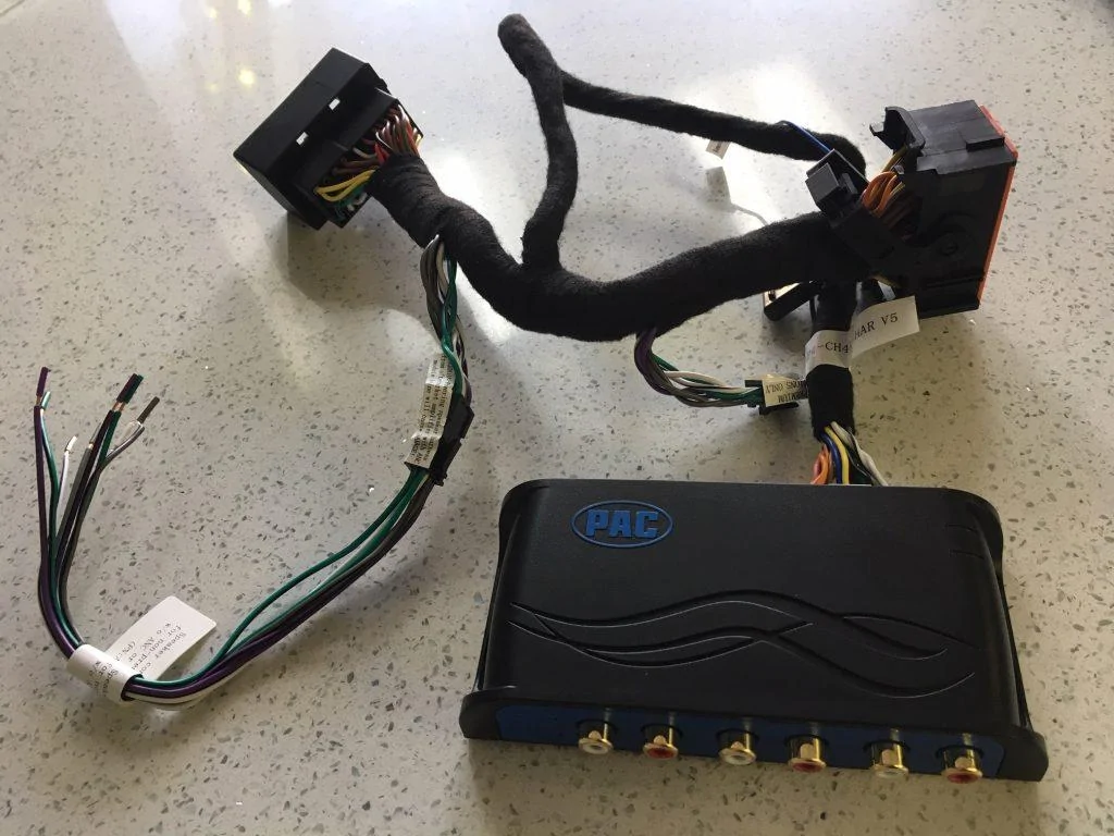

Install was pretty straightforward with the Pac Amppro. Take apart the dash plug in the harness. Run speaker wire and RCAs to amp. Hook up power and ground. The pac Amppro also has a pig tail harness so running wires was a breeze and tapping or splicing required. Just used butt connectors and lots of speaker wire. Also has a dedicated remote turn on and bass knob for sub RCA output.
I ended up putting the rca box in behind the glovebox since that was the only spot it could fit. Ran all the wiring underneath the seat. Had to take out the center console but that wasn’t too bad. One of the plugs underneath the seat is a complete bitch to unplug. But other than smooth sailing. Also I’ve probably done 3 installs and never a 4 channel. So I’m not a pro by any means.
Sounds pretty good. Overall I’m happy with the sound. I’m sure it will get a little better upgrading the rear speakers from the stocks.

Nice. So the speaker wires that go to amp connect to the added pigtail you connect to PAC right?

White is LF. Grey is RF. Green is LR. Purple is RR
To do that you’d probably have to run new wires directly to the amp. I’m not sure how you can individual speakers to the amp and not the whole channel.

Thanks. I think I got it. BTW love your sub box. Did you make it or you had someone do it? I'm going to try and tackle something exactly like that with 3/4" MDF and use my shallow mount JL Audio 10".

A guy i know did it. He fiberglassed the rear so there are a lot of contours and then did the wood frame.
