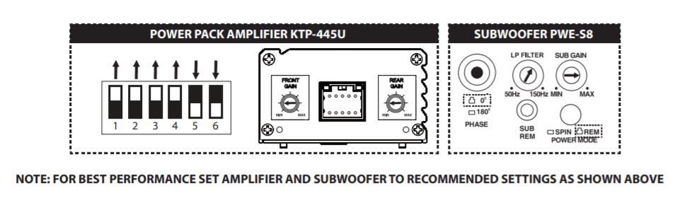

Before you install anything else, I'd recommend you check to see if the alpine sub has a gain control. I've installed several powered subwoofers and they all seemed to have a gain control. The image below shows what it should look like. Just turn the gain down, then tweak from there.There are too many smart people in this thread, and I am hoping one or more of you can give me some advice. I have the 7” non-alpine, and added the alpine pss sub and amp (used, great price, and plug and play were the main reasons). But, as weird as it sounds, it’s too loud. Turning the volume up to 7-8 is ridiculous, and I actually like things loud. I am trying to find options to modulate this a bit. I have Rockford fosgate dsr that I planned to install. It isn’t necessarily as easy as I thought it may be, so before I take this on, I had a couple questions:
