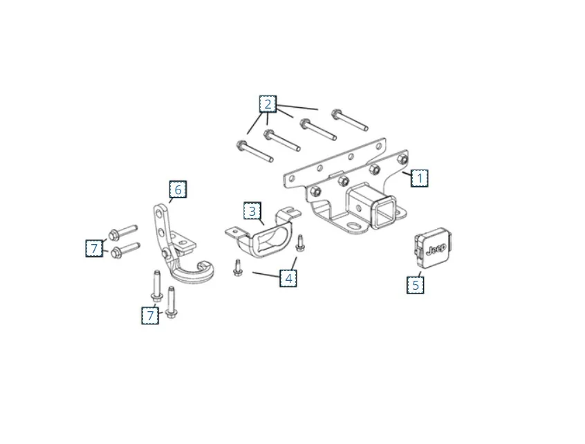

While I still owned my 2019 I purchased an add on hitch from Quadratec, was going to put it on, but it didn't come with the hardware. Multiple searches of my local hardware, farm stores and a dealership have not allowed me to find the fine thread bolts that are long enough to engage the nuts welded to the hitch . An email sent to Quadratec has gone unanswered as far as I can tell and the only time I think about calling them is about this time in the morning. 0403.
Anyone have suggestions or a part number. The youngsters at the dealership were less than helpful. Of course it's not the same dealer as the purchase. I forgot again when I was there. Maybe next week I'll check there.

If you provide the diameter, thread pitch, and length needed, it would go a long way toward any help you might receive.

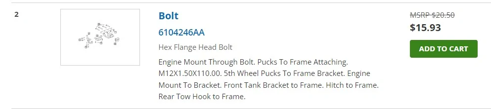

I'm surprised that the parts dept at the dealership couldn't find the bolts.
IF this is a Mopar hitch, we are discussing, the parts are shown below.
Jeep Wrangler JL Add on Hitch mopar hitch
Jeep Wrangler JL Add on Hitch hitch bolts
