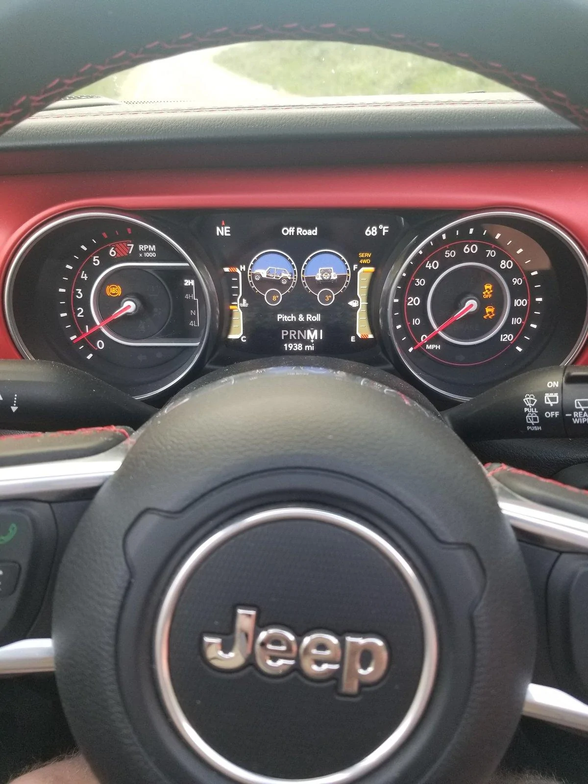

IdahoJOAT
May 12, 2020
38
860
989
Caldwell, ID
2021 JLURe Tuscadero, Black '05 Silverado
Had this happen just now.
Bought it May 9th.
Very washboard road.
Jeep Wrangler JL Abs/traction control light 20200603_200407
