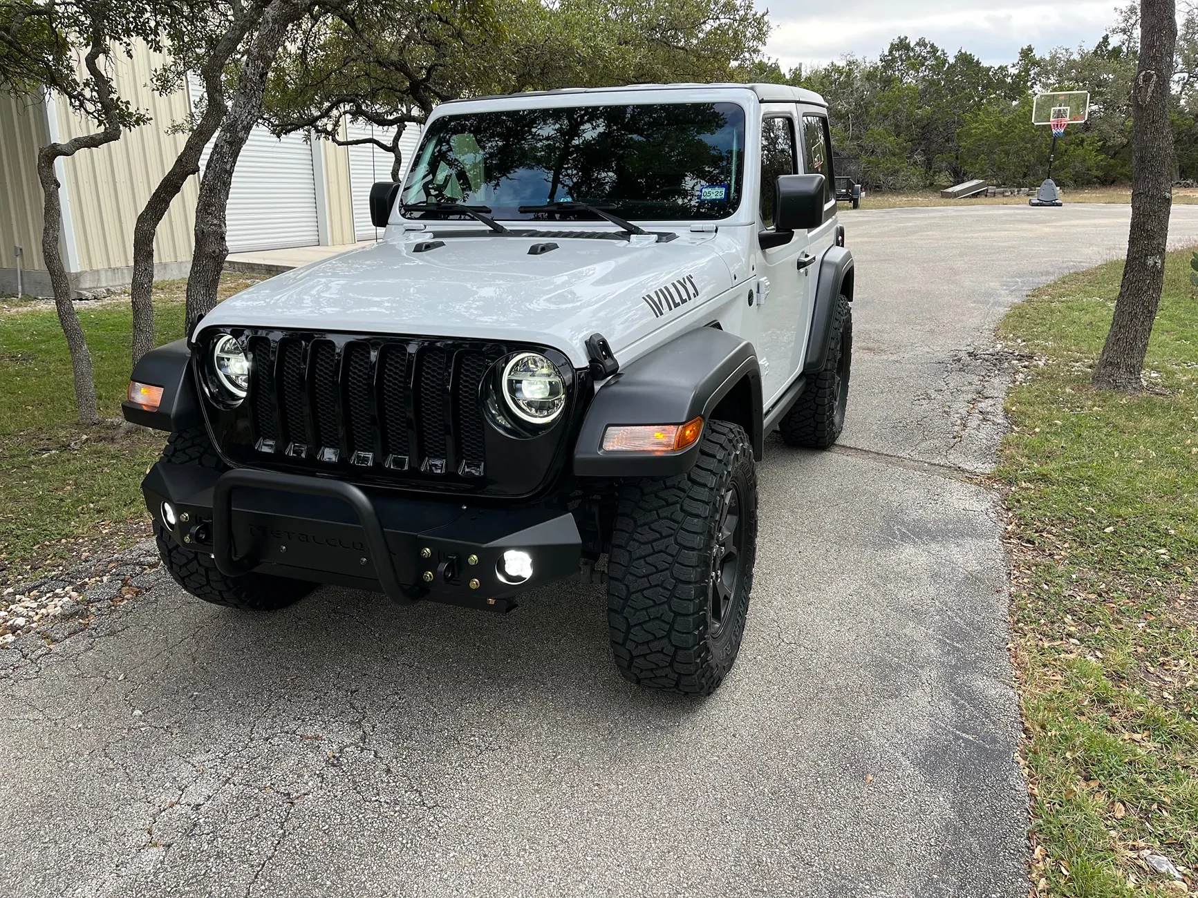

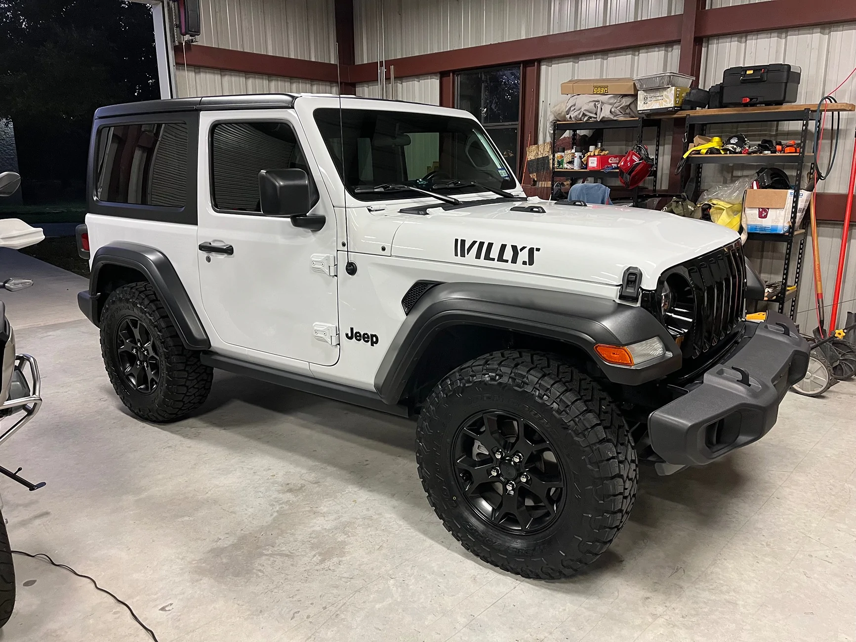

Yes, slightly larger tire
Your Sport S came with 255/75R17 tires, 32.2” tall. I would suggest 285/70R17 at 32.8” tall, as your slightly larger option. The height difference will add about 1/4” to your stance. They will fit with no further need to modify the Jeep.
Mine for perspective. It came with 255/75/17s. The tires shown are 285/70R17C Toyo Open Country RT Trails. More aggressive and noisy than you would probably want. But like a luxury ride compared to the Firestone MTs that is came with.
Pardon the shiny tires. This was the day they were installed. I would never do that on purpose. :LOL:
