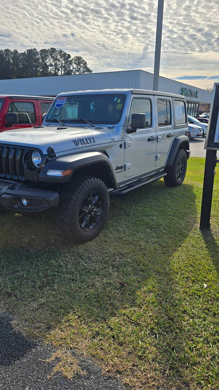

Is it possible to keep the oem wheels from my 2022 willys sport. I'm looking to get a little bit wider stance and to fill in the space around the tires. I currently have 255-75-17. Or is it best to replace the wheels and tires to achieve the wider stance

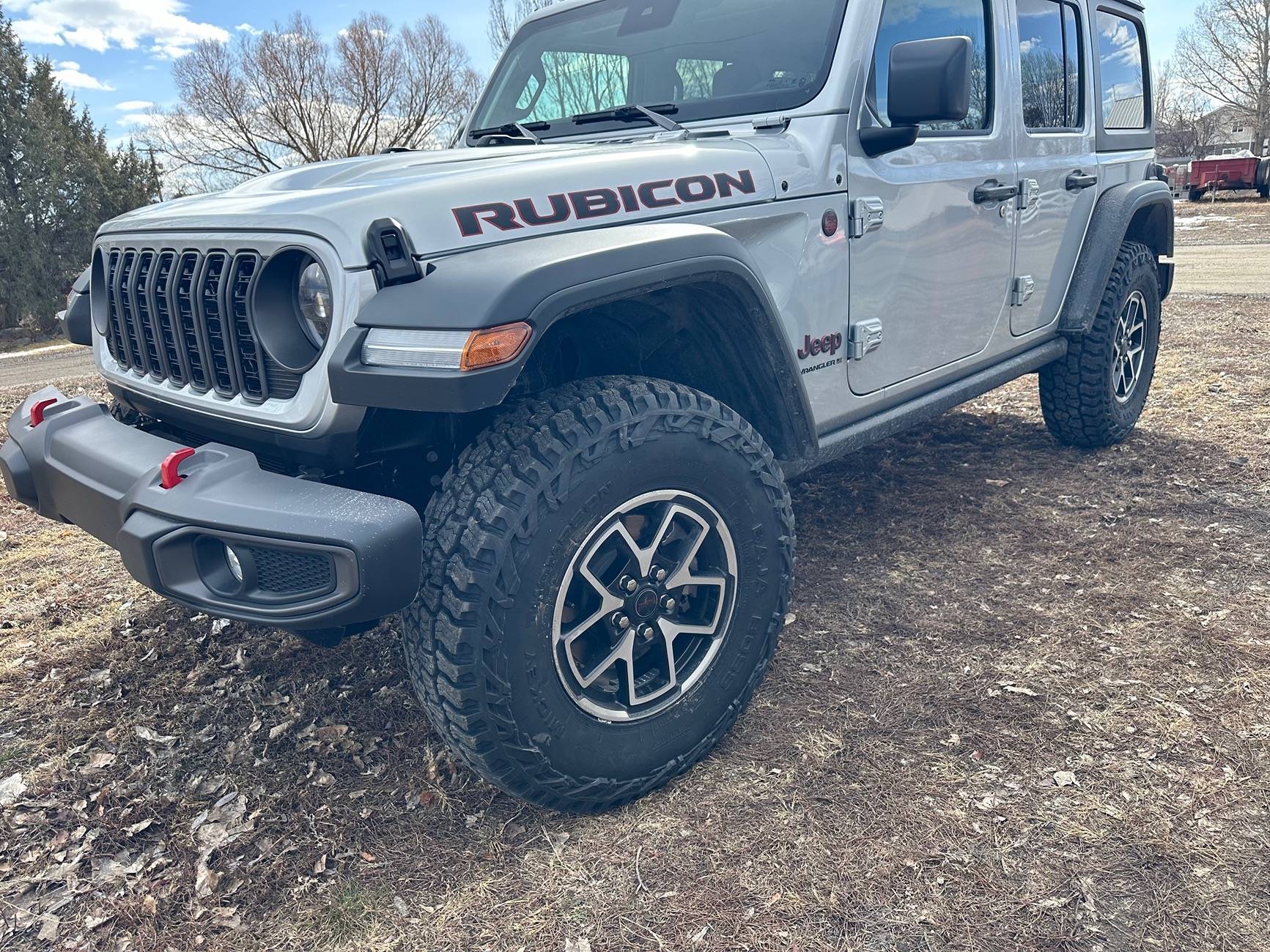

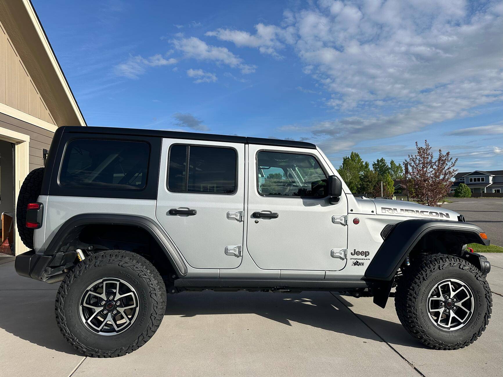

those wheels work with 285/70-17 and if you want a little wider stance 1" wheel adaptors from BORA work perfectly. I run them with 255/85-17's. top is without spacers and bottom with.
