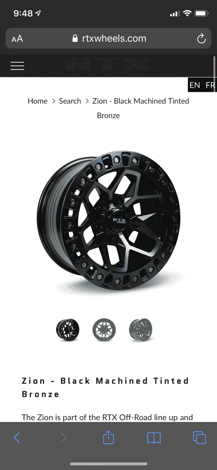

Plan to get a set of RTX Zion bronze 17x9,
My question is:
1. Will -15 offset perfect fit with no lift? Or should I go for 0 offset? (Prefer negative offset for the aggressive look)
2. Since wheels are in bronze colour, is it ok to use in winter??
For tires, should I go for 295/70/17 or 305/70/17?? (Again, with no lift)
Thx for any advise!!

Welcome to your new addiction! What is the backspacing on the wheels? It's very important to know that in addition to the -15 offset. Then we can provide advice for question #1.
#2, you're fine, just try to wash off salt as soon as possible.
Regarding tire size, if you do not have a Rubicon, and do not want to lift your Jeep, you should go with 33 inch tires. While you may be able to fit 35s (again, not a Rubicon), but it would be very close to the fenders. If you have a Rubicon, you can easily fit 35s with no lift.

1. Backspacing is 4.5
For tires, 33 inch was a bit smaller. Maybe I will go for 295 tire since it’s bigger than 33s but smaller than 35s. Am I correct??
Btw, its not a Rubi.

295 tire would be perfect. My KMCs had the same specs as your wheels. They will look great as well. Check out my build thread to see pics. Happy modding!!
