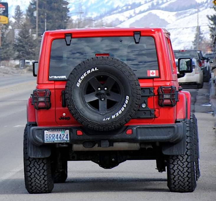

Wheel offset matters. 17x9 wheels are likely going to poke past your fenders. All of that extra width has to go somewhere; usually outward.
My wheels are 17x8.5, 5.2-inch b.s.; my 35x12.5 tires poke about 1+ inch.

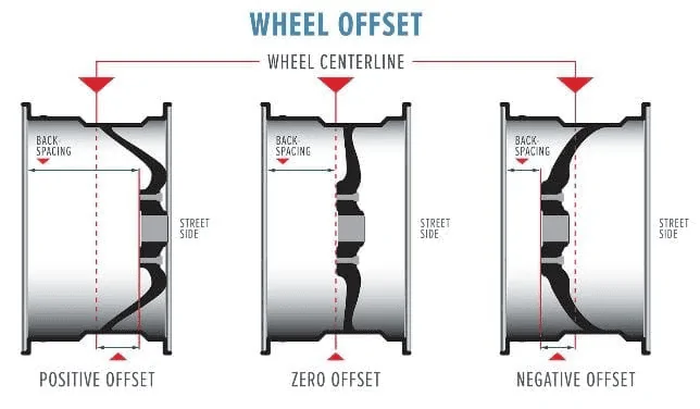

@Discount Tire can help you a lot when it comes to your tire sizes and recommended limits with different wheel sizes.
As far as keeping it in the wheel well, tire and wheel width is one thing but the wheel offset/backspacing is another thing to consider.

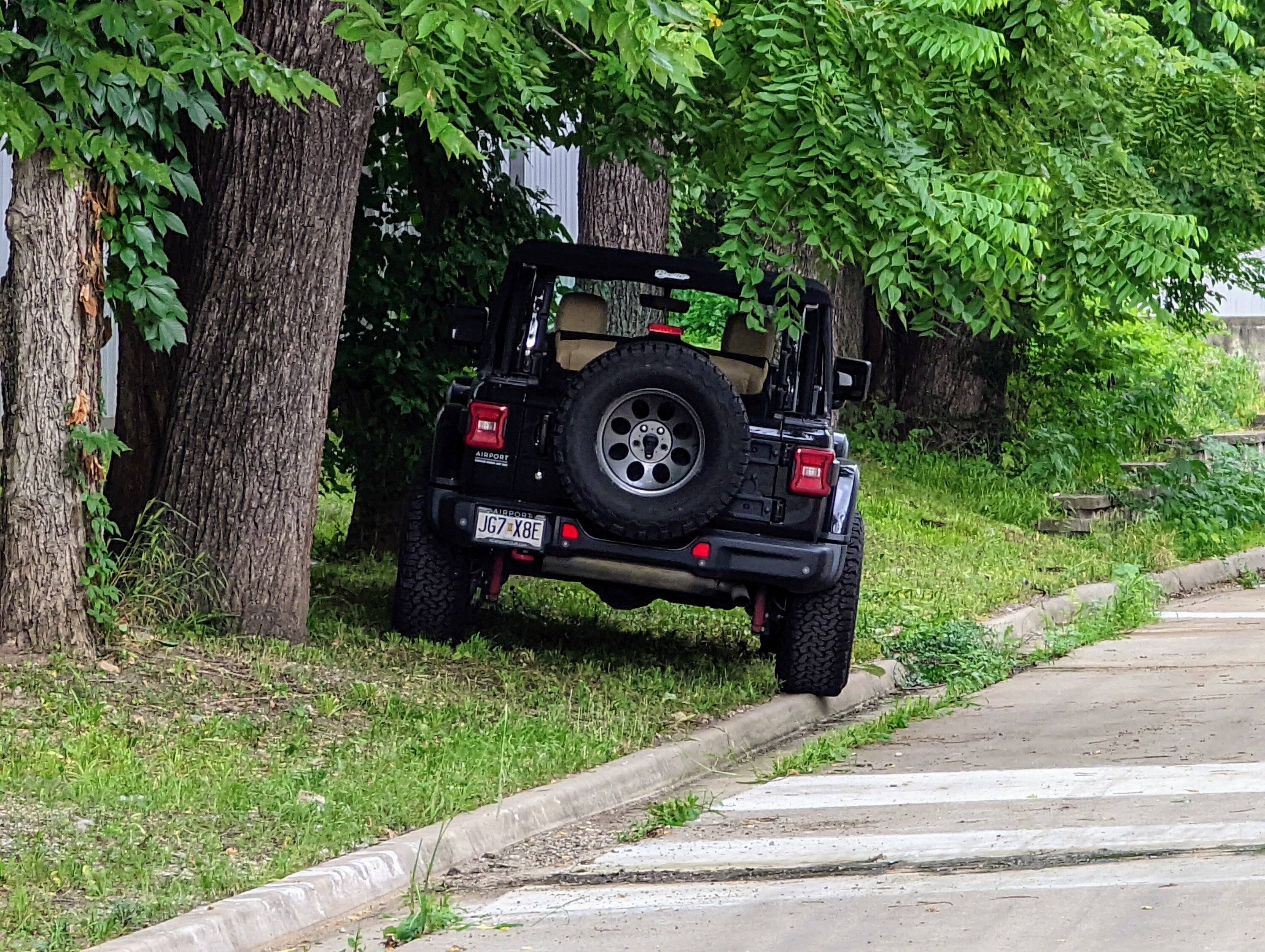

17x9 w/-6 offset or 4.75" backspacing and 12.5" tire for comparison with the above pics. A little more poke. Only straight on shot I could find happened to be a day we had a pop up storm roll in and I didn't have my windows with me so I stuck the Jeep under some trees behind my work lol.

I’m fine with the going past my fender, I like the look. Do I need to adjust the b. S. myself? I know my tires are 33” x ?? How do I know the width like your 35”x12.5”
No, the backspacing is the wheel offset; it is fixed.
For instance, the OE wheels are 17x7.5, with 6.2 inches of backspacing. My guess is your 17x9 wheels have 4.5 inches or 3.75 inches of backspacing. So they are pushed farther out.
Your 285 tires are 285 mm wide. 285/70R17 tires measure 32.7 x 11.2 inches.

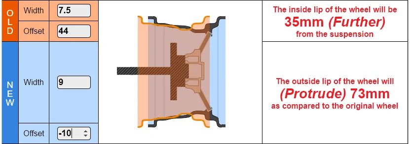

Aside from the wheel diameter to ensure the tire will work. There are 2 really important numbers to look at with a wheel. The first is the wheel width. This is universal and straight forward, however when visualizing fitment keep in mind that half of the wheel is in front of the mounting pad and the other half is behind it. So when you look at a 7" wheel and compare it to a 9" wheel, remember that although the 9" wheel is 2" wider, it is only going to move 1" out on each side of the mounting pad (roughly).
The next very important number is the offset, (sometimes listed as backspacing) This will tell you where in the barrel of the wheel is the mounting pad. KAh.mun.rah posted a great visual for this. Offset and backspace are 2 ways to describe the exact same thing, just measured differently.
For example, if you were to consider a 17x9 with a -10 offset. If you were to put a tape measure on the outside lip of your stock wheel and measure out 2 7/8", this is where the outside lip of the 17x9 wheel would sit.
Jeep Wrangler JL Wheels and tires question 1661376810684
Yes, there is an acceptable range for tire to wheel fitment that is considered safe.
