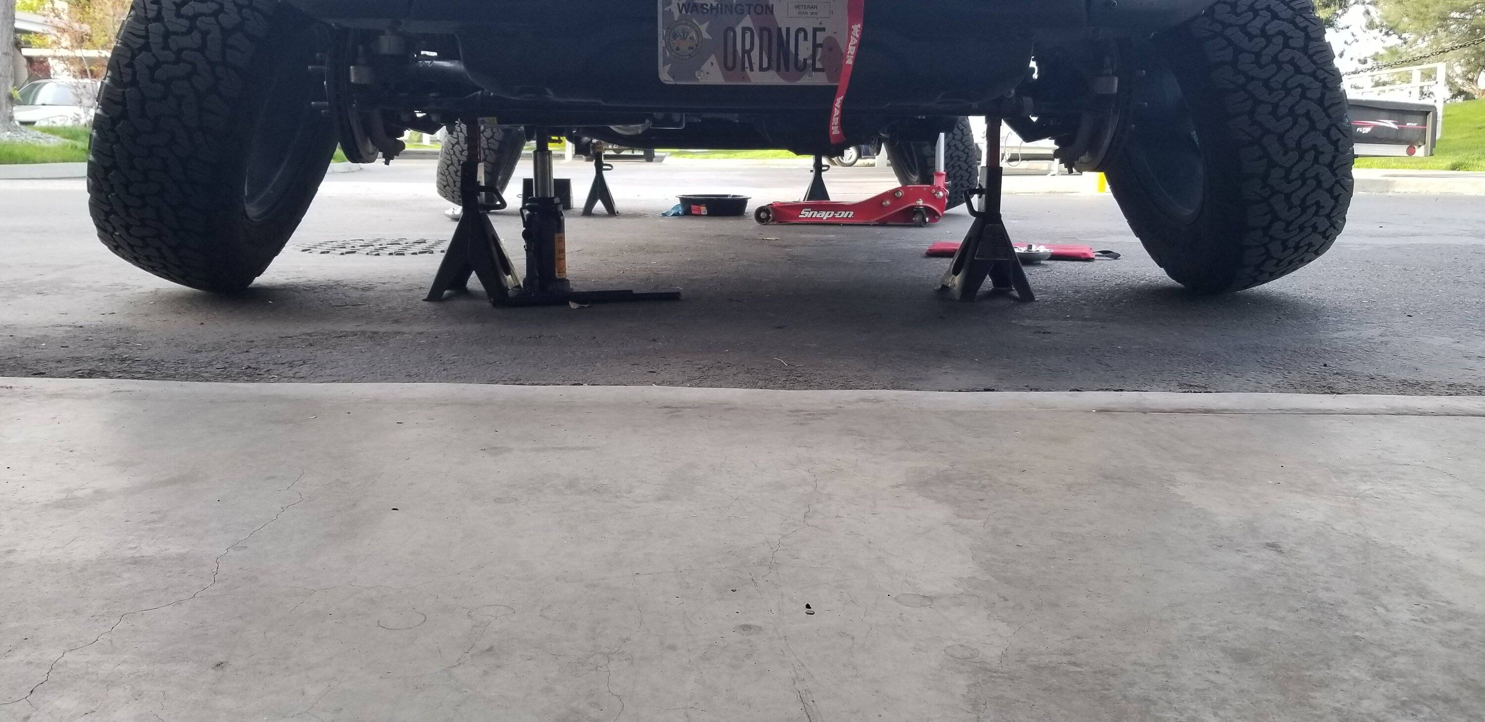

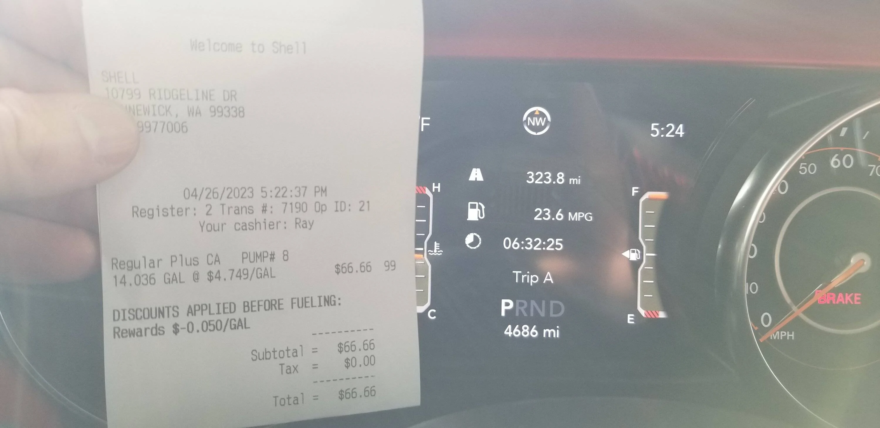

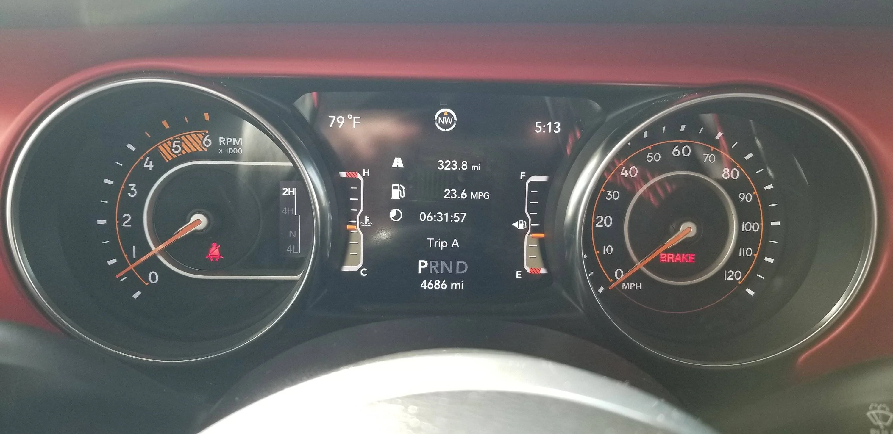

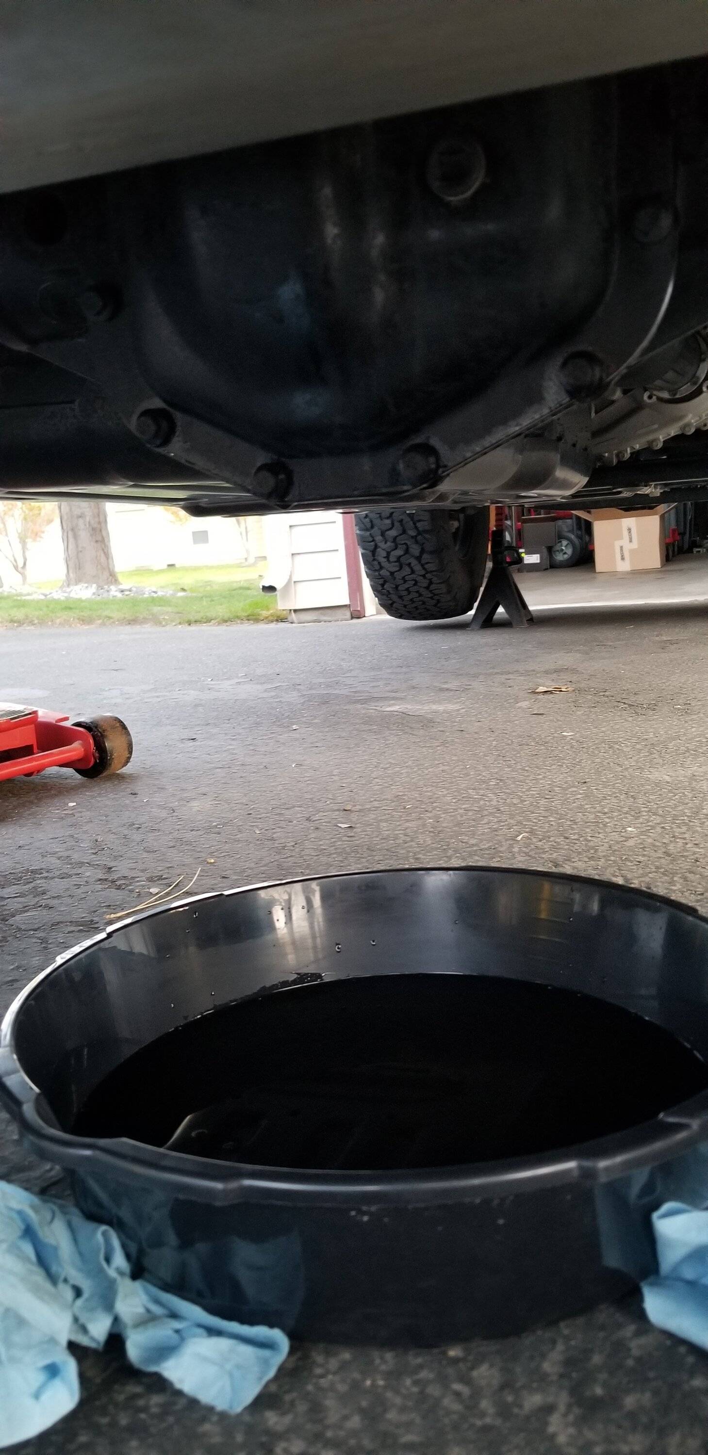

Did my first tire rotation this evening. 4,688 miles. I noticed the rear were wearing uneven and a lot faster than the fronts. All were set at 37 PSI cold. I've dropped that down to 35 PSI all around. Rear diff fluid was also changed. Factory fill was dark and shiny and the fill plug had quite a bit of metal. Used AMSOIL 75W-140 and it took 1.5 pouches. Anyone else's fuel gauge off this much? Below are some pictures.

That's weird for an EcoDiesel. Sounds like something in your fuel pump in your fuel tank is a little bit wonky. That's definitely way more than a little less than half a tank.
I know there's always a lot of metal flakes in the first changes in your diff fluid and engine oil fluid. Something about that initial factory wear. If you continue seeing lots of metal flakes in future changes, then I would definitely take it back to the dealership and get that shit fixed!
