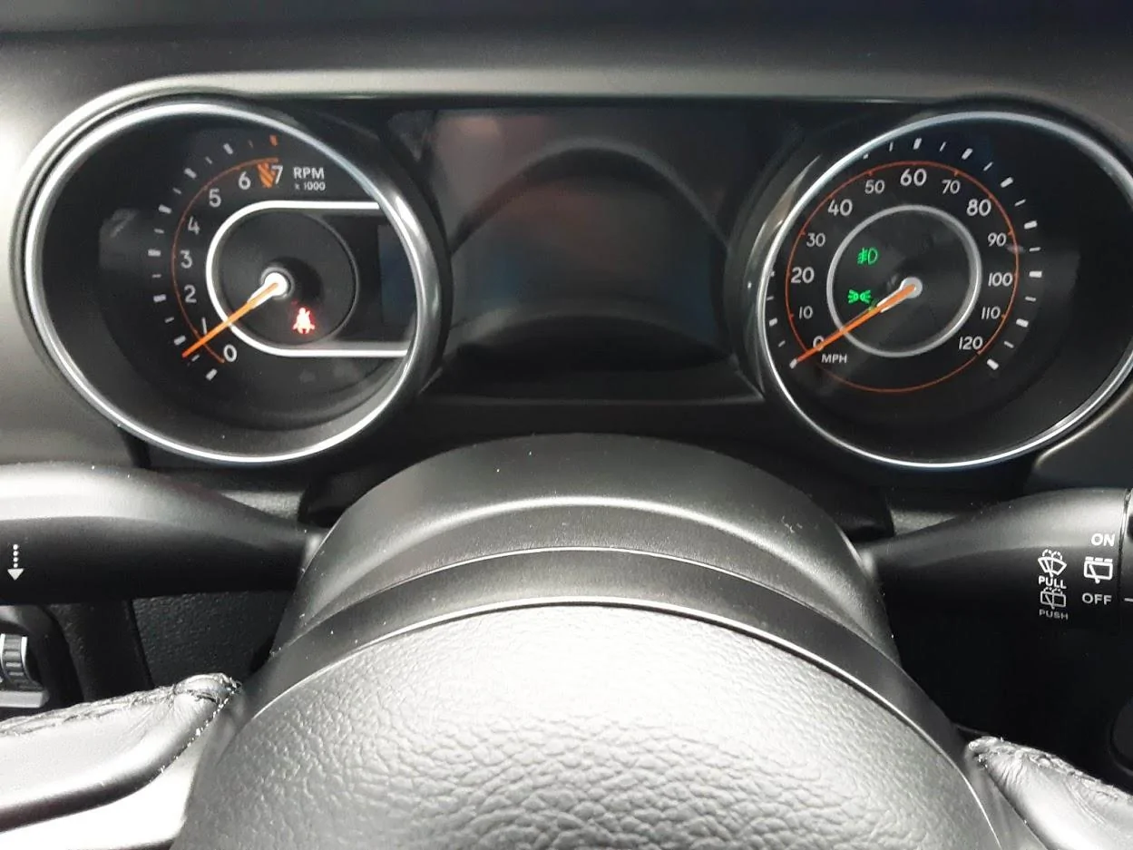

Anyone else have this happen? Center section of the cluster never came on at startup yesterday. It stayed out while driving. The next time I completely shutdown everything and restarted it was back to normal. This was not a dimming of the lights. The center section was completely out. Hopefully tomorrows software update for the 999999 issue resolves this as well.
Jeep Wrangler JL 999999 Odometer fT-o63ma_K_CPnXVj25lXPi78cNiPnKqDVrO3j3iars9TiJ-3a6JJnZc0E7MMXDYdPfMefQT0ko6u4w7n4=w1250-h937
Shots
Winchell
Jul 6, 2018
2,108
2,805
Ohio
'22 Rubicon
No, that's a new one.
