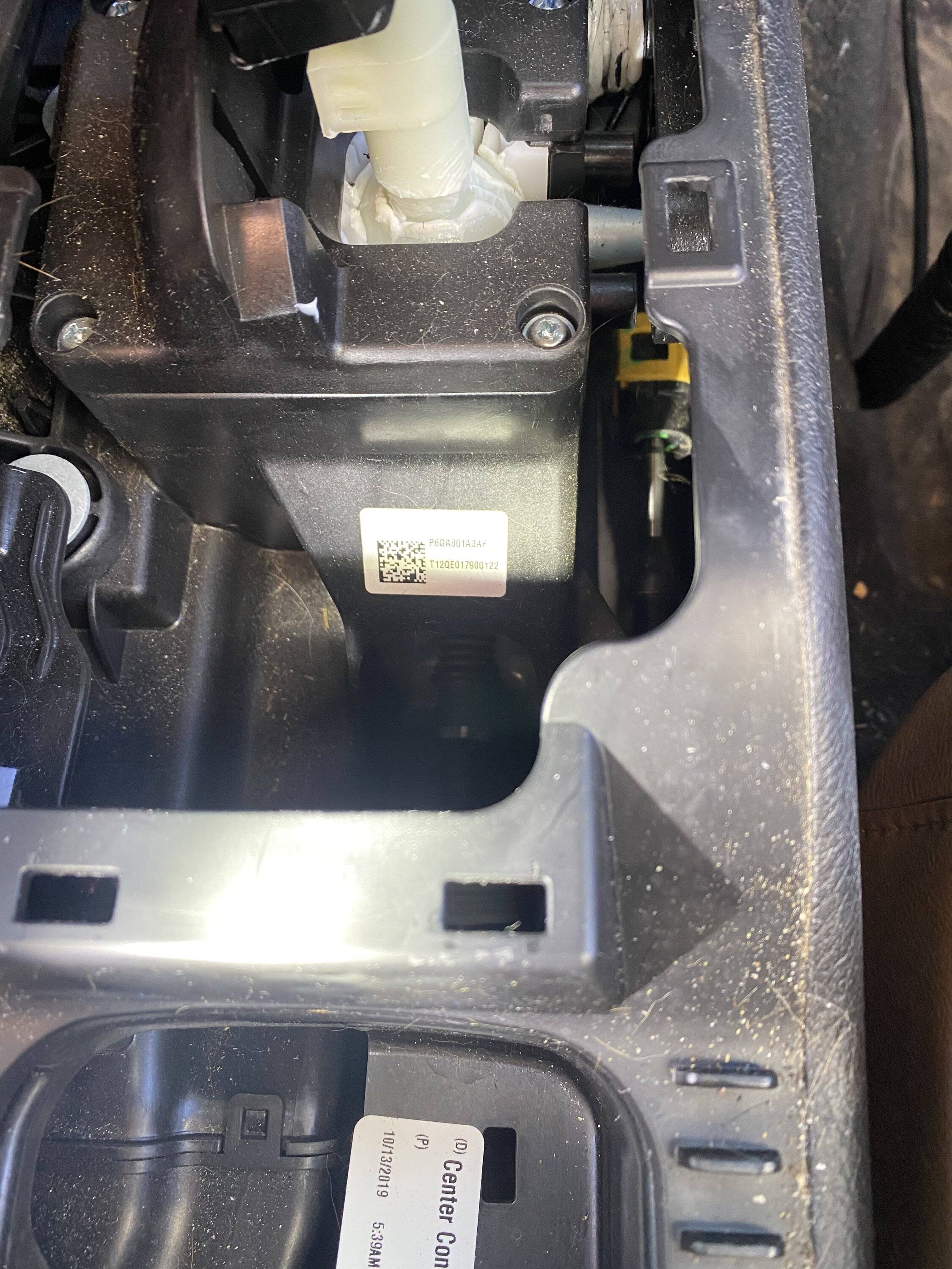

@Willing&Able - did you ever confirm what the issue was and get it resolved? I just had the Centerforce II put in my 2020 JLU and when I went to pick it up from the shop it has similar issues. It’s like the shifter is misaligned. Where 1st is there’s now 3rd, where second is there’s now 4th, where 3rd should be there’s 5th, etc. Basically the entire shifter has shifted left. And so 1st is nom existent. The only way to get it into 1st now is to pull up like you’re going into R but then you have to really nurse it to find 1st between R and 3rd. It’s like a hairline difference and you miss it.

That’s an adjustment issue of the cable shifter mechanism.

As Gregj said, yup, the shop accidentally moved the shift alignment. There is a procedure to align it. I've done it but it's been a while and I don't recall the steps

Thanks all for your input on this. Update: I stopped by the shop and they showed me that the shifter cables appear to be out of alignment. You can partially see this in the photo, but it’s tough to see. So I called Centerforce and they said during their R&D they didn’t remove the tranny when putting the clutch in but they’d heard some people had issues with the cables after doing so. Pretty sure that’s what happened with my install. Centerforce sent me the attached procedure they got their hands on from Mopar for adjusting the cables. Seems to be a fairly simple fix. Posting these instructions here for others who might need them. Will provide an update on whether this fixes my issue, which it appears it should.

Will do! Latest from the shop is that they were able to follow the instructions I sent them and while they’ve been adjusting the cables they still cannot get the shifter to line up properly. It’s actually resting over the plastic lip that you ā€œhopā€ over by pulling up the collar to put it in reverse. I’m gonna swing by tomorrow and see if I can get some more pics of it. Nothing seems broken or malfunctioning it’s just that it’s not aligned. This shop (Folbeck 4x4 in Reno NV) has been here in town since 1978 has a great reputation and the guy who did the install has been there for 30 years. It’s just their first JL and seems a bit of a learning curve. I hope with continued adjustments they get it right.

Update: Good news, the instructions I provided to adjust the shifter cables worked! Copying in the my recap that I posted under another thread here for reference. Good luck @Willing&Able - I hope the instructions I uploaded work for your issue as well.
I just picked my 2020 JLUR from the shop and it drives flawlessly with the Centerforce II installed. The clutch feels a thousand times better than the factory clutch and that annoying whirring sound you get when shifting (rev hang I think) is gone! The pedal is much stiffer to my liking and feels like an actual manual. The entire setup feels much more substantial. This is my 3rd clutch in this vehicle (the first two were factory clutches) and I have just under 35k total mileage on it. I sincerely hope the CF II lasts at least 80-100k miles.
The shop told me they had to spend some time with the adjustments on the cables and after taking them farther than they initially did it corrected the alignment issue that popped up after they did the CF II clutch install. For anyone else with shifter alignment issues like this after the clutch install, you can scroll up for the instructions that I posted in an earlier reply.
