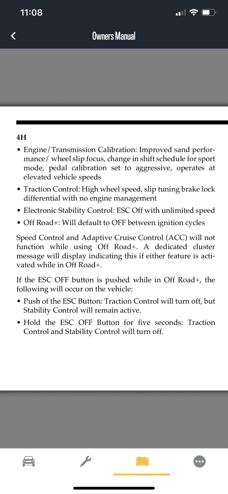

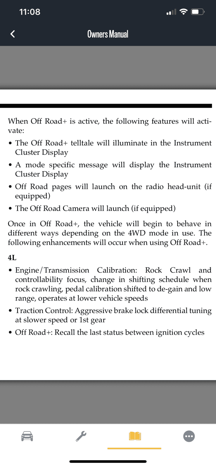

Okay found this online on a gladiator forum...
This makes sense basically says it is infact the BLD system modulating the brakes. I will have to dig into my Wrangler manual to see if there's any difference between the gladiator or not but it sounds about right.

It's normal just the brake lock differential working. Essentially an ABS system that helps you offroad sadly it is always active but it actually works pretty good at least.

The noise should go away if you lock both diffs. That will confirm it is BLD activating.
